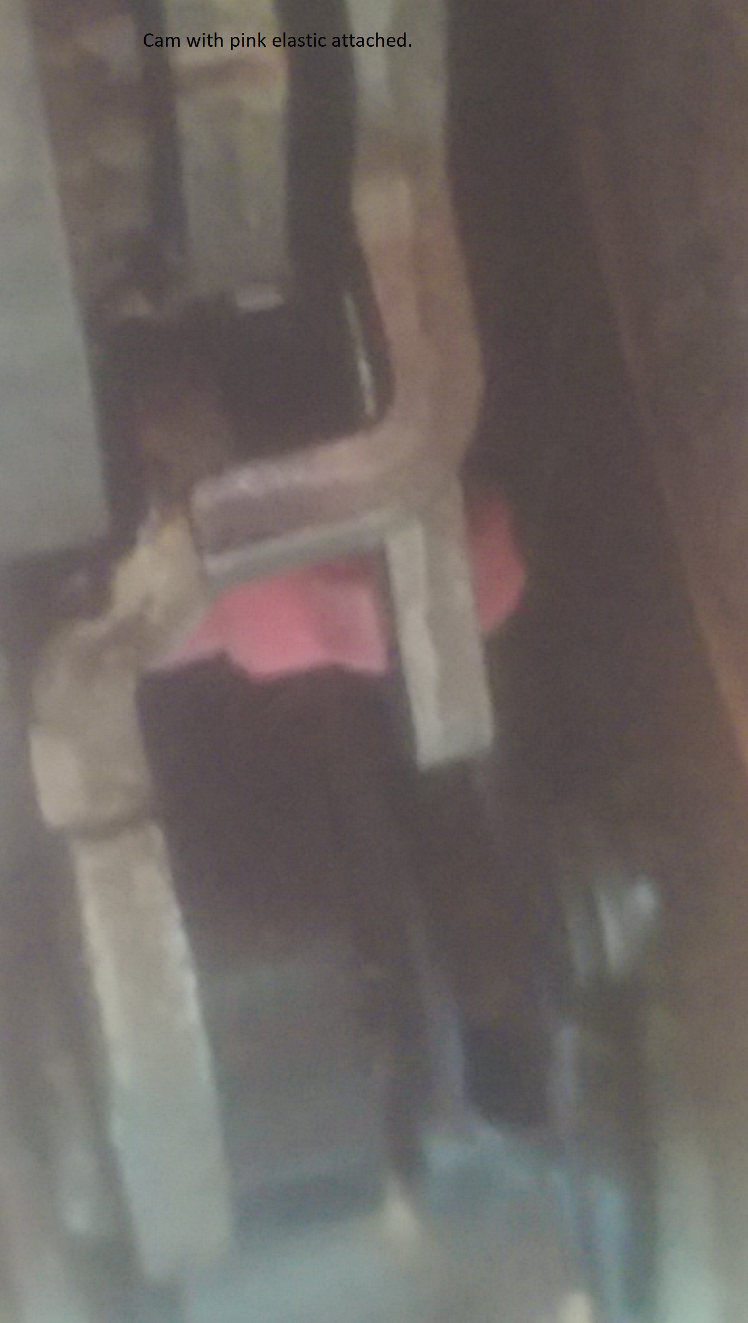

Reach up from the back side near the seat hinge and feel for a cam flopping around. The cam control a micro switch that tells the control module when the seat back is tilted or not. The cam is spring loaded and one attachment is plastic. When the plastic attachment breaks the the micro switch is in tilted mode all the time and seat controls are disabled.
This is a common on the P80 seats. Once you figure out how it works, the fix is easy. I substitute Elastic Hair Bands for the spring to correct the problem. Feed the Elastic Hair Band through the hole on the cam, on the front side of the seat post there is a square hook to hold the other end of the Elastic Hair Band. Five minute fix after you know where to attach the Elastic Hair Band.

I just looked and felt around for the switch/Cam around the hinge area. I did not see or feel anything. I don’t think my s70 has one. Am I just missing it?
