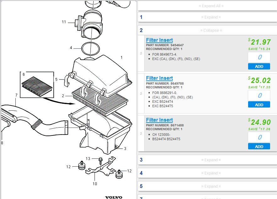

That site doesn't help me much actually. Despite typing in my vin and selecting all the model info they appear to list three different engine filters and I don't understand what the difference it. There are no results for 'cabin filter' and the only other filter they list for this car is a 'carbon filter' that doesn't appear to match what I took out.

The top filter is for all cars except CANADA and Scandinavian markets.
The second is for those sexy Swedes
The last looks like it is for the B5255T4/5 turbo engines
Search for ,pollen filter, or use the part numbers in the link above.
