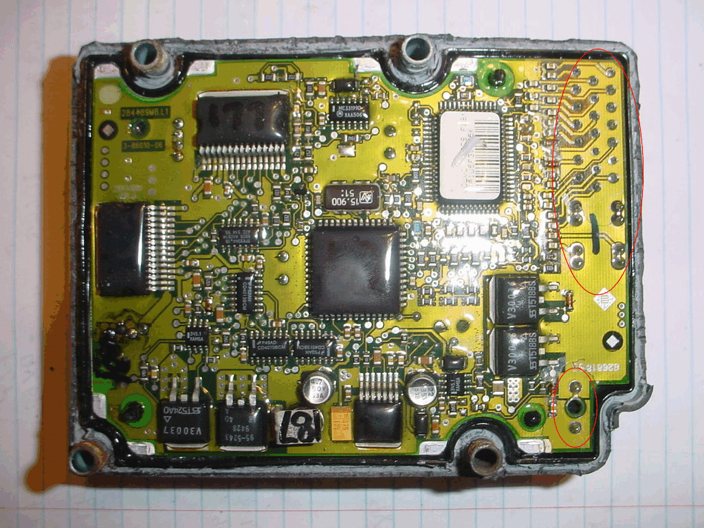

Bit of an update...
Still waiting for the ODBII dongle but in the mean time I opened the ABS unit and went through the joints, everything looked pretty good anyways and that silicon layer on the PCB done a good job with protecting the soldering joints from corrosion...
But anyways after going through all the joints and resoldering them all I put PCB clear coat on them and sealed up the unit ...Its been 3 days and so far the ABS and TRACS light have not come back on ...
So not sure if my soldering helped or it repluging the main plug in the ABS unit after installing it back did the trick ...

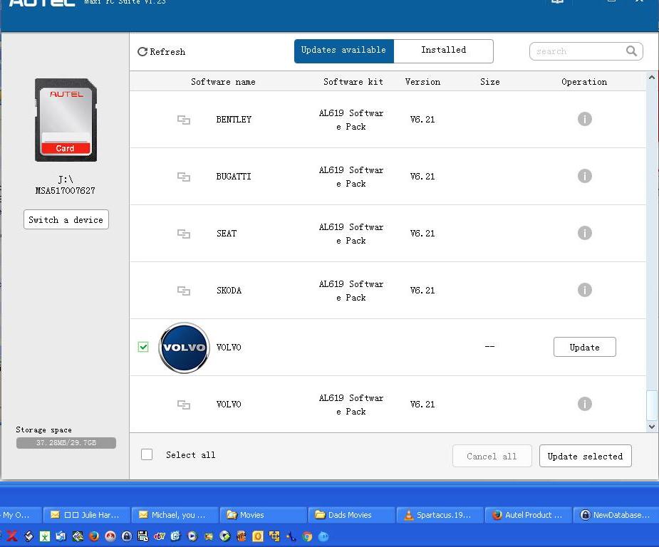

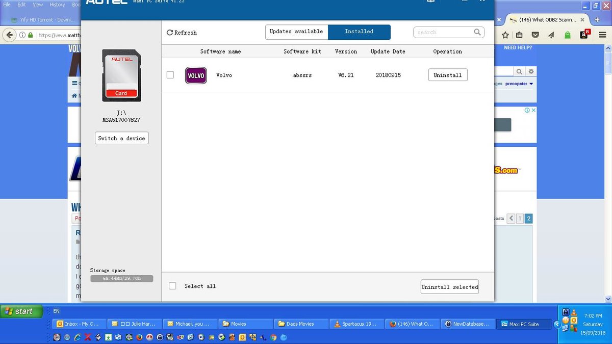

Just received my AL-619 a week ago. Straight from the box it didn't connect to SRS or ABS. It couldn't read the car's VIN either. Then I finally registered the tool and downloaded the updated Volvo files as well as a few other relevant (to me) manufacturers.
Updating the tool requires a mini SD card reader plugged into a USB port on a PC. After you choose the updates you then insert the mini SD card into the AL-619s port and go and scan your car. It's a little more complicated in reality than what I just stated as you need to install the Autel Suite which communicates and authenticates your tool via USB and this is key to obtaining the updates. Also an Autel account must be registered and your tool authenticated by serial number.

I shot a video after the update and I was surprised at how quick the unit was in ABS/SRS mode. I read the car's VIN pretty quickly and proceeded to read off my car's current ABS errors. It was good to see that they were the same as those reported by Vida.
