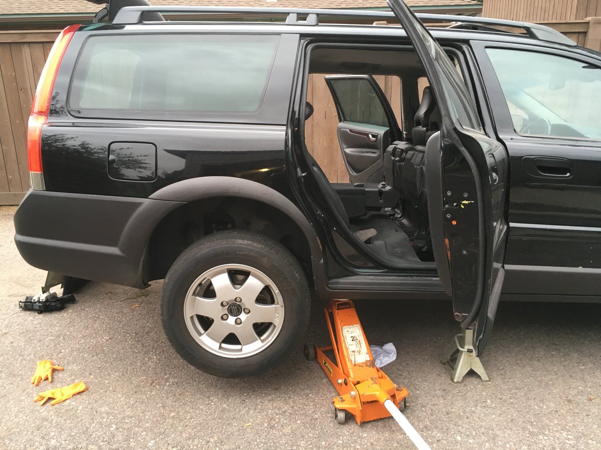

Disassembly and inspection.........well, shit. So much for the road trip.

Bart...be careful routing those hoses in that XC tank. It’s easyto kink them and then you gets really brutal intermittent fuel delivery problem
