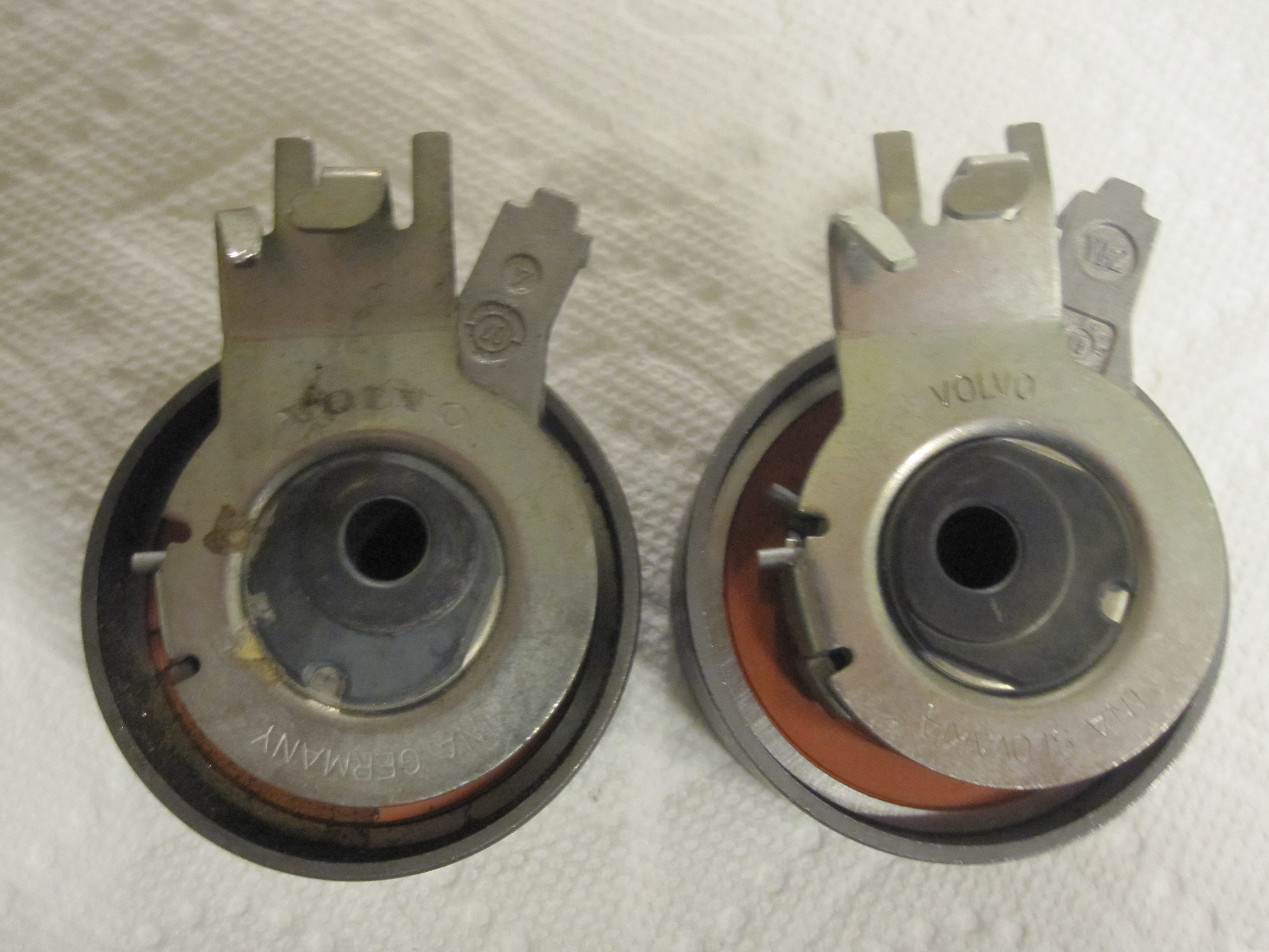

Mine is also an INA as part of an IPD kit, and it's *supposed* to be Volvo OEM. The kit came in a Volvo blue box. One interesting thing I noticed is how the Volvo logo looks so generic on the new INA, compared to the previous one that was on there. Also, the new one was made in Slovakia, versus the previous one that was made in Germany. Don't know how much it matters, just something I noticed.
I'll try the new one IPD is going to send me. If it doesn't work out, perhaps I should call the local Volvo dealer and see what they say, and try getting the part from them.

The eccentric on the two tensioner sin that picture are completely different positions, almost 90 degrees offset.
I think that's a factor?

The eccentrics are different because they are just set differently. When off the car, you can put in a hex key and freely spin those around.
- Posts: 36145
I thought the eccentric hole keeps a fixed position with respect to either the fingers or the indicator?

Nope, they spin freely. You can see Don doing it at 7:27.
