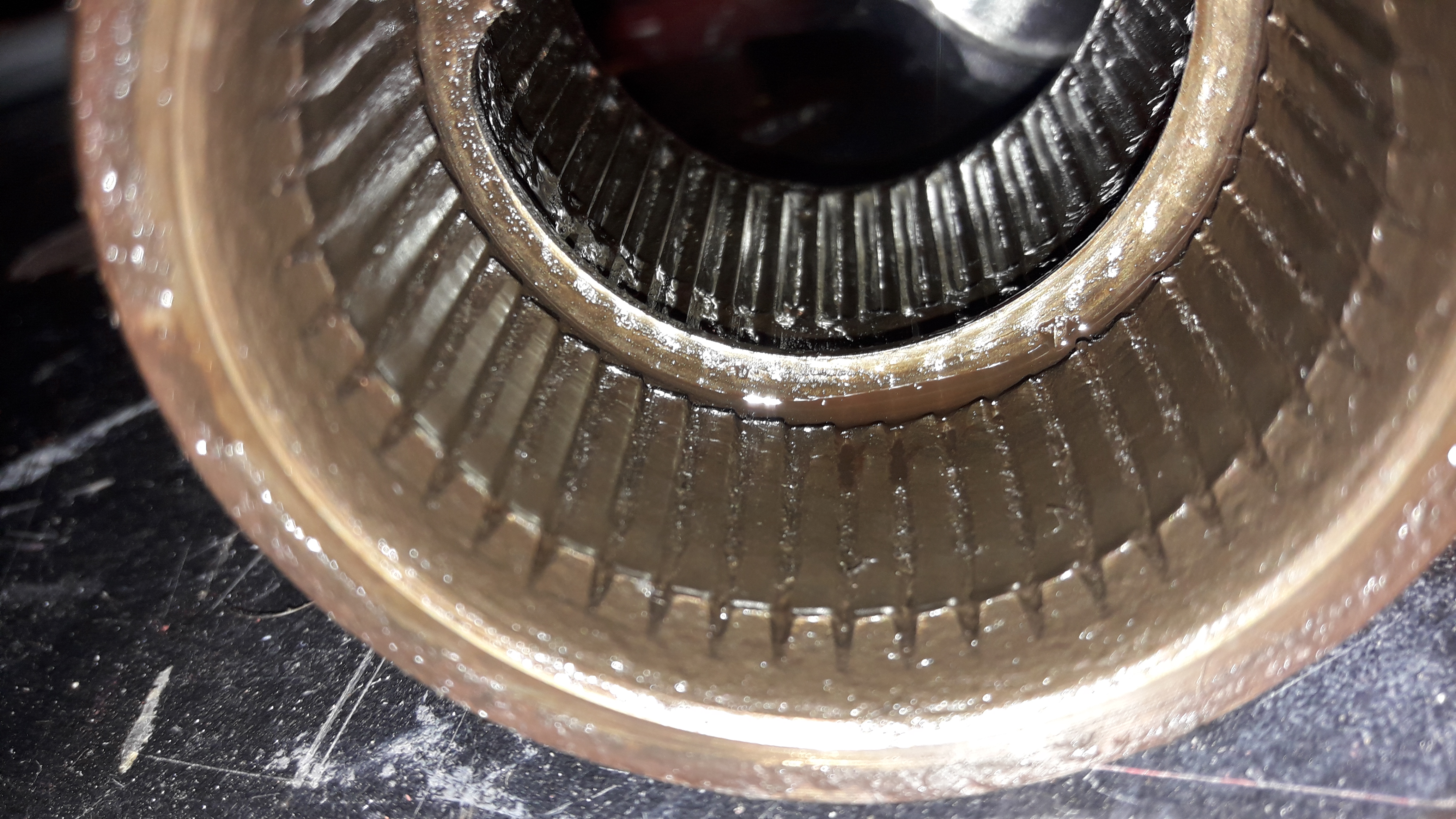

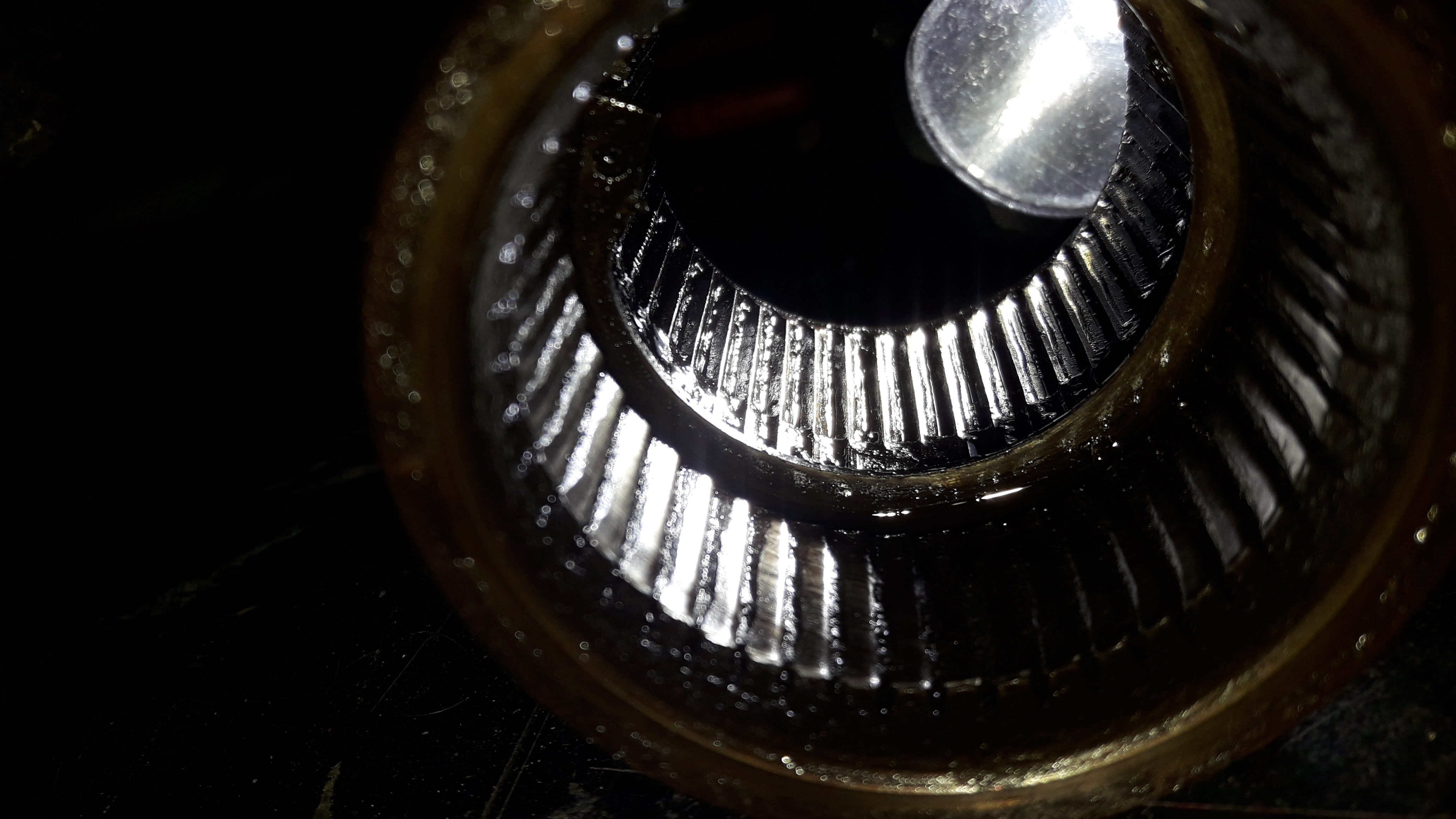

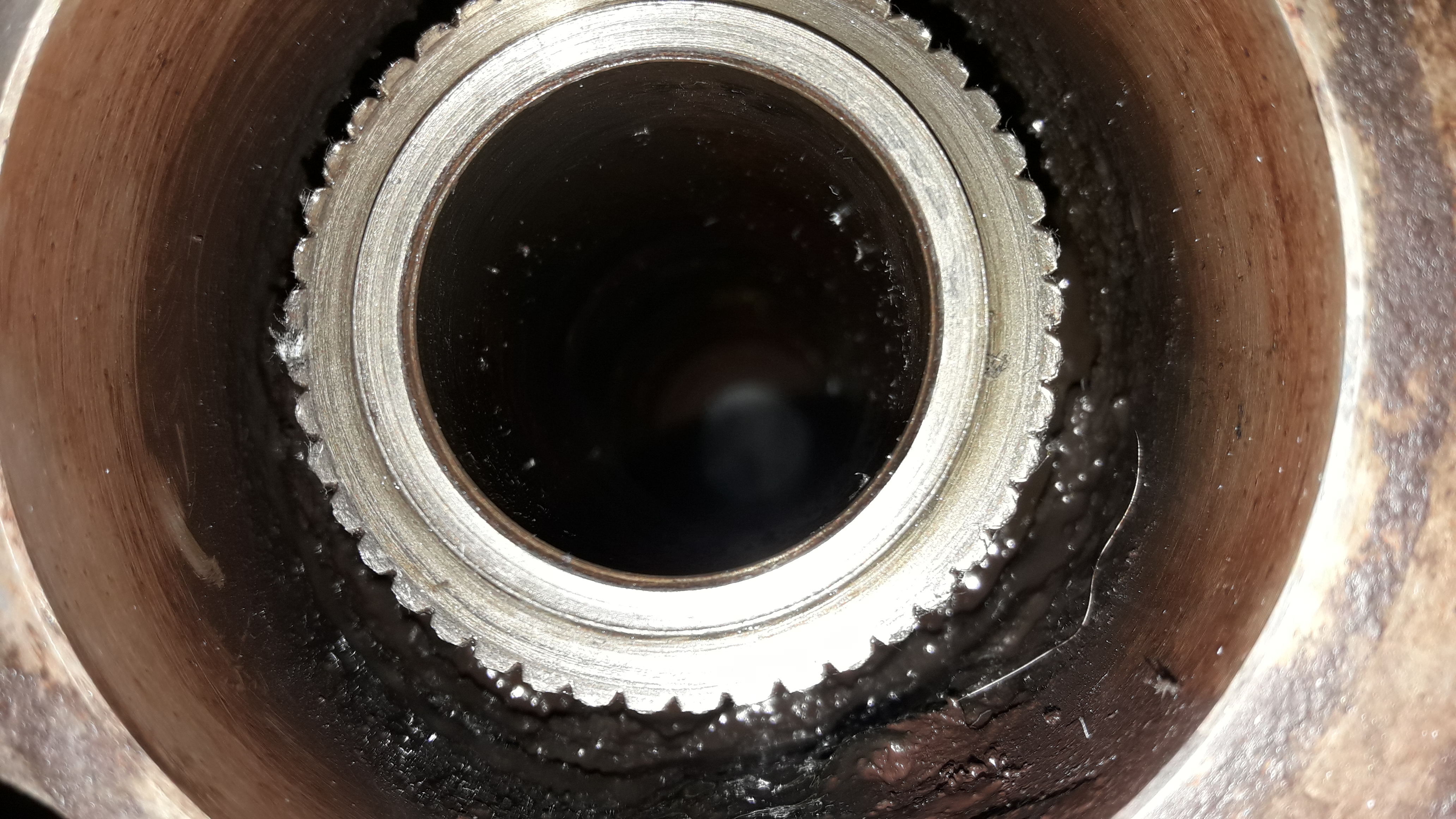

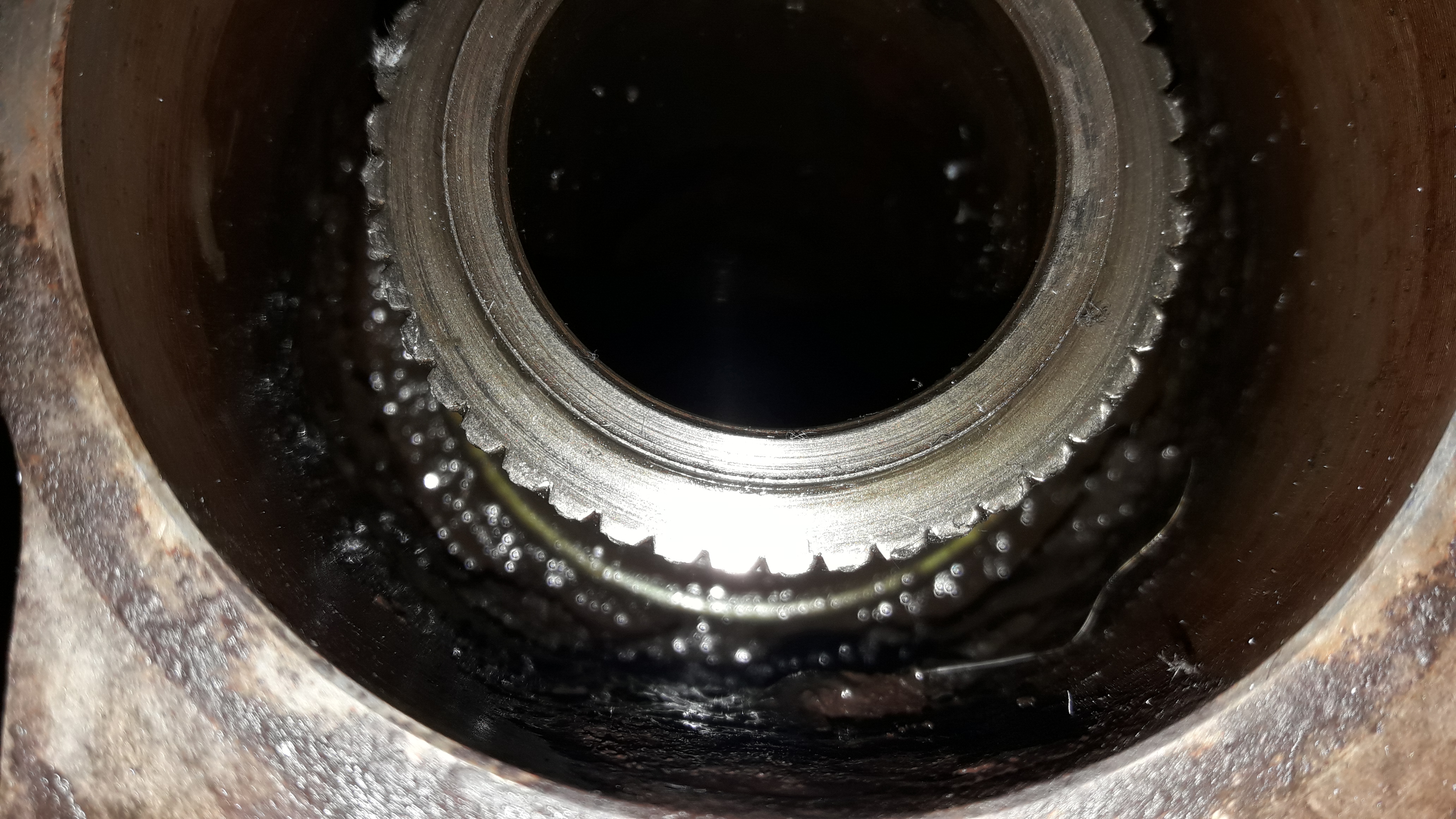

So, bad news: The angle gear was delivered today and when I tried turning both shafts by hand, the sleeve/collar already slipped when applying very little force.
It would grip a little bit when pulling the collar out a few cm, it seems that the outer end of the spline in the collar was least damaged.
I took the collar off since that has to be replaced anyway and am now mostly concerned about whether the spline on the axle in the angle gear itself is good enough to use (if I would get a new sleeve).
The last thing I wanna do is rip the angle gear off, put this one in, and do it all over again because it immediately starts to slip. I've had this happen with my current angle gear and the indy has plug welded up the collar, so if I would have to choose I could prefer the current bearing whine over a slipping collar.
Anyone care to help me judge this based on these pictures? Summarized: I know that I would need a new sleeve, but are the splines on the angle gear still fit for purpose? I'd like to know before investing more € (sleeve) and time in this angle gear.
Any measurements I can do?
Thank you!
Joost

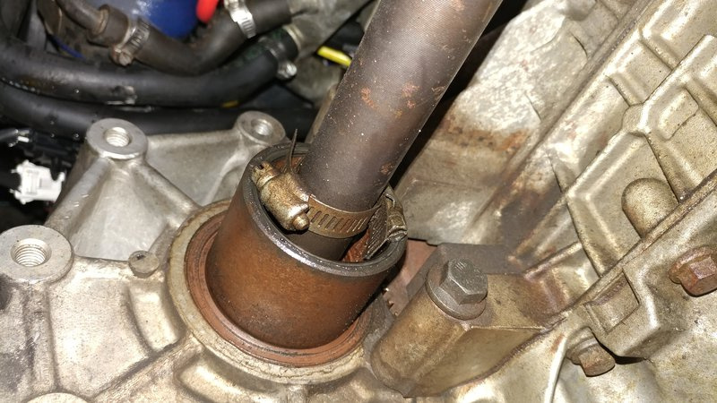

My car has been running as a FWD for about 40.000km now; I have entirely deleted the angle gear last year.
As I wrote in my last post (Mon Feb 04, 2019 5:54 pm); I had accidentally bought and refurbished a non-fitting angle gear. I managed to sell it to another Volvo enthousiast. I didn't succeed in finding a good, low mileage used one for my '99 so decided to delete the entire angle gear as per ECBSykes procedure. This doesn't look nice but has worked well for me over the last 40k kilometers.
ecbsykes wrote: 21 Jan 2017, 06:08
scot850 wrote:If you need to use the car, you could in the short term do what ecbsykes suggested and I know others have also done.
You may need to PM ecbsykes to find exactly what he did, but basically owners have removed the RH axle (which runs through the angle gear housing), then removed the angle gear unit then glued the sleeve back into the transmission and re-fitted the RH axle and driven it in FWD only.
Actually, I just took two hose clamps and fitted them through each other to prevent the sleeve from moving. Looks ghetto, but works well and haven't had any real leaks, maybe just a very tiny bit of weeping. There's no real way to glue to sleeve in there as far as I know. It was designed to be held in place by the angle gear, so you really need something physical to push against its desire to move out of the axle seal.
Added benefit of doing this: makes working on the XC sooooo much easier. Reaching the turbo, air intake, and all vacuum/coolant hoses in the area is simple now.
