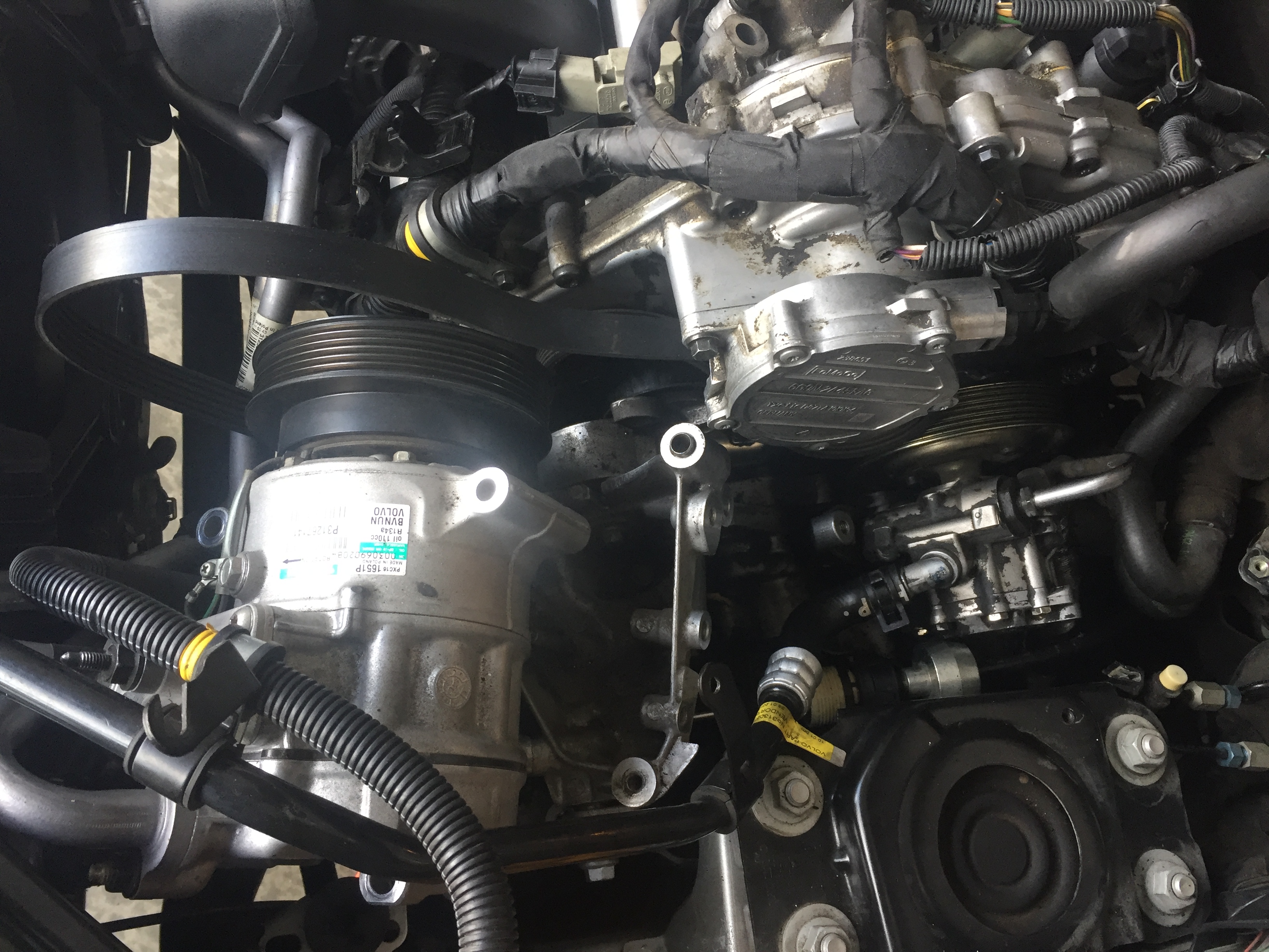

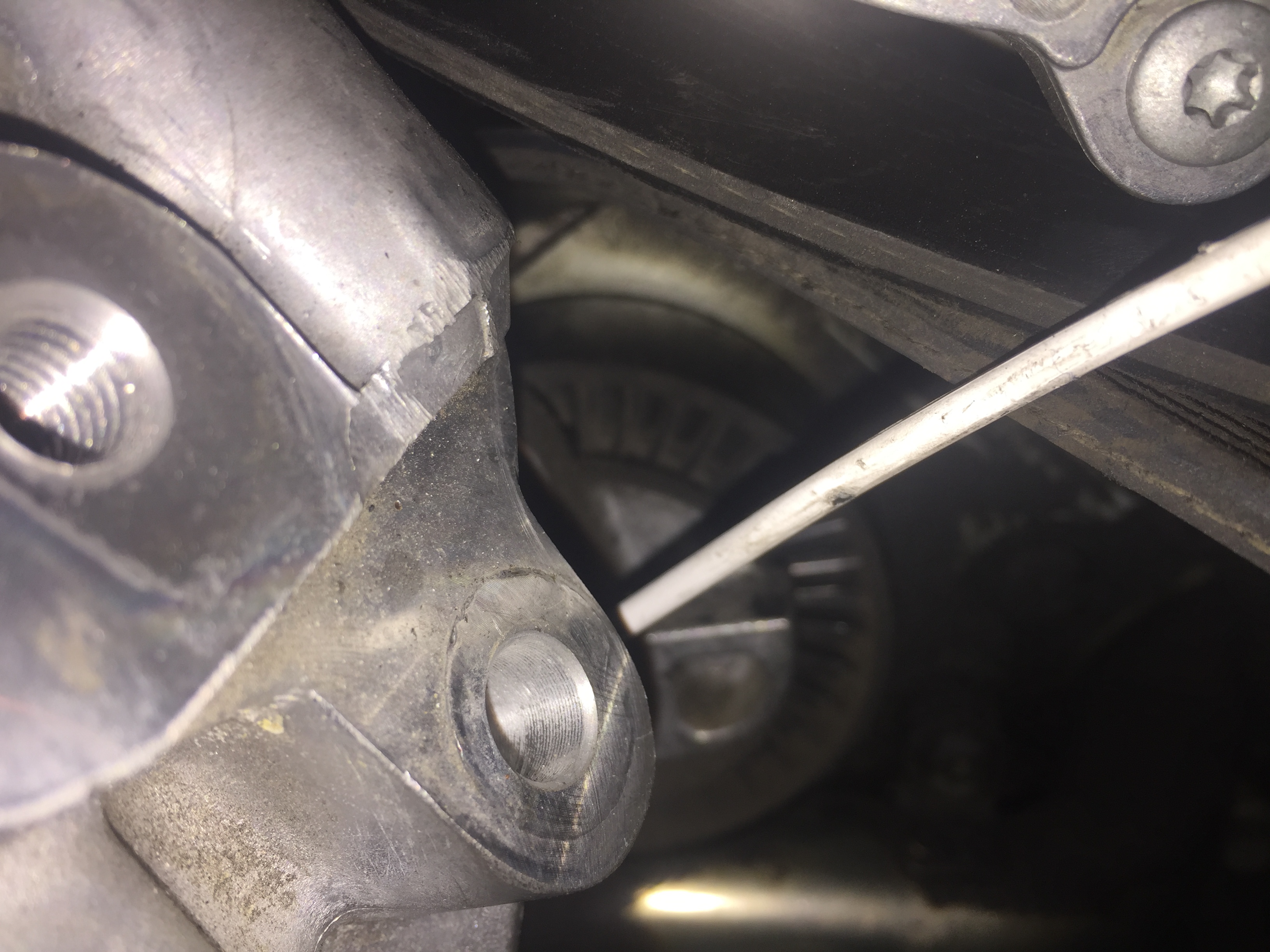

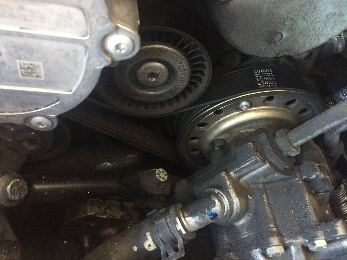

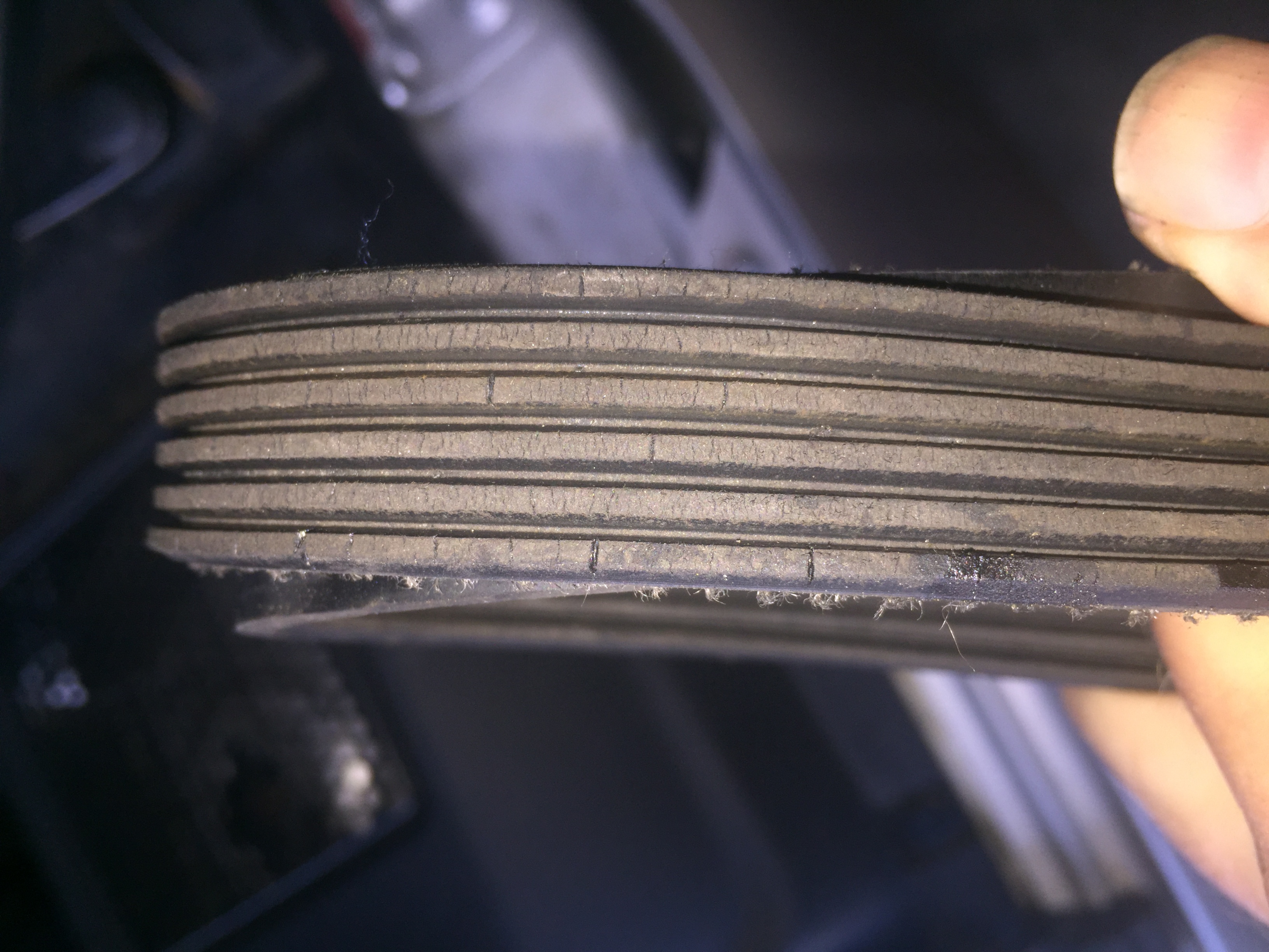

I replaced the Auxiliary Belt, and two pulleys
Note: the pulley for the tensioner is the same pulley used for the idler, I didn't replace the tensioner because it was working fine.

Good Stuff Paul!pgill wrote: 31 Dec 2018, 23:09
What's expected of rebuild tensioner now that ONLY its pulley is restored?
Happy New Year!
- pgill
- Posts: 813
- Joined: 27 Aug 2018, 17:42
- Year and Model: 2010 S80, 2008 LR2
- Location: California
- Has thanked: 120 times
- Been thanked: 189 times
xHeart,
Thanks for the comment
I will post here if the tensioner fails.
For my LR2 I replaced the entire tensioner and I still have the old one (it worked fine)
If I have to I will swap out the tensioners.
My suspicion is that the overdrive pulley will fail first.
If I am lucky both the tensioner and the pulley will last the 10 years.
AUX overdrive pulley
31316803 Volvo part number
LR005993 Land Rover part number
We will see
Take care
Paul

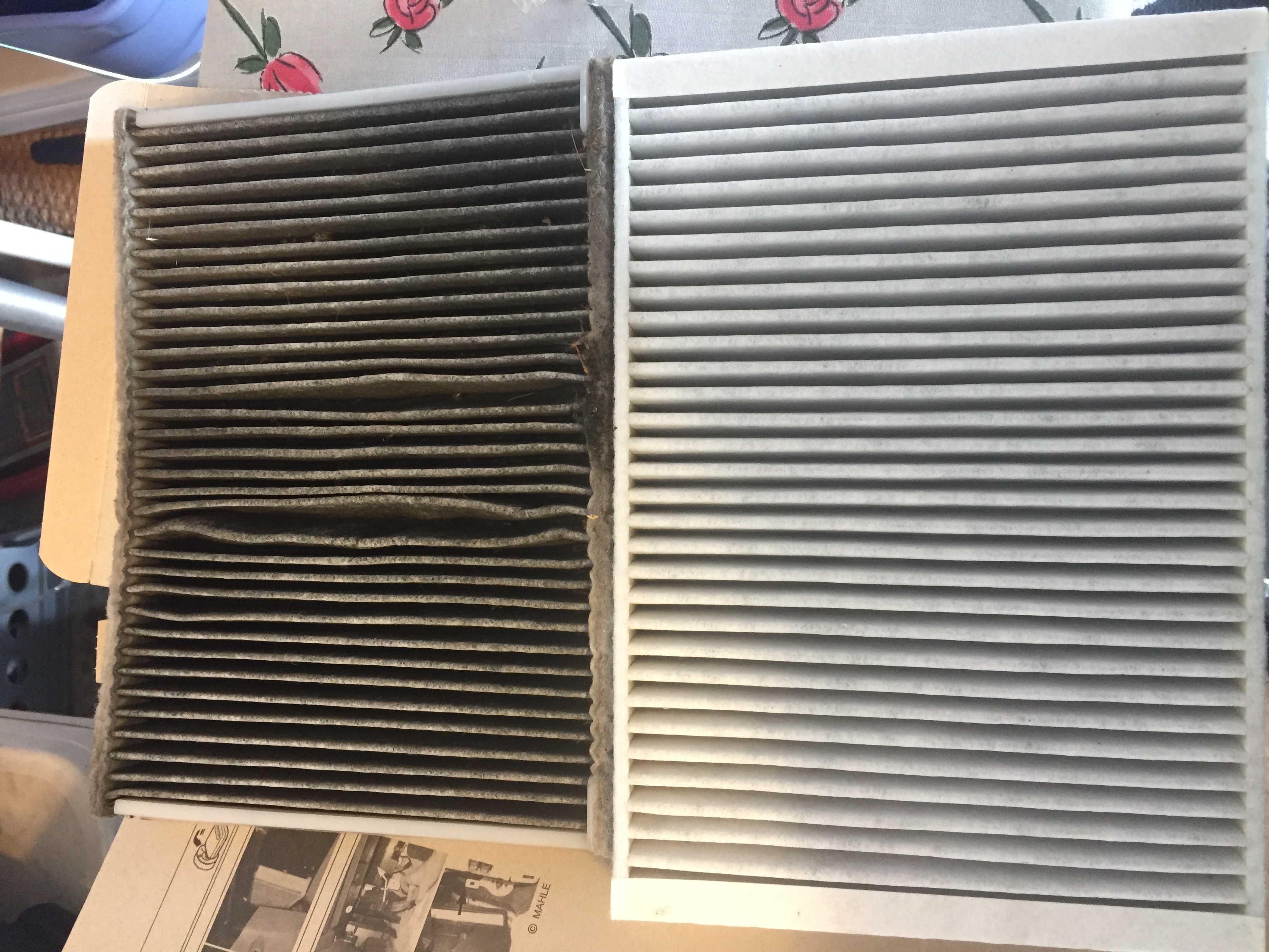

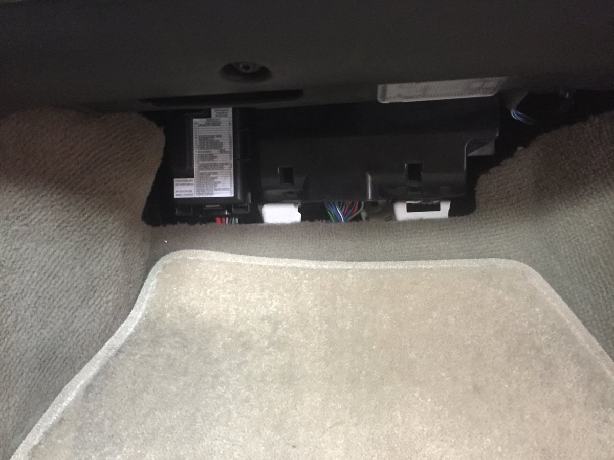

Time for the next maintenance item.
Cabin Air filter
This Video explains how to do it (not my Video but I did use it for reference)
Note: I didn't remove the Glove Box and I didn't clean the condenser.
Some pictures

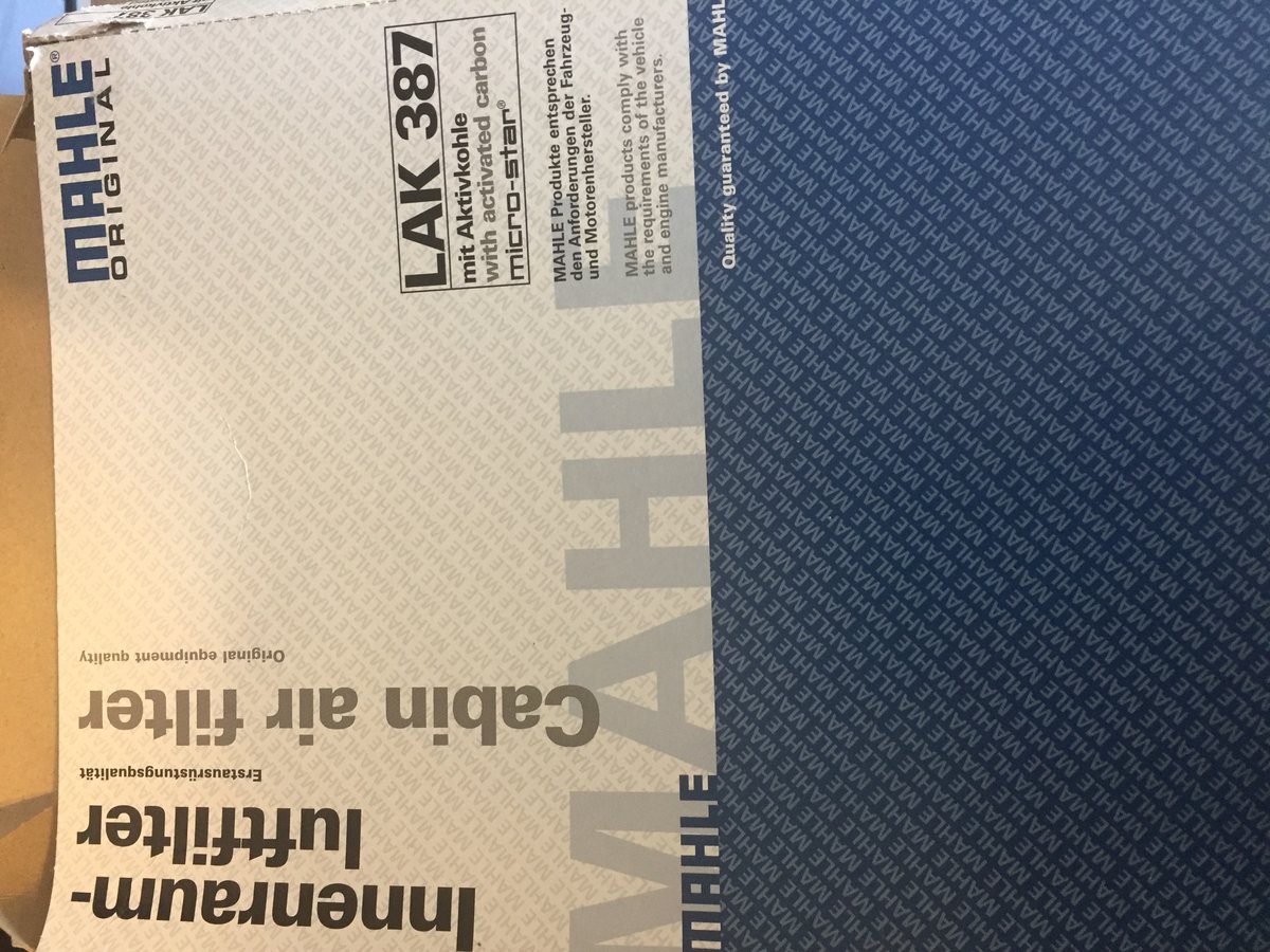

Volvo Cabin Air Filter (S60 XC60 V70 XC70 S80) - Mahle 31390880 $20.95
The new filter looks a little longer then the old filter but it fit fine.
I may have compressed the old filter when I removed it in the confined space under the glove-box (Maybe next time I will remove the glove-box)
I will add up the total cost in a future post
Take care
Paul

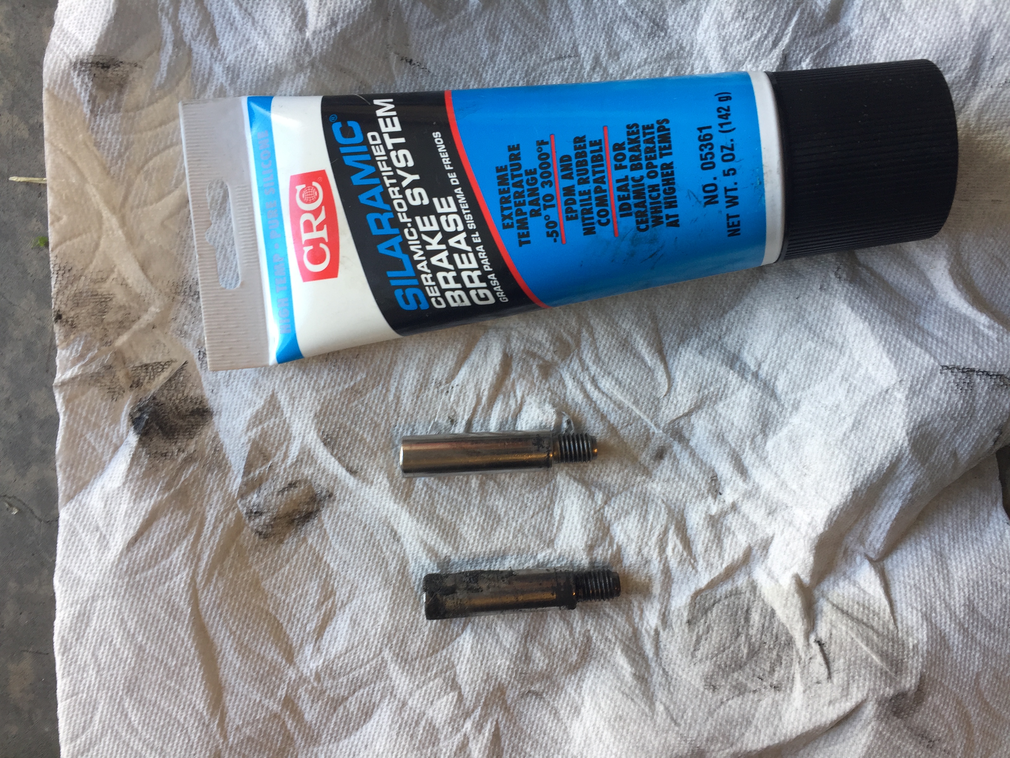

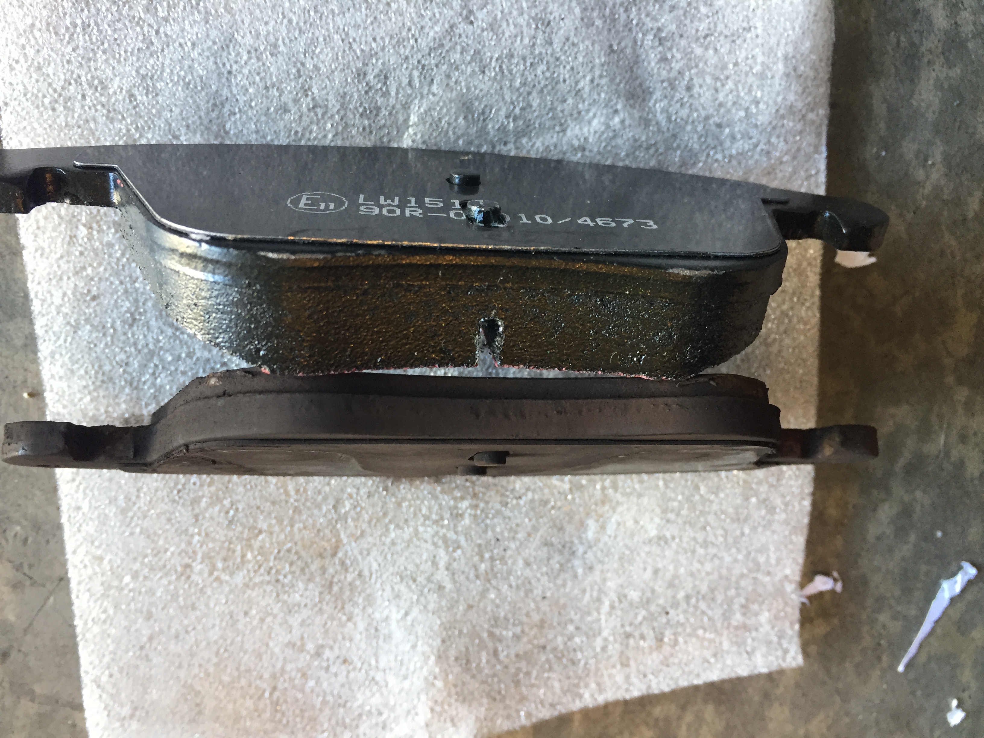

MVS Readers,
I recently replaced the front brake pads on my S80
Here is a picture of the slide pins for the caliper (one cleaned and one before cleaning) and the grease I like to use
And here is a picture of the old pads next to the new pads
And here are the pads that I used
It has been a few weeks since I changed the pads and I can say that I like the EBC Ultimax 2 pads a lot.
The Friction is excellent from first application and the modulation is beyond my expectations.
These Pads are extremely quite.
This is an excellent street Pad for average driving.
If you are looking for a very aggressive Brake Pad then I recommend that you consider the EBC Red pads instead.
I really like the EBC Pads because they have a break-in coating on the surface that will remove the old friction material that was transferred to the rotor from the previous pads.
