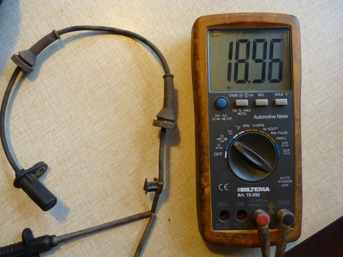

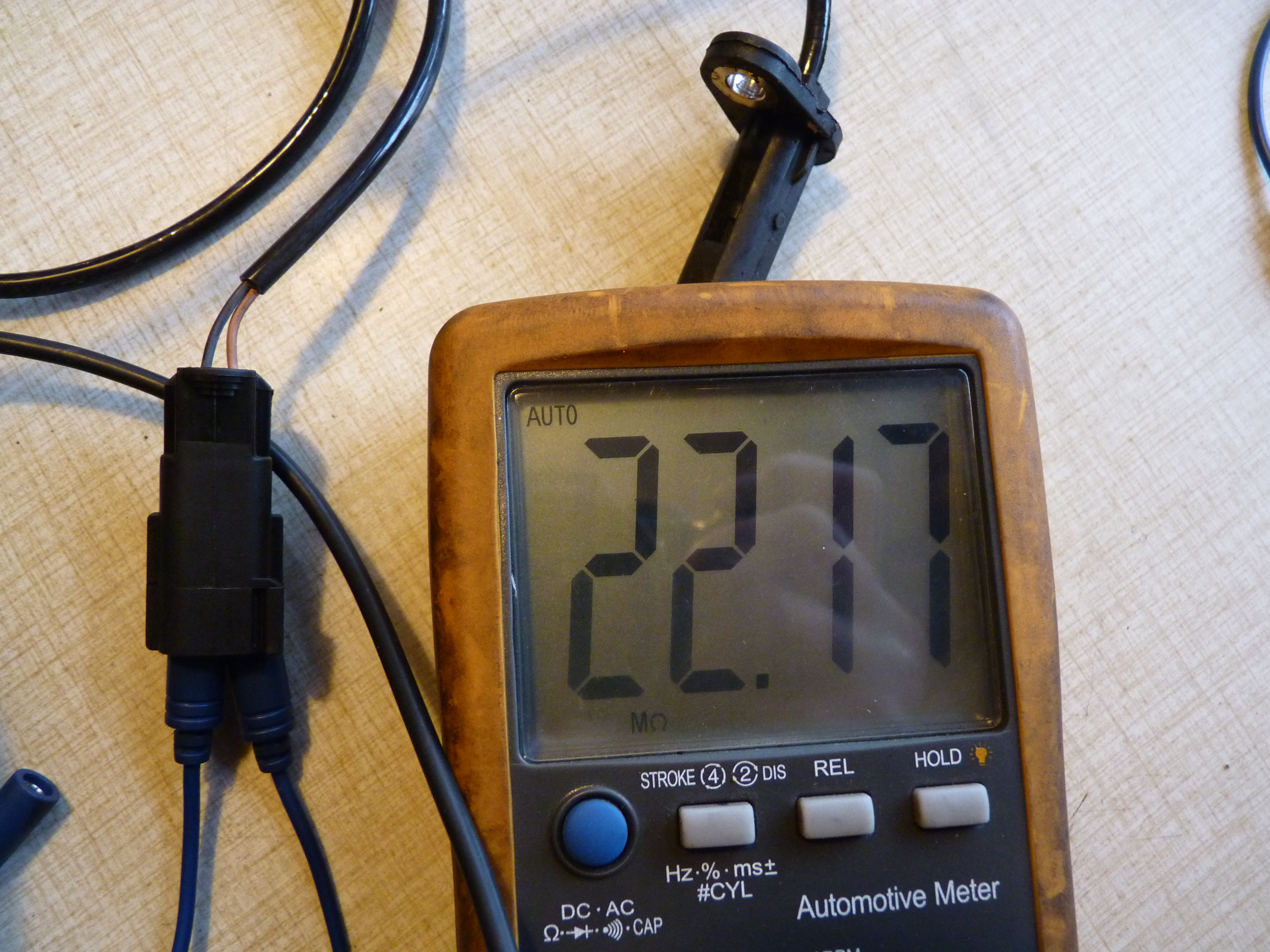

Yes - unplugged - both left and right.wizechatmgr wrote: 09 Feb 2019, 17:59 I am unsure the desired value of the ABS sensors over the harness but I'm rather sure you have a problem there. Shouldn't be in the mega ohms range. Shouldn't be more than maybe a couple more ohms than the sensors themselves are total.
These were checked with ABS module unplugged, correct?
And with a correct cabel connector (I have a whole kit with connectors so they fit properly).
He bought a new one for a later model - and when we found that out - we bought the correct sensor.
But they are both the same, it showed.
He changed the original sensor without testing it first, unfortunatelly, so here are the measurements for those two, at my kitchen table (litte wormer than out and the original cut out from the car):

Unless something is wrong with your multimeter, I believe both original sensors you just tested are bad and possibly the replacements.
I wonder if Matty Moo (Midwest ABS) can verify the sensor resistance here for your particular vehicle from what he's seen. I believe it to typically be ~900-1300 ohms.
