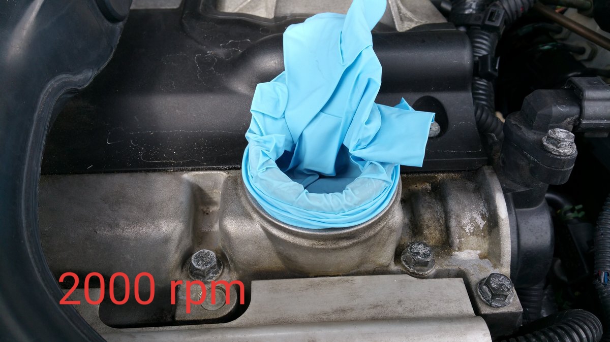

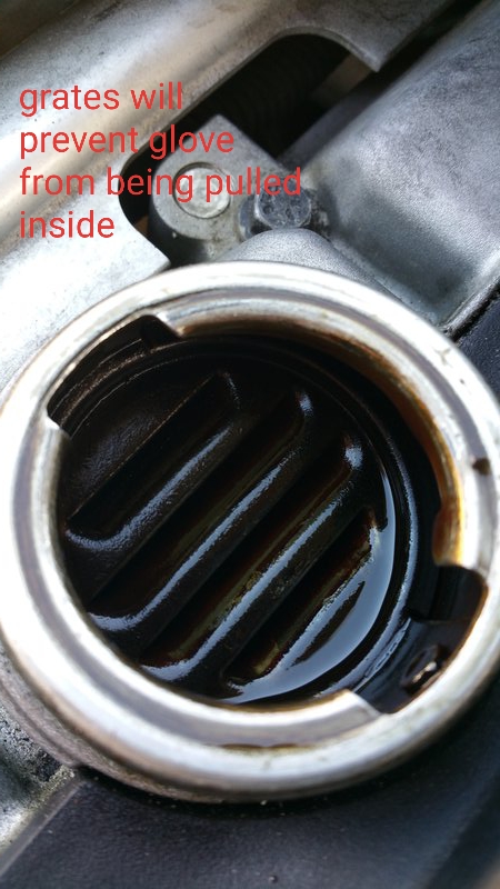

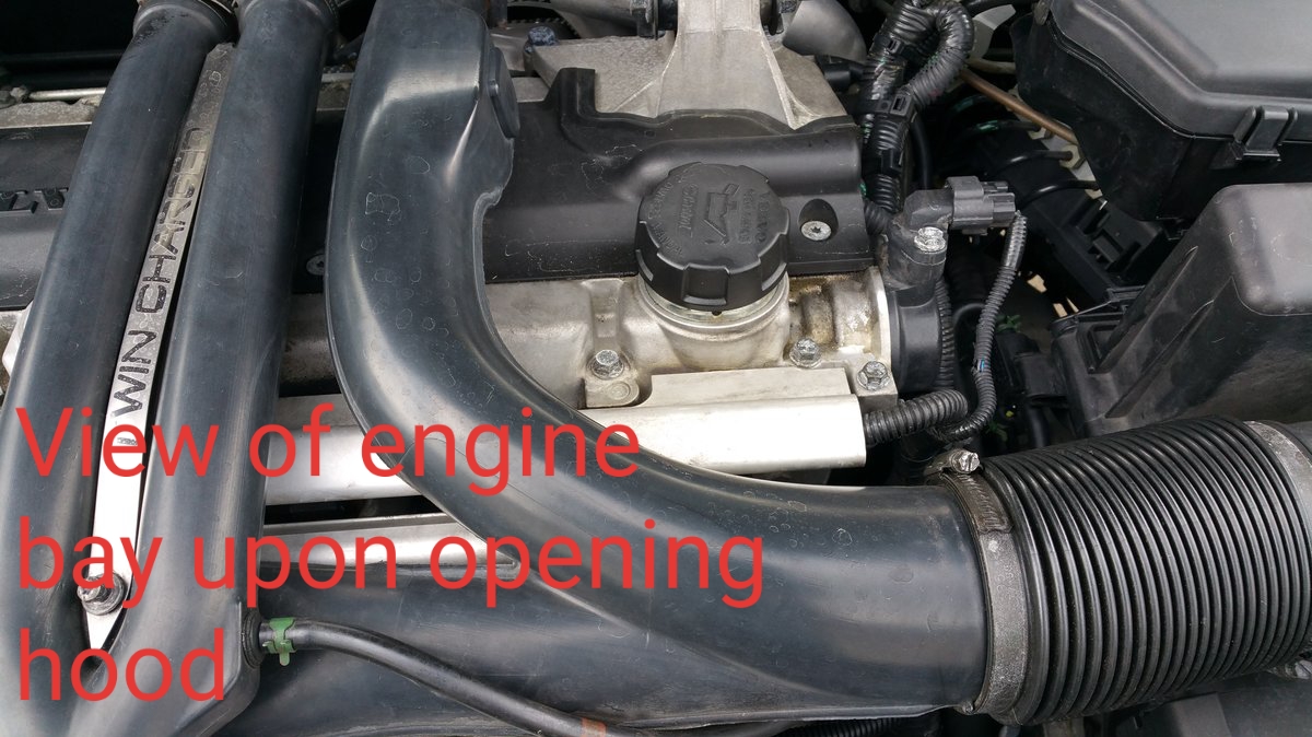

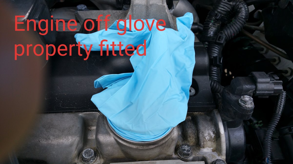

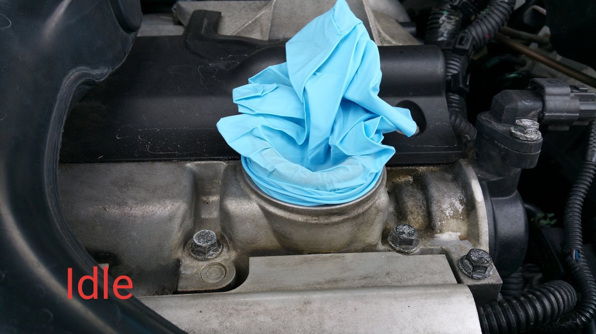

Here is a pictorial of a good working PCV checked via the glove test. This is my 2004 S80 T6, the 5cyl has the same oil spout and cap. I hope this helps! June

Get your tires and control arm serviced, make sure timing belt replacement has been done, and use June's suggestion on glove test to check your PCV system. After that you will get some great info here.

Thanks, June, for people who have not been reading this site for a while, a reference to a 'glove test' is not enough. Your description was great.

Yes it has PCV and to test it you can do a glove test. Take off the oil cap and attach a latex exam glove over the hole. Start engine and the glove should suck in. Then rev engine to 2000 rpm and the glove should stay sucked in. If it inflates at idle or 2000 rpm your PCV is in need of replacement.

Also look on Youtube for the PCV test such as this one. The glove must be tight (no need to do on a hot engine) and must suck in quite strongly (keep it with your fingers if there is no grid on the oil hole) www.youtube.com/watch?v=gD2OOSl1tIM
