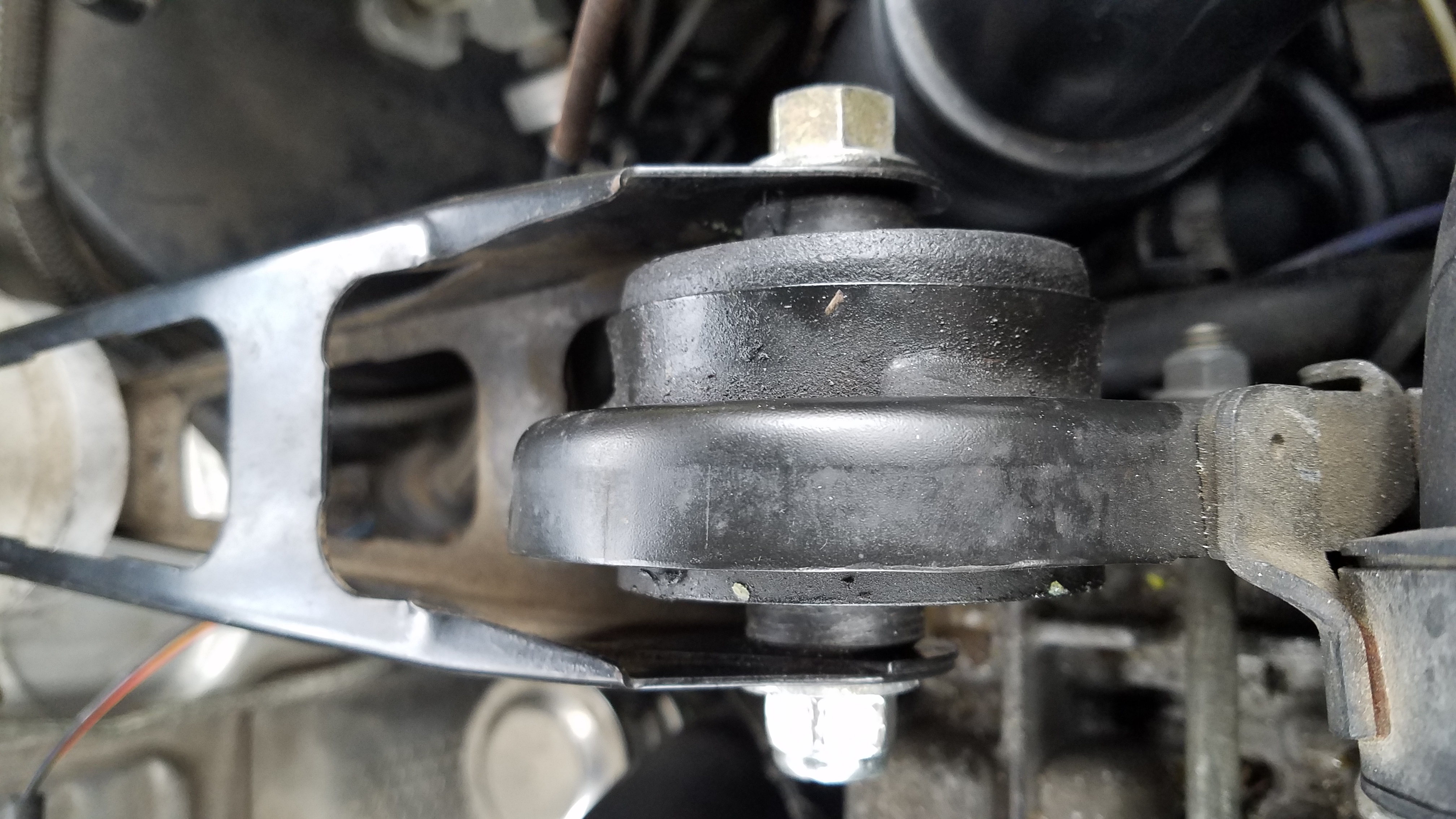

Finally got a picture of what I was describing above...
As you can see, the bushing is not completely centered. The left side is flush with the holder, and the right side is not fully seated. I could get a spacer for the left side and push it a bit more to center it up, but is that really necessary?
- Posts: 35293
- Has thanked: 1503 times
- Been thanked: 3817 times
Put a sharpie mark on it and watch it for movement, but I would run that.
