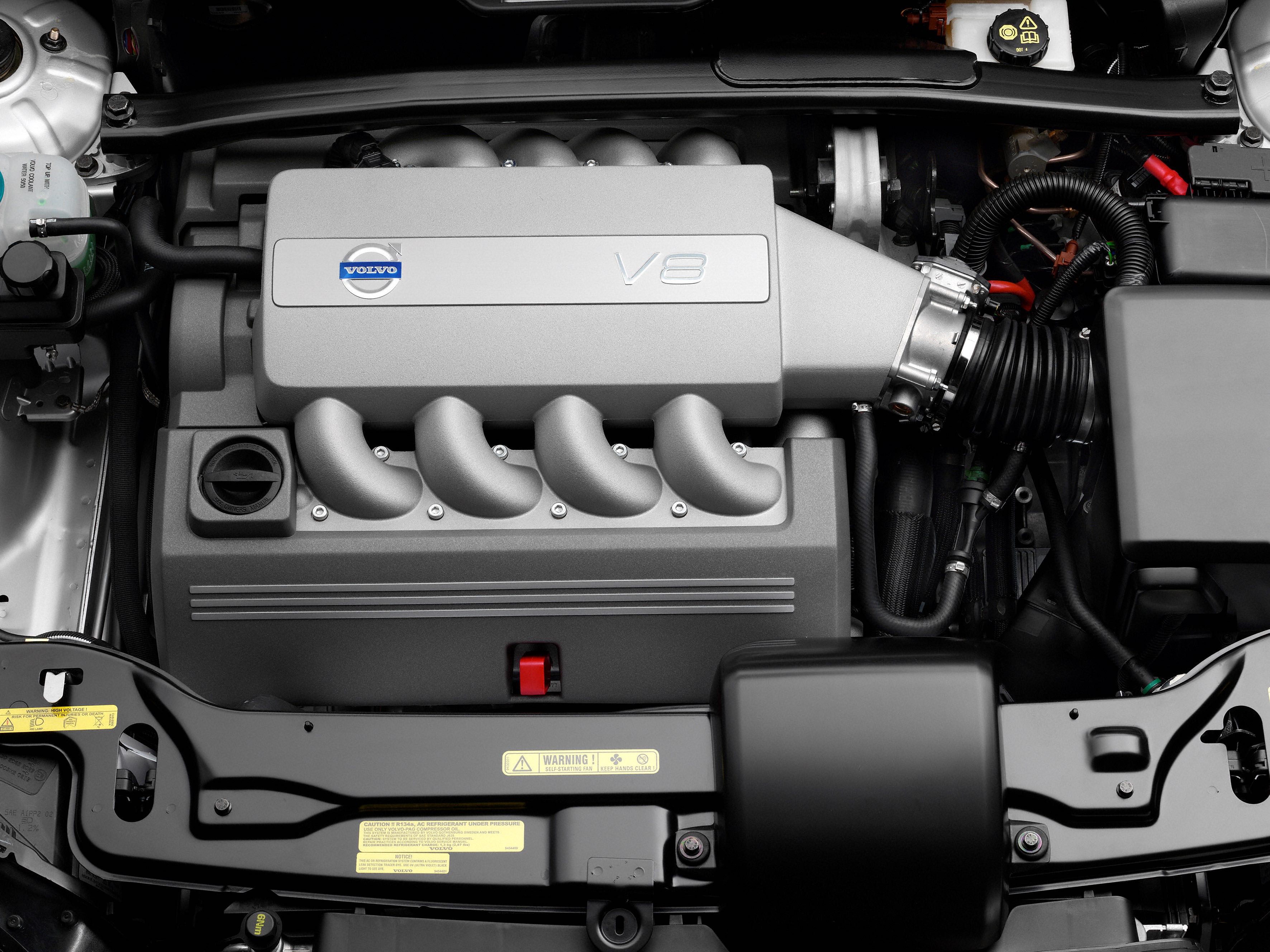

A V8 will have a "V8" on the engine cover, and a small badge on the grille, and rear:

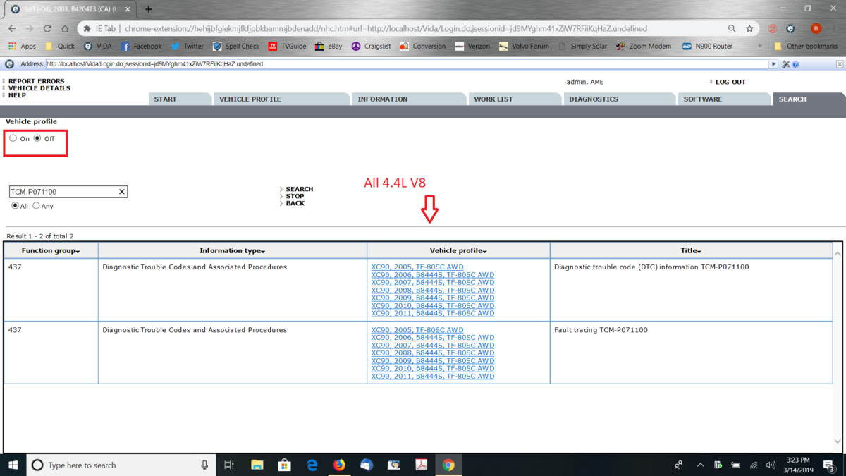

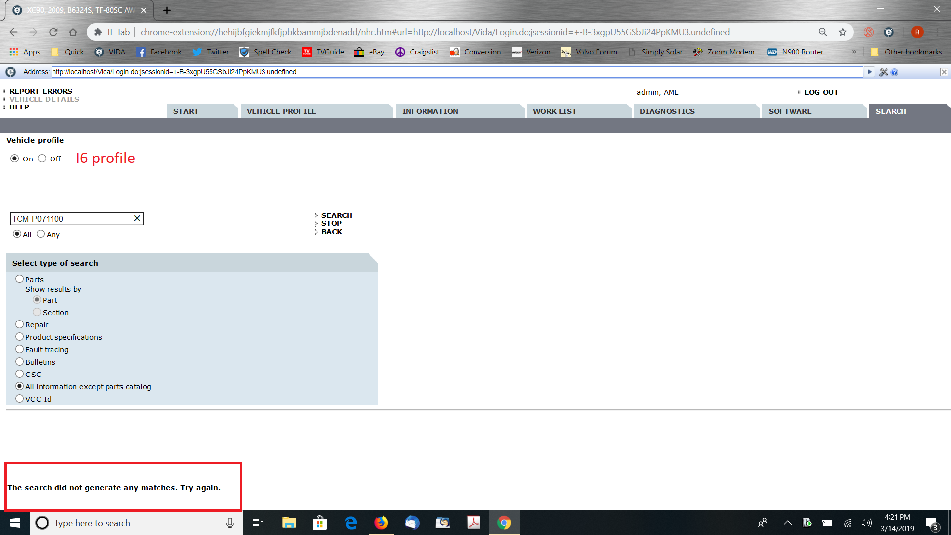

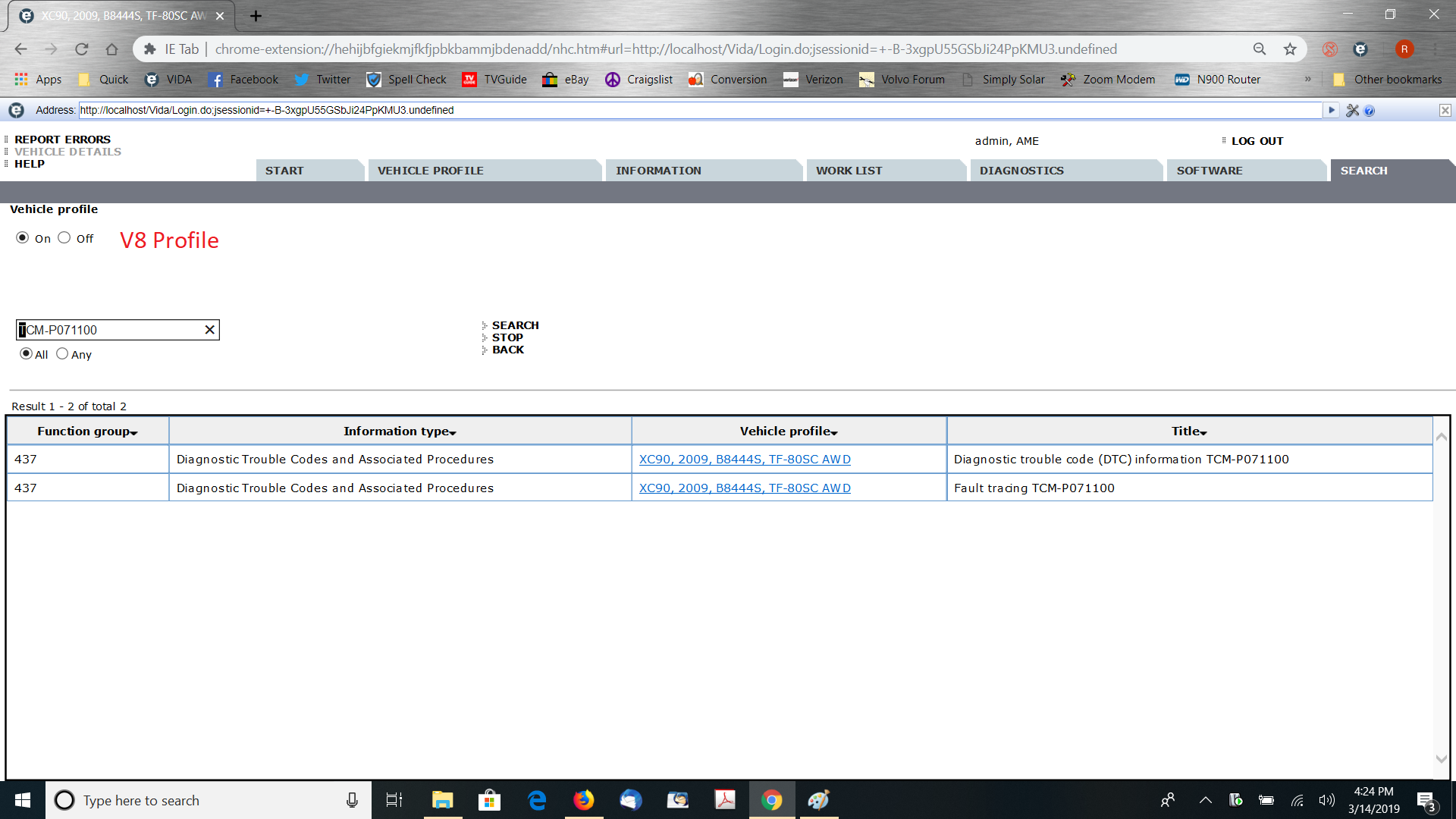

I was hoping he would get a second scan that would provide data that would enable me to ferret this out.precopster wrote: ↑13 Mar 2019, 16:15 That's odd because both models share the same TF-80SC transmission. Sounds more like a Vida reference glitch.
Observe:

If vehicle profile is turned on and you select vehicle type THEN search does it give the same result?

If the profile is a I6 and on, I'll get a empty search resultsprecopster wrote: ↑14 Mar 2019, 15:07 If vehicle profile is turned on and you select vehicle type THEN search does it give the same result?
If the profile is a V8 and on, I'll get search results.
