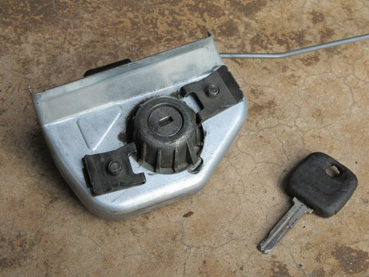

If you want to take it one step further, a P2 with the third seat will often also have a lock cylinder installed in the tail gate. That will allow it to be manually unlocked from the outside. The trick is finding one at the scrapyard that still has a key. The keys are usually nowhere to be found.
Idle hands are the devil's playground.
