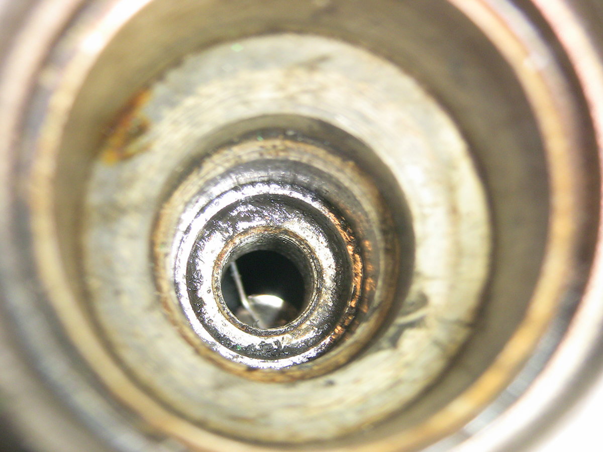

wow! sorry to doubt you. Ive never seen that. are they volvo plugs? I see Germany on them, but dont recognize the clunky tractor electrodes. only the 1/2 turn loose are damaged? did it actually run like this? may be you have made a discovery that electrodes are not necessary. you will be rich. I dont understand why they would be missing and why loose would play a part in that. better hope the answer is consumed by spark searching for a ground, but doubt that. I would think 1 2 and 4 cylinders are scored. You could see if 3 and 5 are higher compression. lucky that mechanic is not working on helicopters ( I often observe that about my self)

so I just looked up electrode loss and the high frequency vibration of loose spark plugs will cause that. also detonation on highly boosted engines which would not be your case. the result is ruined piston, rings and bore. might be time to call a lawyer.

Strong argument against leaky valve stem seals.imaV70Rdriver wrote: 06 Apr 2019, 17:02 erikv11; No smoke at all, on cold startup after sitting overnight. ...
Sadly this is looking like ruined piston rings. As mentioned, definitely do a compression test.

tardcart: Volvo 5254T4 spec plugs. Says "VOLVO" and "R6" on the ceramic. It ran for about 3-4 months, until it didn't. Those 1/2 turn, 1/4 turn figures were with a sparkplug socket and extension placed on the plug. I wiggled/turned the socket until it found home on the plug, only to find I could turn the plug. To finger tight, I needed to turn as indicated, then put a socket on it to torque.
Now for the news. I did a compression test today, on a warmed up engine with unpleasant results. Oddly, the trouble doesn't completely correspond with the plug damage. Before anyone asks, I performed the test carefully, ensuring a good seal prior to doing the test on each cylinder. From the front...

All plugs were "white" with very hard "white buildup", cyl 3. being the worst, I needed to chip it off. And brass brushed all plugs before reinstalling.
RHP: No oil in the pipe leading from the turbo to the intercooler, just a light black soot. Didn't check the other due to compression test results.

I used the free tool rental from "autozone" (one of our local parts suppliers), to get a compression tester and borescope. Yesterday I pulled plug 3 because it was easy to get at, and stuck the camera down the hole. Even with the dismal light on full, I really couldn't see any more than the top of the piston. Let's attach the mirror! With no instructions, but looking simple enough, I did so, and again put the camera down the hole. In short order the 10mm x 13mm mirror on it's 2 1/2 inch long iron containing metal rod, along with its plastic retaining clip, had removed themselves from the camera, and settled on the piston. What to do? With some luck, and about an hour and a half of exhausting precision work, I fished the mirror out of cyl 3 with a magnet, and after some effort, abandoned the plastic clip. Funny that cyl 3 was the cylinder where I lost the plastic clip, and it is also the really low psi cyl. Jammed in the valve? Or other? Should I try the mirror again?
Today, to prepare for the compression test, I undid/loosened, the turbo to intercooler over-engine-pipe, and plug coils so I could get at testing quicker. Then started the engine and let it warm up. No gas, just idle. I wanted to keep the turbo cool. When warm, I removed intercooler over-engine-pipe, plug wires, plugs, injector electrical connections, cam position sensor electrical connections, and two ground wires on valve cover. Then I did the compression test, with results above.
After doing the compression test, I thought I'd use the camera with the same mirror to check cyl 1. but this time I'll tape the livin bjesus out of it with electrical tape, eight layers over 2 1/2 inches. Stupid me thinking nothing could go wrong with this setup. Seems the warmed up engine was sufficient to soften up the glue on the tape, and the electrical tape itself, and somehow, the mirror again ended up on the piston, this time piston 1. Unable to fish it out per yesterday, today...
...from the sewing kit I obtained some substantial thread type product, and hot glue adhered it to a neodymium magnet, wrapped over and over, and glued and glued, and dropped it down the hole in search of the rogue mirror. With the aid of various other instruments, like bent copper wire, I located and got the mirror to the hole but it was turned sideways and wouldn't come out of the hole. I obviously pulled too hard as I ended up yanking the magnet off the string, where it found one of the valves, with the mirror attached. Well now I really needed a good idea but all I could come up with was to do the same thing again, but better. I again hot glued and tied (this time) upholstery thread to another neodymium magnet and forced it through the hole, and with much wrangling, got the mirror in line with the hole. Then I used the copper wire hook to hook around the mirror and gently coax it up the hole a bit, and then used a combination of magnet and hook to fish it out. Then I went after the magnet. Two hours later I was back to square one.
So the lesson is ...don't put things in a hole...unless you can be sure you can get them out...or something like that. But seriously, watch the garbage tools when working around engines with the plugs out!
I put things back in working order, and the car runs fine.
So the ultimate question is...what are my options? 300hp isn't really enough, so rebuild really well, with upgrades? Must be CARB approved. Buy a used motor and take my chances? Everything else has been well maintained and everything works, with new air con sys, all wheel drive, 4-C active suspension, 4-pot Brembos all around, and a 6-speed, all in good order. I really like this car and would need to spend a lot of money to get the same features on a newer car, if lucky enough to find. All comments and suggestions welcome.
