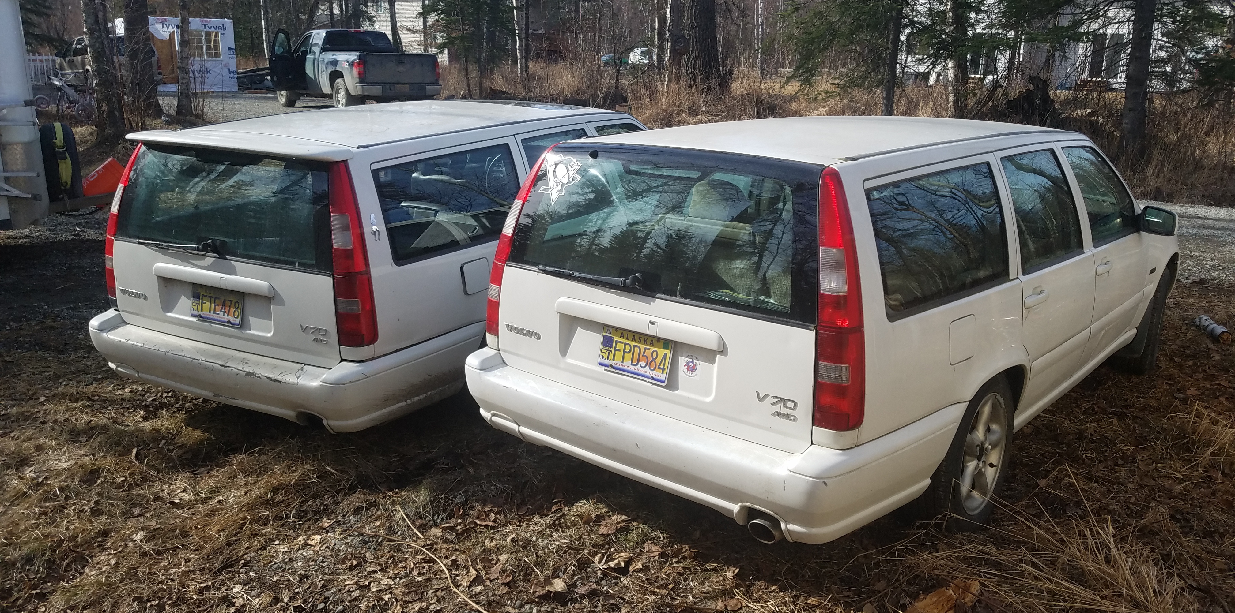

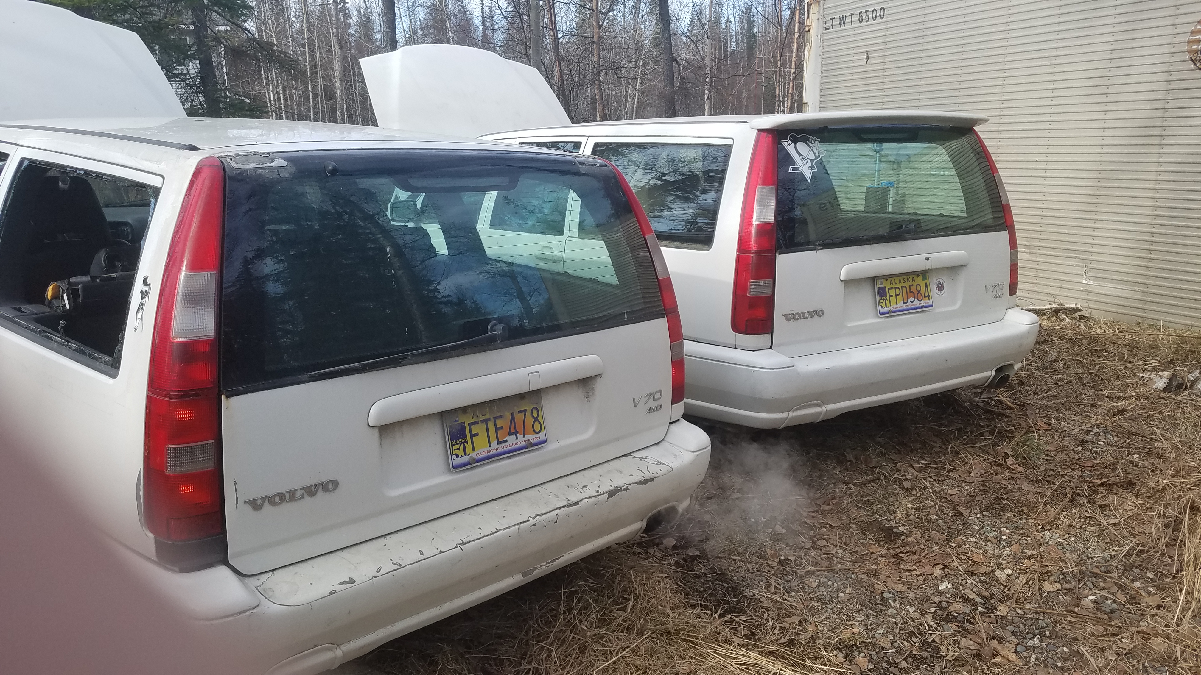

Literally purchased both cars from different sellers on craigslist in the same week. One has an excellent body and transmission the other has good motor and trans but beat up body.. between the 2 I am starting my new build

Paid $450 for the one with the good motor and trans got the one with penguins sticker free from my neighbor..
Seized motor!
Seized motor!
