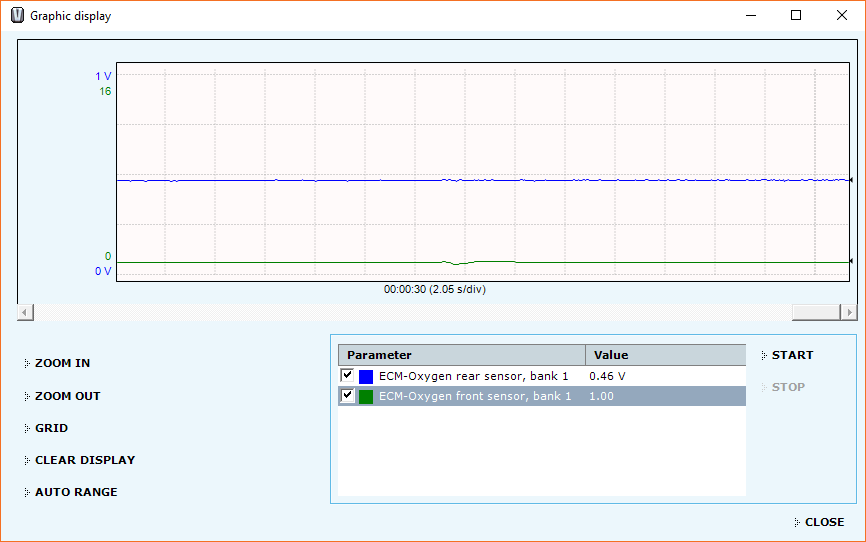

Checked the O2 sensor signals. These look right for a cold start? I'm seeing votlage from both sensors on VIDA, so that's already a plus, but they aren't fluctuating much.

Sensor 1 should be fluctuating at about 1 Hz over the 0.5V value to go closed loop - looks dead to me.
Sensor 2 should be a constant 0.5V roughly. Looks ok.

That’s what I thought. I might need an O2 sensor.
