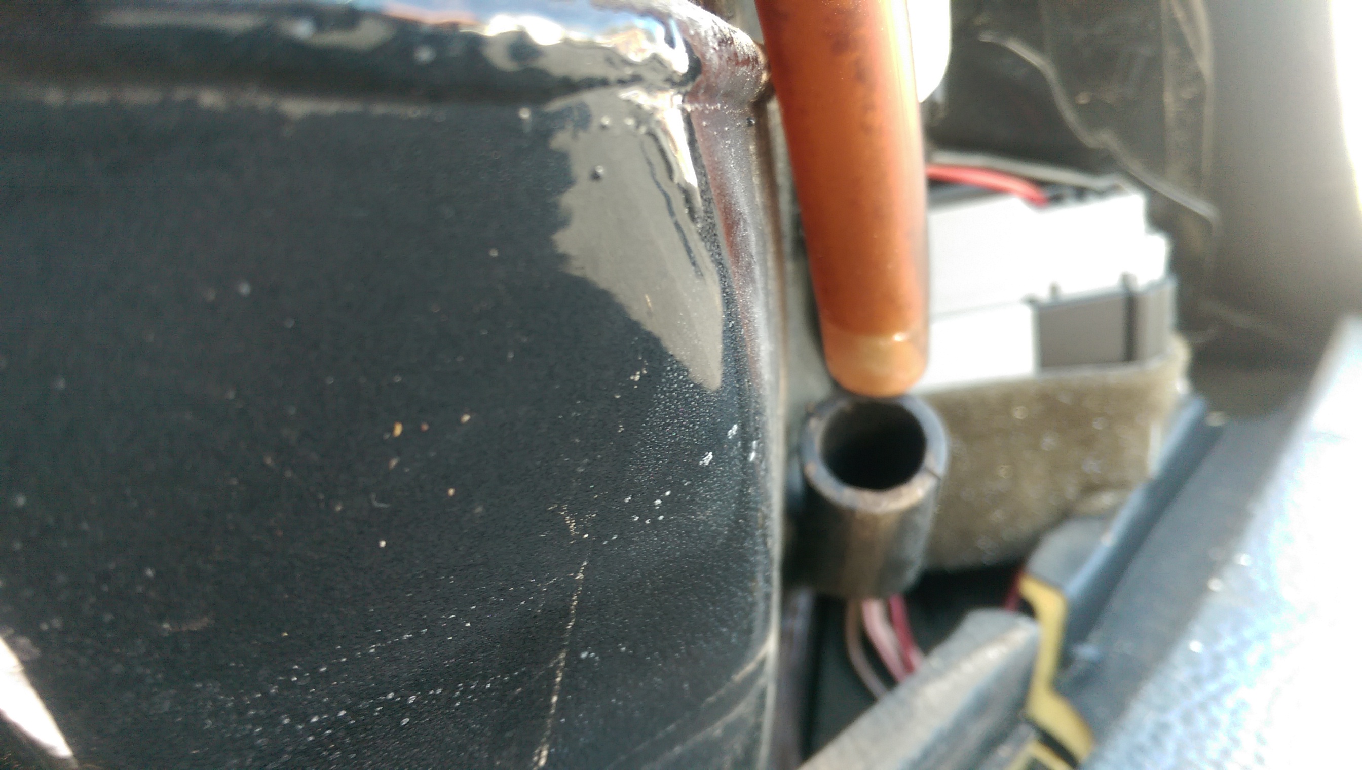

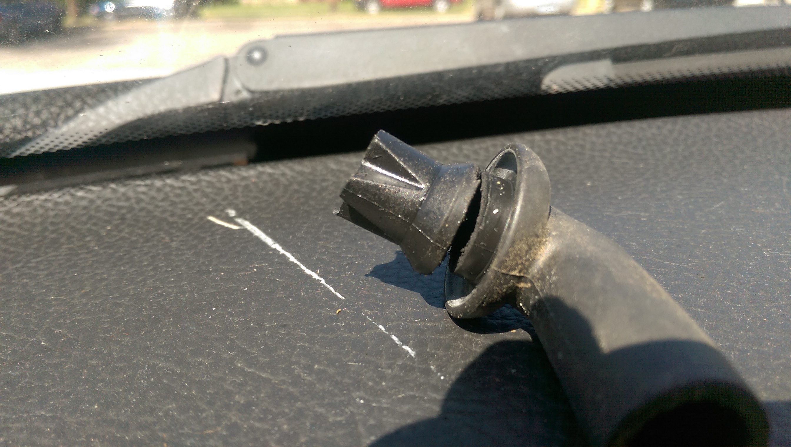

Sunroof Drain hose pulled out of Drain Valve.
Drain Valve soften and split.

Raided the local PnP. Got a Drain Valve and A pillar cover in good condition. Sunroof drain problem solved.

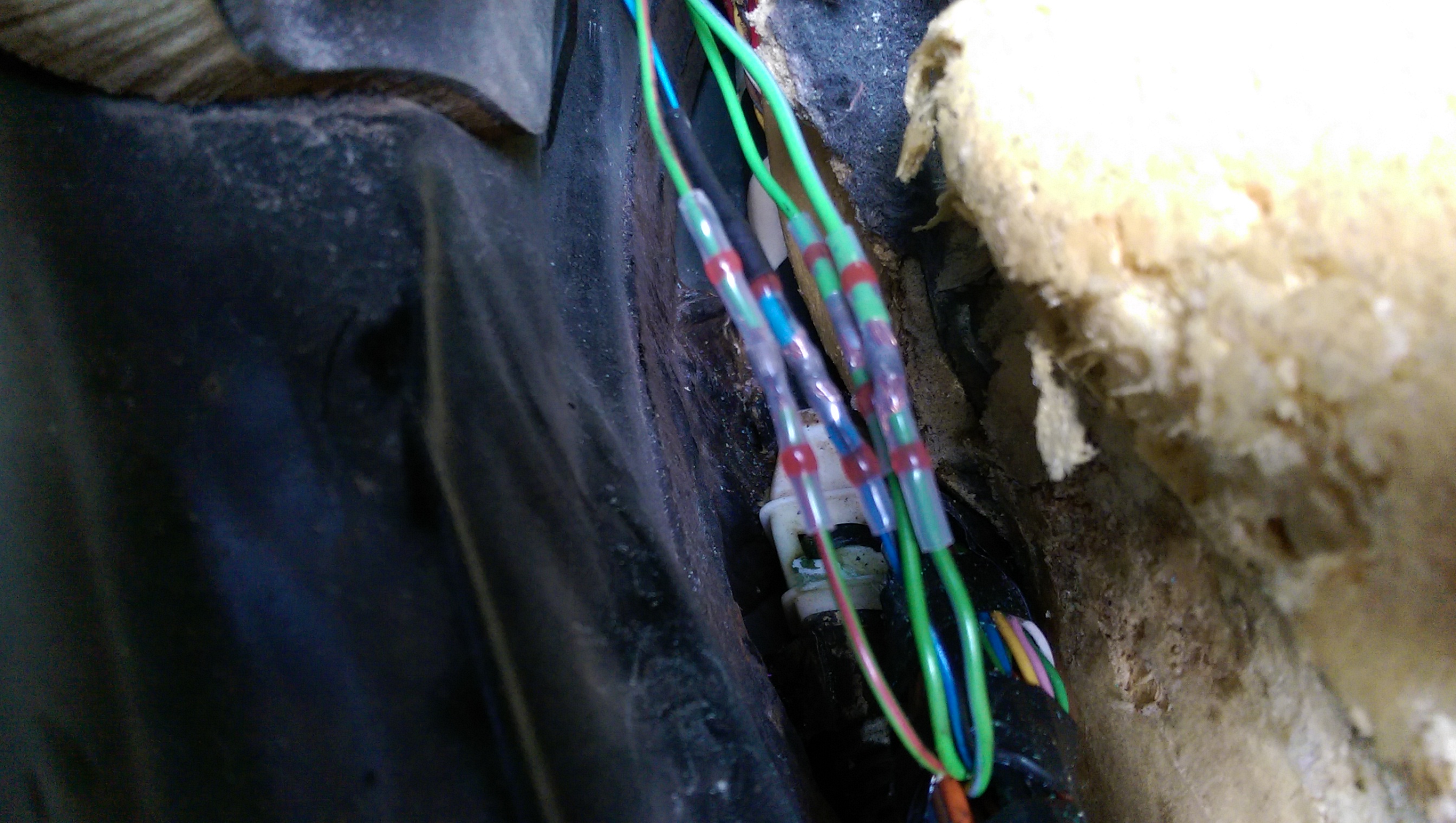

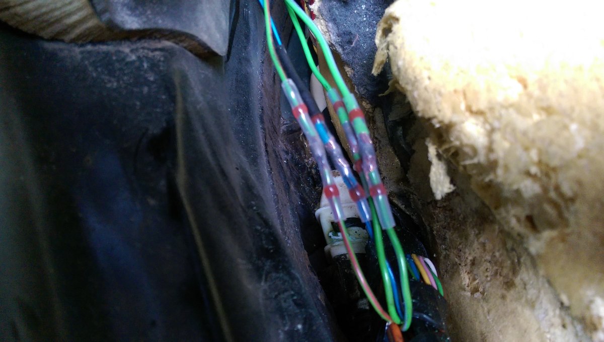

ECM-432B Leak detection module, valve - single missing is history.
Solder Seal Heat Shrink Butt Wire Splices turned out to be the way to go in that tight space. It was a lot easier because, once it got started the Shrink tube held it all together until the solder melted. Also it is a lot easier to work hot air from a heat gun in a tight space. Most people have a heat gun stored in the bathroom, you know it as a blow dryer.
The Solder Seal Heat Shrink Butt Wire Splices worked OK, way better the crimp connectors, but next time I use them I am going to put a drop of Liquid Rosin on the joint for better solder flow.
Next get the engine running right.

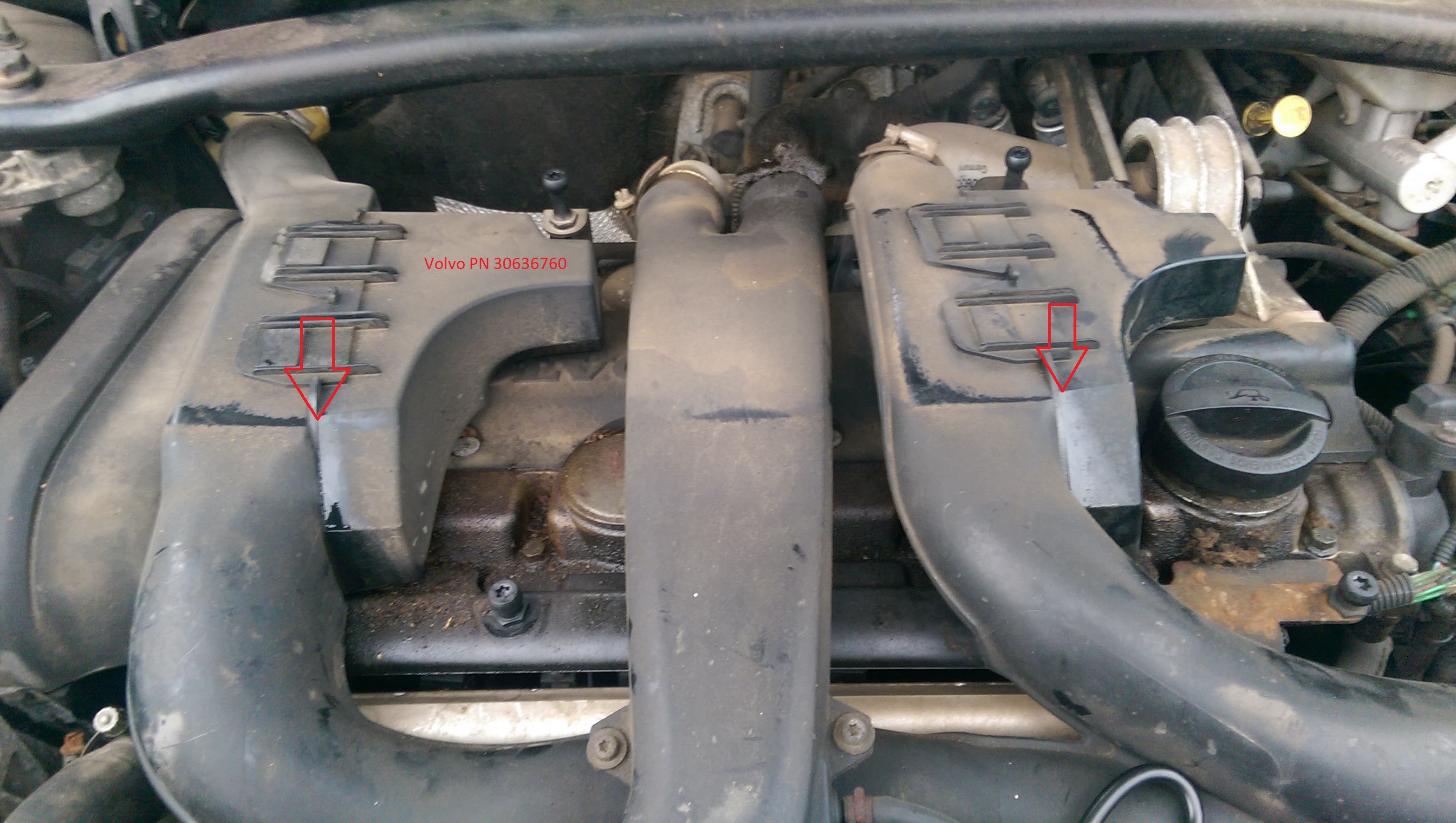

Fails intake smoke test: Seals leaking on Air filter to Turbos pipe (VPN 30636760), both sides.
Fails Intake Vacuum test: No Vacuum, +3 PSI pressure with engine at 4000 rpm.
Charge tube pressure test @ 4000 RPM: Jumps to +7 PSI then falls to +3 PSI and holds.
Smoke test: Seals leaking at the red arrows.

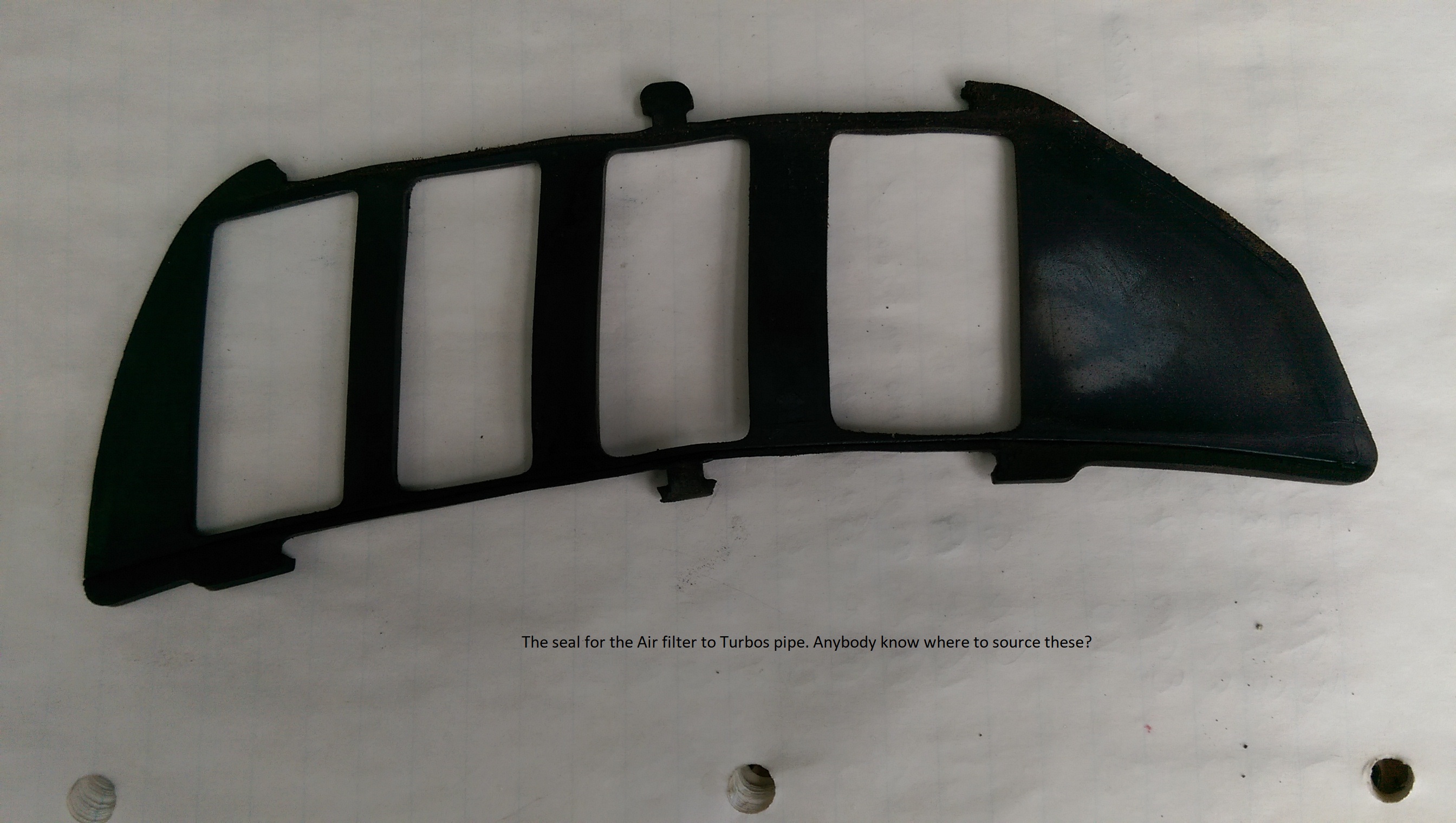

Anybody know where to source the seals for VPN 30636760?

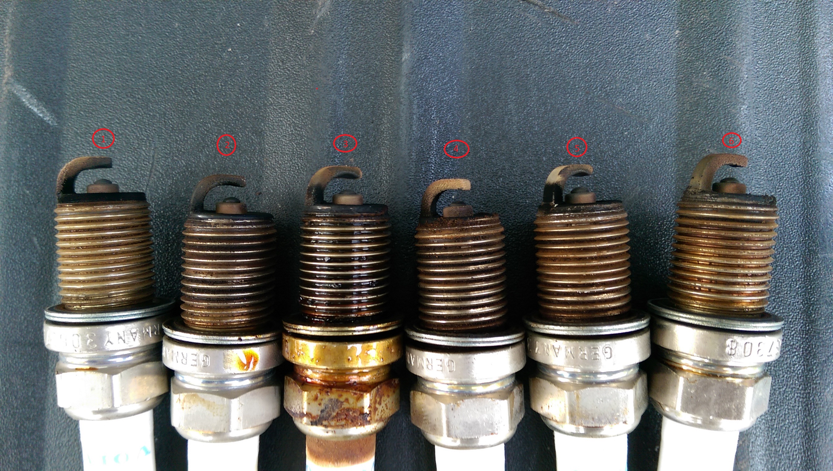

Spark plugs are pretty much gone.
Compression Good: (1) 122 PSI, (2) 119 PSI, (3) 122 PSI, (4) 122 PSI, (5) 119 PSI, (6) 122 PSI.

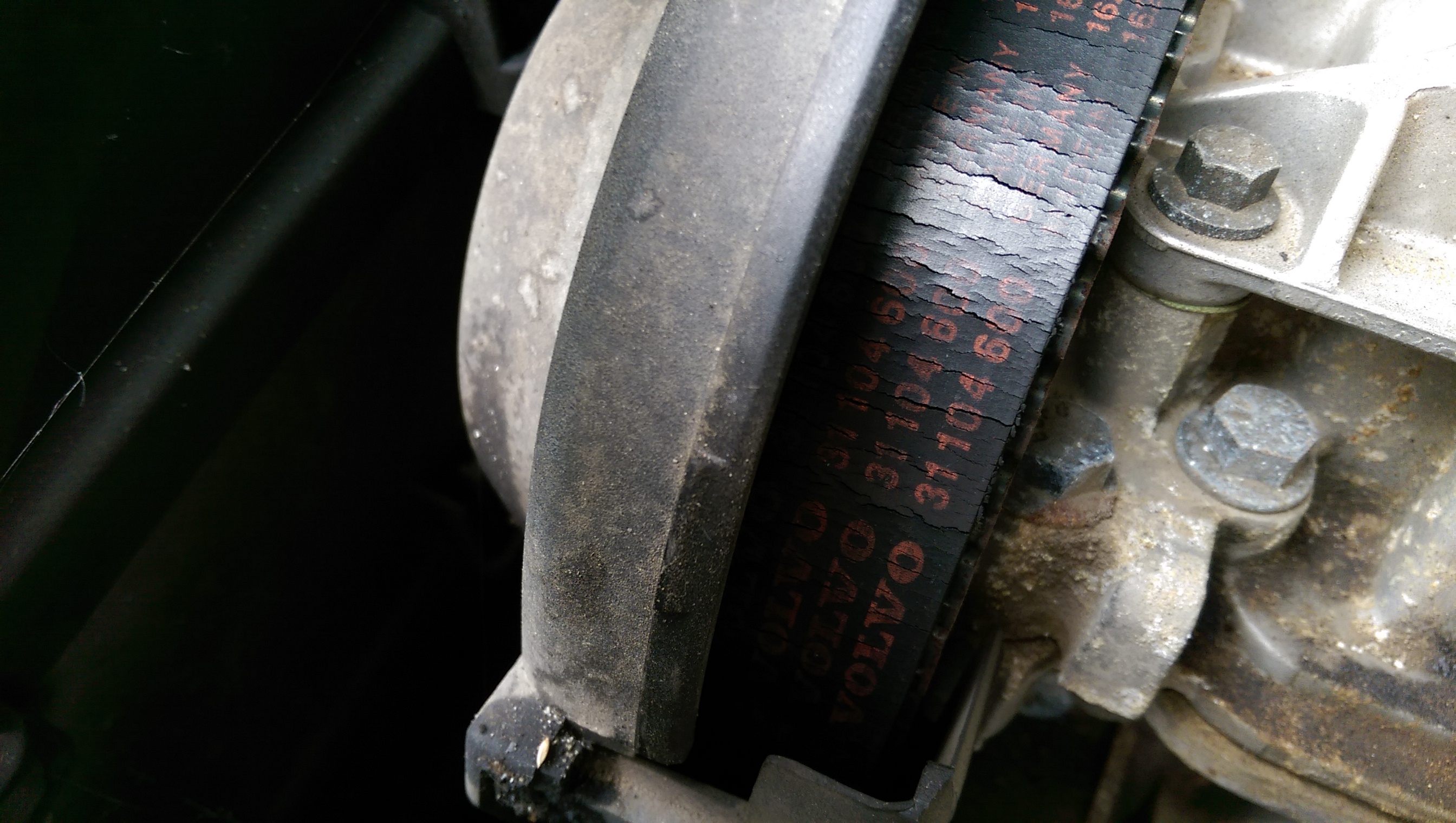

Option 2, Forge ahead on the engine. Plugs, PCV. Timing Belt service and possibly a new set of injectors. Deal with the exhaust system later if it turns out it is restricted.
