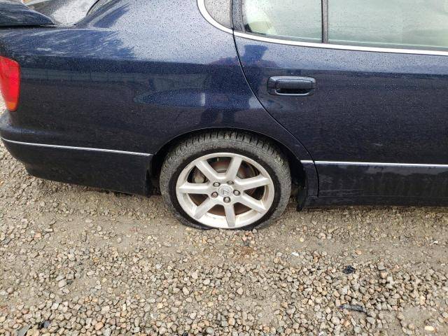

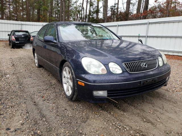

Purchased the 2005 GS430 with 240K plus miles from CoPart in March. Car either took flight, down a ravine or 4 wheeling up onto a curb or combination there off. Car was wet from rain in CoPart's photos so looked okay except for one flat tire. Bid and had them delivered. WOW, buyers remorse as soon as the tow truck arrived!

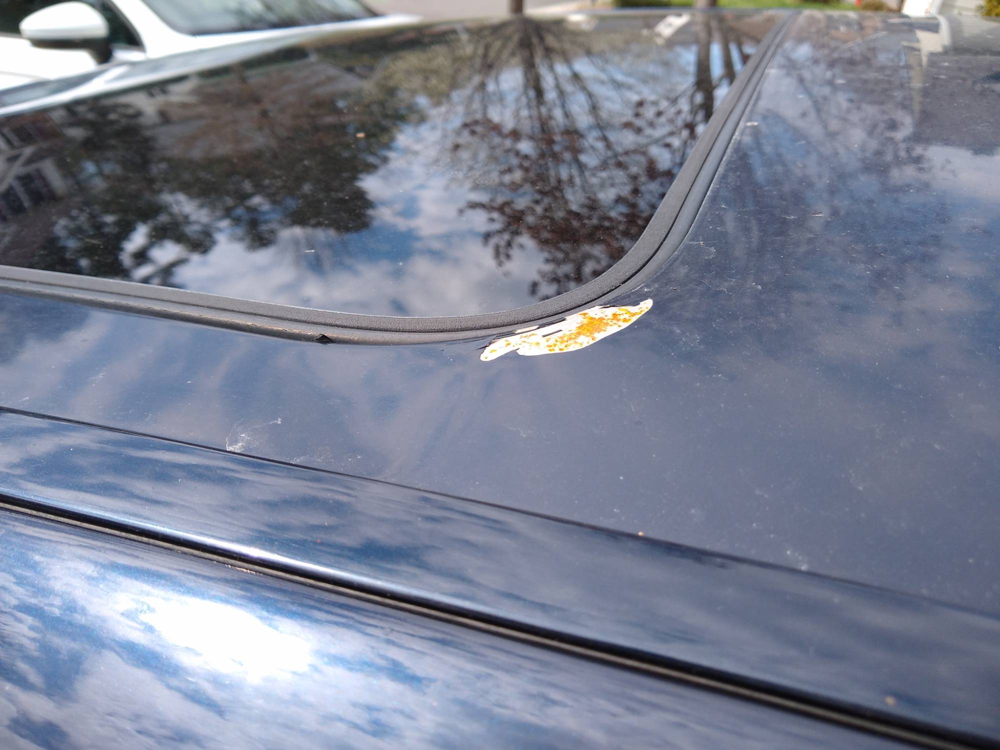

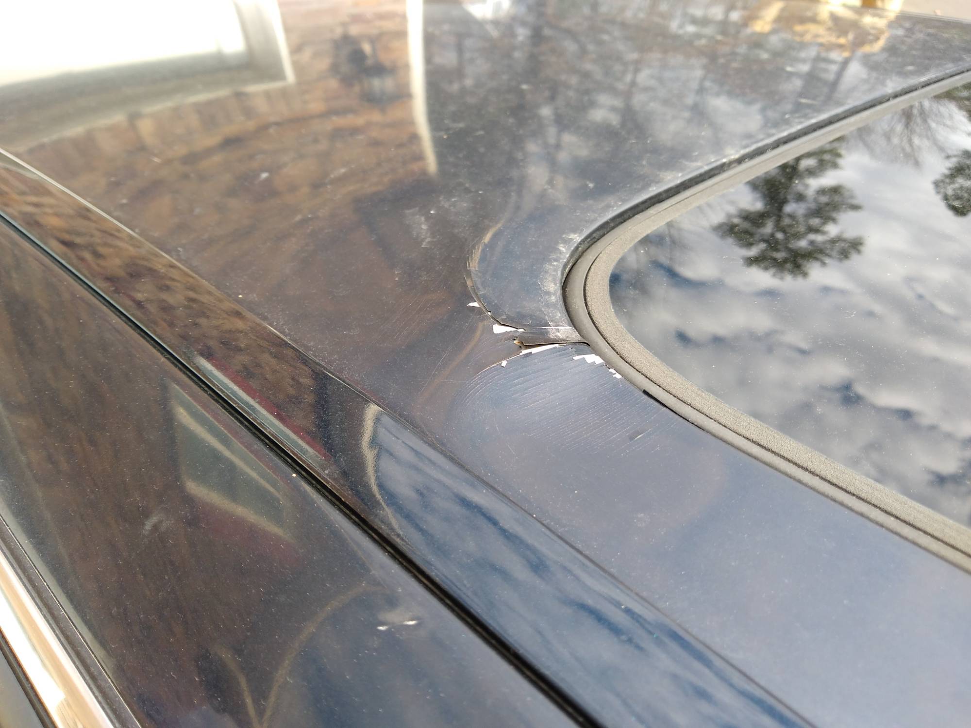

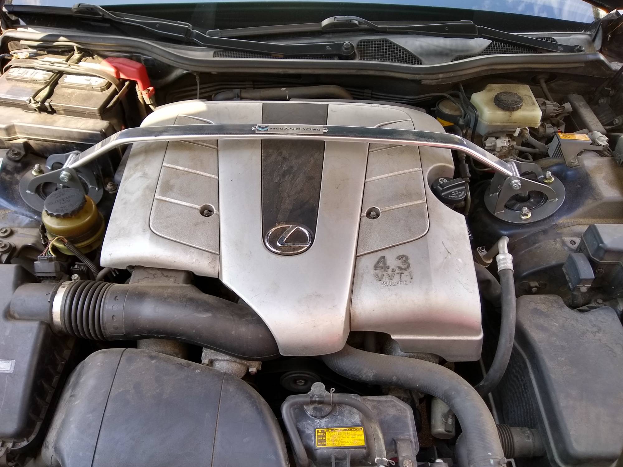

1) Sheet metal around sunroof twisted, paint crack and rusting already. 2) Front strut mount distance about an inch narrow in between so had a difficult time installing upper strut brace, which also requires the hood to be pushed against the bar to close. 3) Maxed out front camber when I did the 4 wheel alignment. Still a little more negative camber than I like. 4) Four bent strut / shocks. 5) 2 bent rear lower control arms. 6) Belly pan gone and oil pan heavily smashed / dented but thank God not leaking. 7) One popped tire from I assume hitting something at a right angle. 8.) Both front fender liner are loose with plastic plugs gone. 9) Hood heavily pitted and rusting. 10) Front inner and outer tie rods worn and frozen.

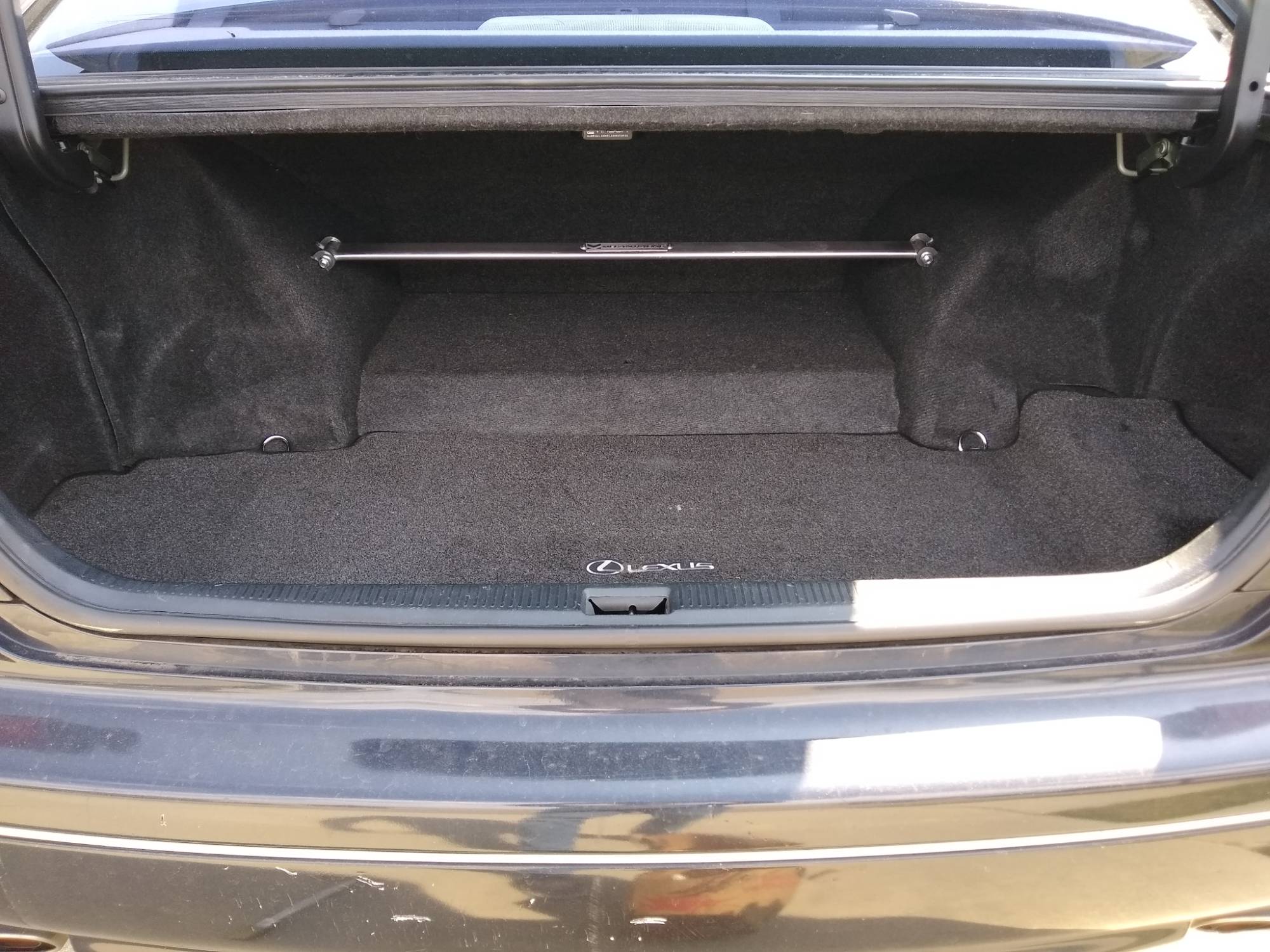

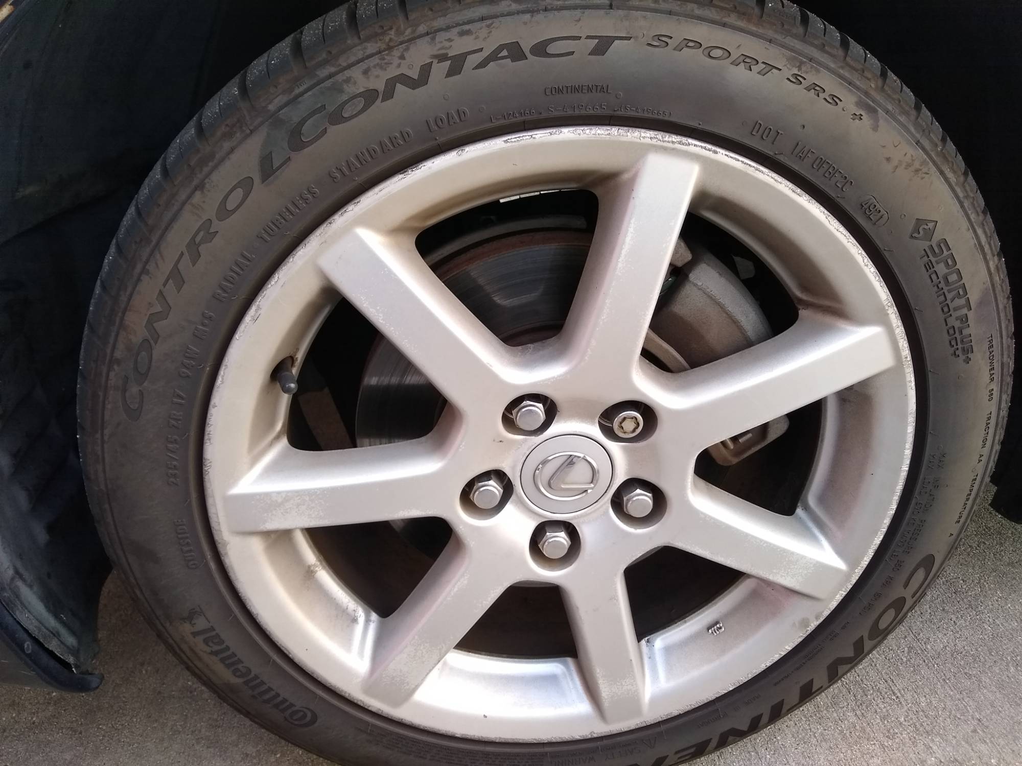

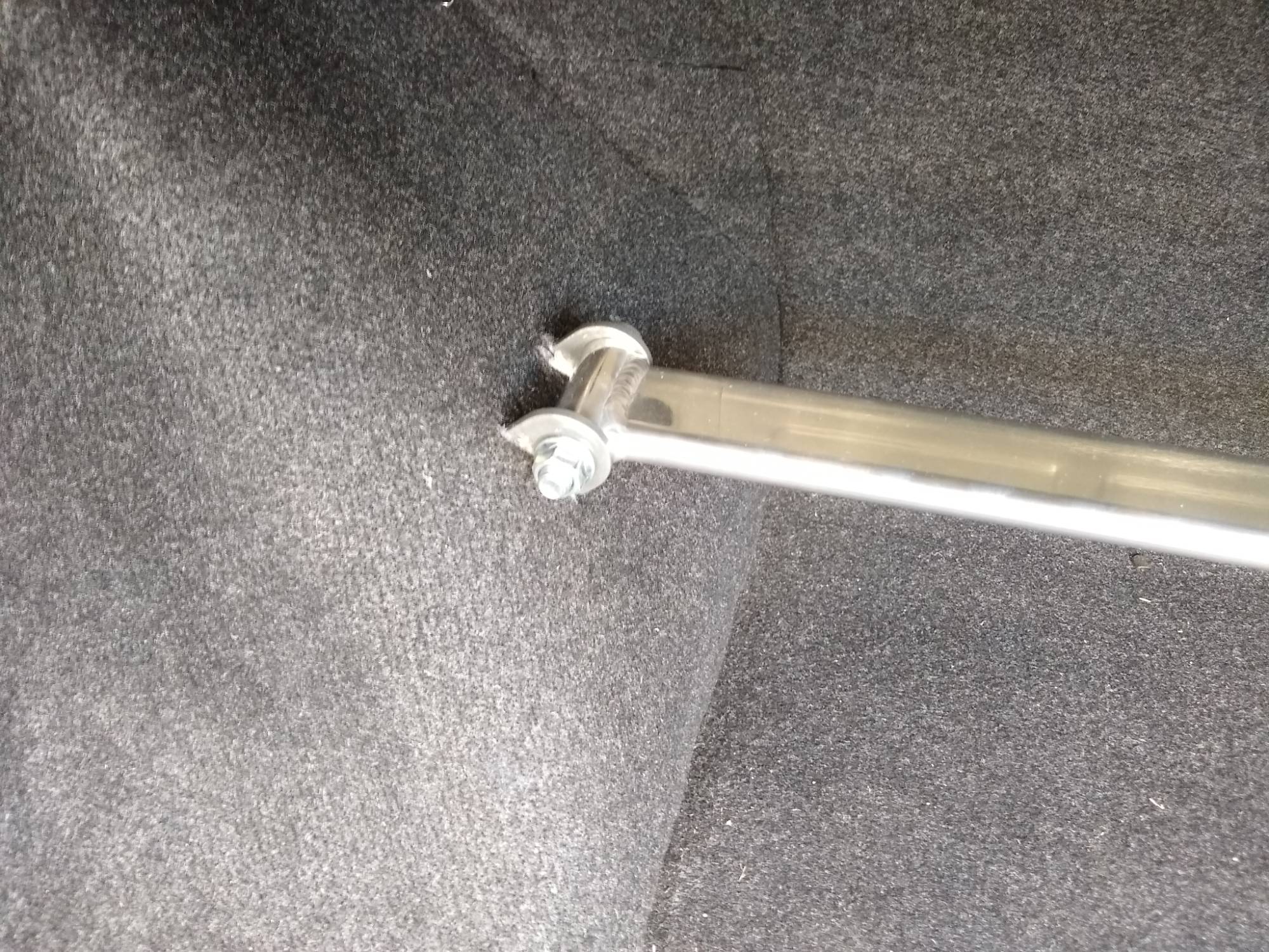

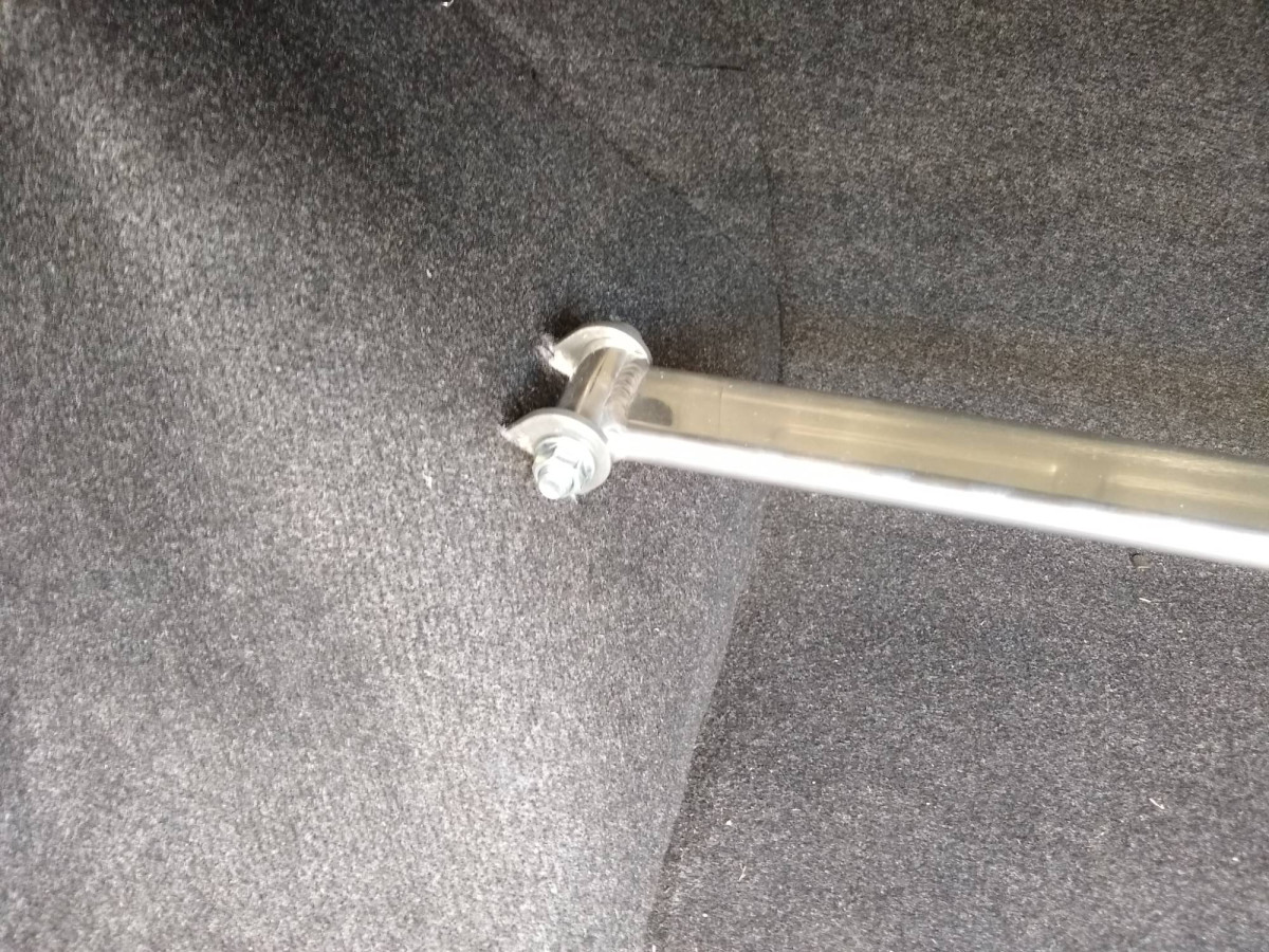

Replaced all bent parts and did a 4 wheel alignment and added rear sway bar and 2 strut bars. Solid as a rock and basically no lean in the corner. Research found the previous owner had purchase the Conti exclusive to Discount Tire were almost 2 years old but basically new. She had the Road Hazard Warranty which Discount honored and transferred into my name. One tire free under warranty, purchased another so one end has 2 new tires and the other newer went to the full size spare. Son took a trip to VA and said it was very smooth, comfortable and stable.
The rear sway bar eliminated the plow / understeer of the heavy front end due to the V8.
