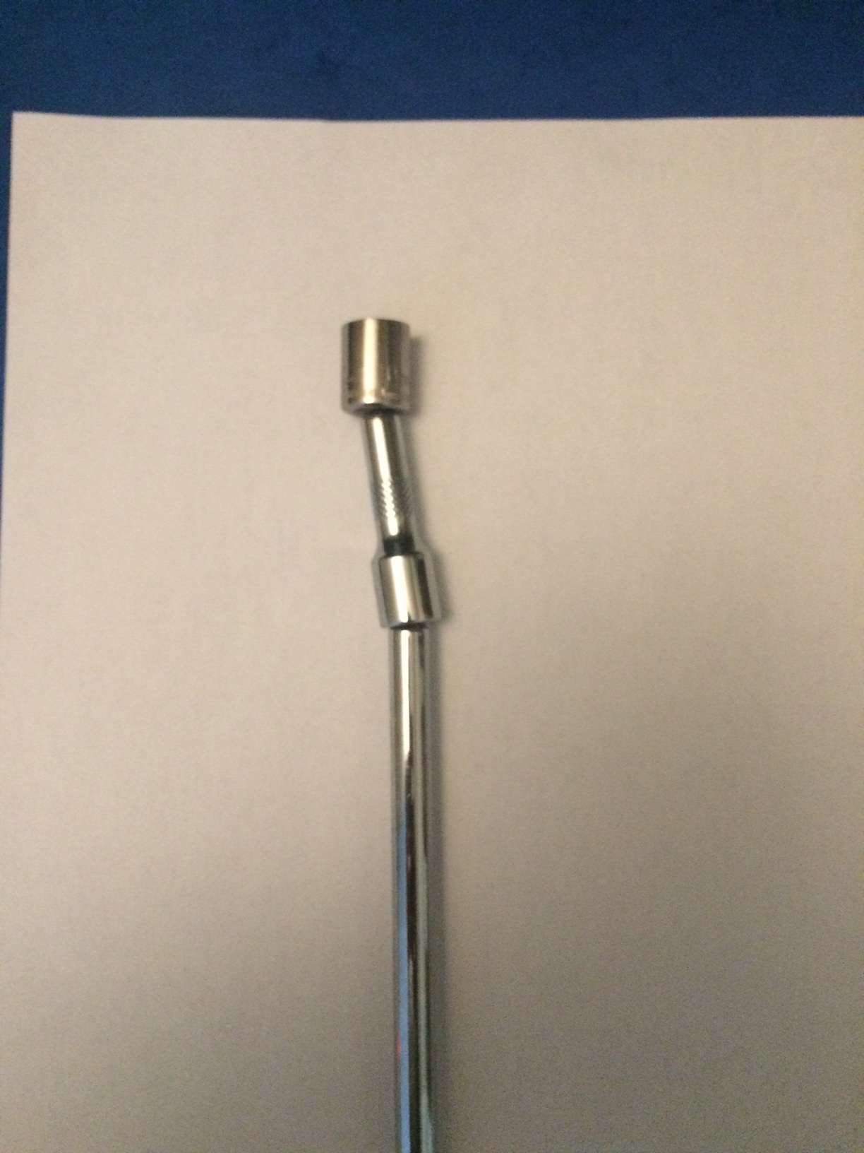

Needs more grinding, but this is where I'm at. Socket reduced from 22+mm to 17mm in length. Part of the challenge is that the whole socket and extension assembly is pretty floppy (the Snap-On socket appears to be spring loaded so better). I'm thinking some sort of wire bent to the right shape and taped to the assembly is the key to get it in there in the right orientation. Once you get on the bolt, constant pressure will keep it in shape.
