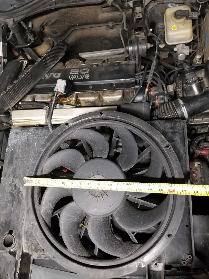

The Volvo fan is physically 15.5". The housing is 17".
The mishimoto fan housing is 16" and the fans are 15.9". Physically it's a perfect fit. The mishimoto bolt holes line up damn near perfect to the Volvo ones.

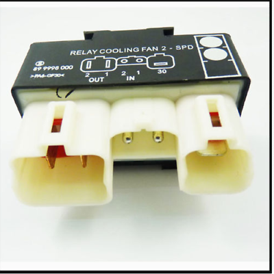

Here's the only issue. The mishimoto fan has one positive wire and one negative wire. The Volvo fan has TWO positive wires and one negative wire. This is because of the cooling fan relay.
Fan relay. The left hand Connection goes straight to the fan motor.
