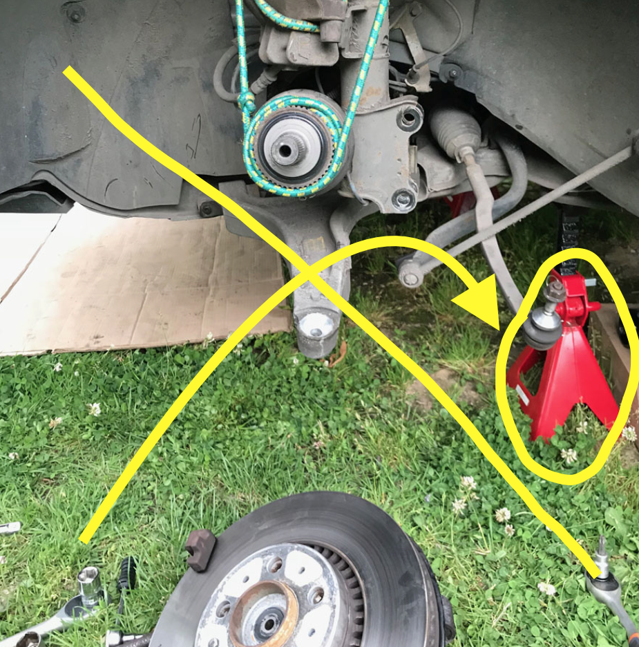

Car safety Police here. That is a no on jack stands on unstable ground, please.
You could work that with a stiff piece of wood or metal in good condition for all four bearing surfaces of the jack stand.

Post by amblerman »
That photo scares me. How could that even work? I can't imagine the ground being hard enough to support that as it is.
We were on a nice driveway and all surfaces were solid.
Posts: 36162
Joined: 17 Feb 2013, 17:54
Has thanked: 1611 times
Been thanked: 4075 times
That was Antoine's bad.
Merci, mon ami....
Liberte, Equalite, Fraternite, and Jackstande on Cemente

Post by oragex »
Jackstands on grass ? That looks scarry. The jack may even incline and flip on the side being tall
