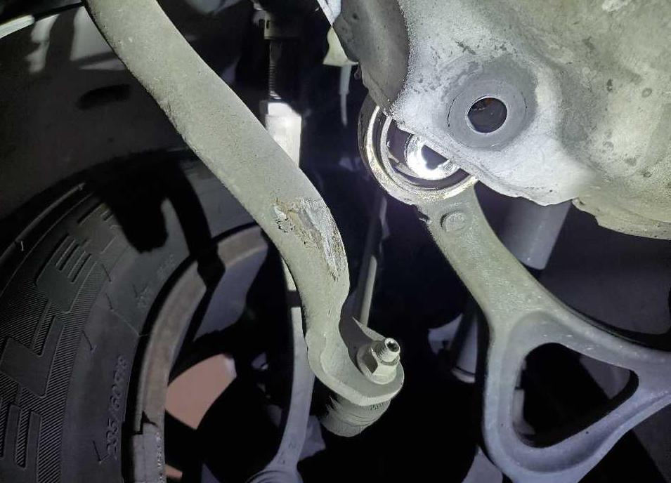

I have attached 3 pictures taken by insurance assessor.
The repair shop at the dealership said the parts would come on Monday and I would get the car back on Tuesday. It all seems a bit too quick and not thorough enough. I wonder if there is some check you guys can suggest that I ask the repair folks to perform to doubly and triply make sure the car is safe to drive.
Thanks in advance.
Thanks in advance.

There doesn't appear to be any impact area - any marks on the wheel ?
The control arm rear bolt broke and the control arm hit the sway bar - the mark on the bar.
Why the bolt snapped, was any suspension work done in the past ? Overt-ightening this bolt can weaken it.

That’s scary. Glad your ok. Are they replacing the whole arm? Lots of stress on the front bushing in this case.

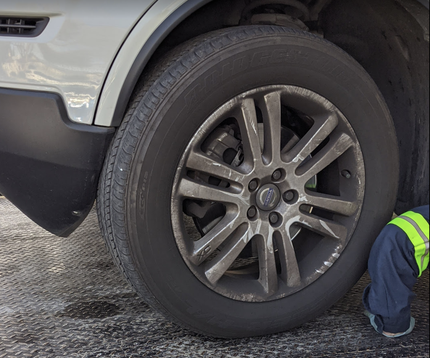

Attached is a close-up on the front left tire with elbow of the tow truck guy. The tire already rubbed against the bumper as I said in my original post. Other than that, I can't see anything abnormal. The wheel has the marks from abrasions against curbs from the past 8 years of driving done by my wife and sometimes me. I would say it's still within the normal range. FYI - The mileage is only 50K for a 8 year ownership.
Over the past 6 months, I did send it to Pepboyz for oil change (Sept 2019) and a wheel alignment (Jan 2020)... Not sure either involves the control arm bolts (I am not ready to think about foul play yet)...
Fast forward to now, from the itemized listing of repair shop at the dealership, I can tell the repair is going to include a complete replacement of control arm and bolts.
I am happy that I am sitting here, breathing and typing. But outraged and shaking from thoughts of what if's. What if I was driving on highway or windy roads on the hills...

The XC90 control arm can be steel or aluminum, depending on the year (IIRC).
The fore part has 2 horizontal bolts, the aft one vertical bolt.
Your aft vertical bolt broke off, it was probably damaged/weakened by the curb hit, then on highway, it just broke off.
I wrote a whole front end DIY, so you can see all details below.
DIY: Front Suspension Rebuild (2005 XC90 2.5T AWD with 120K)
viewtopic.php?t=91985
PS: My recommendation is to replace all 6 bolts to be safe. Very easy to replace all 6 bolts.
Check the control arm for micro-fracture(s), may want to replace the control arm (use only Volvo OEM or Meyle).
Balljoint is Lemforder.
