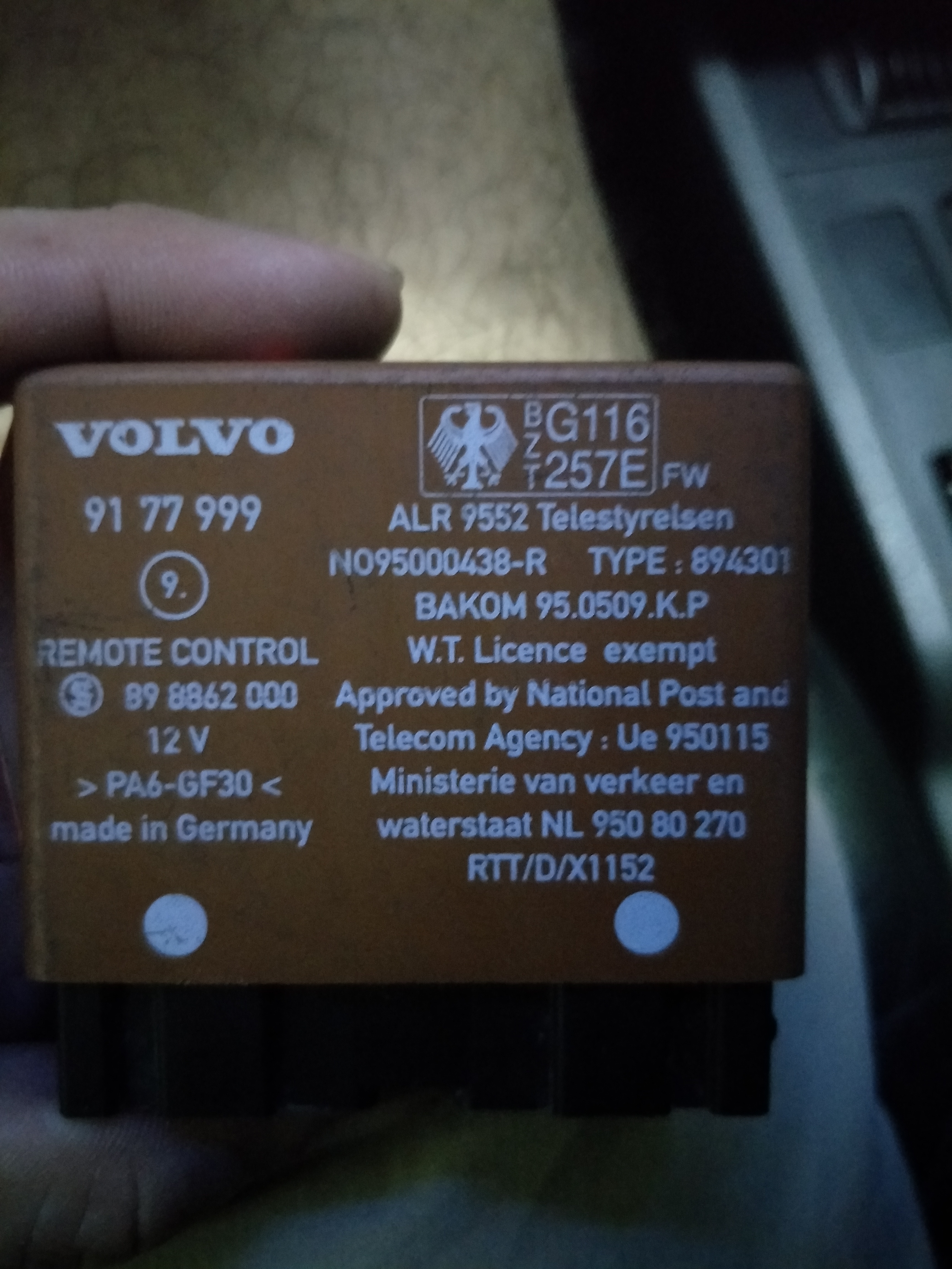

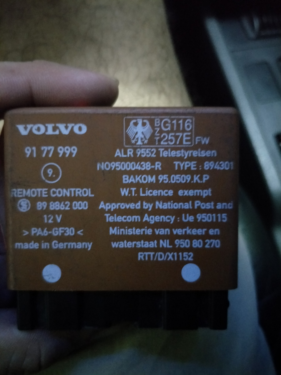

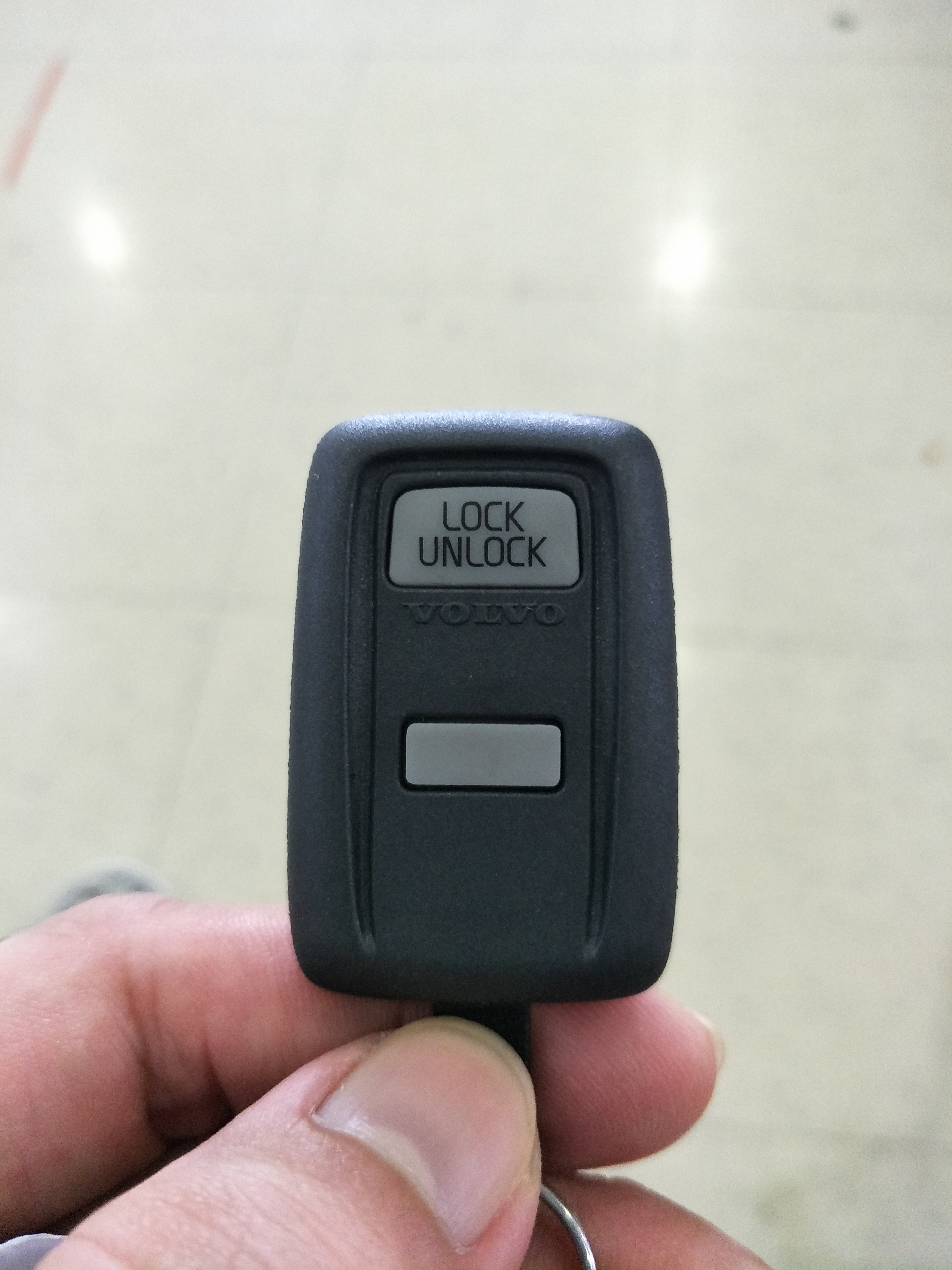

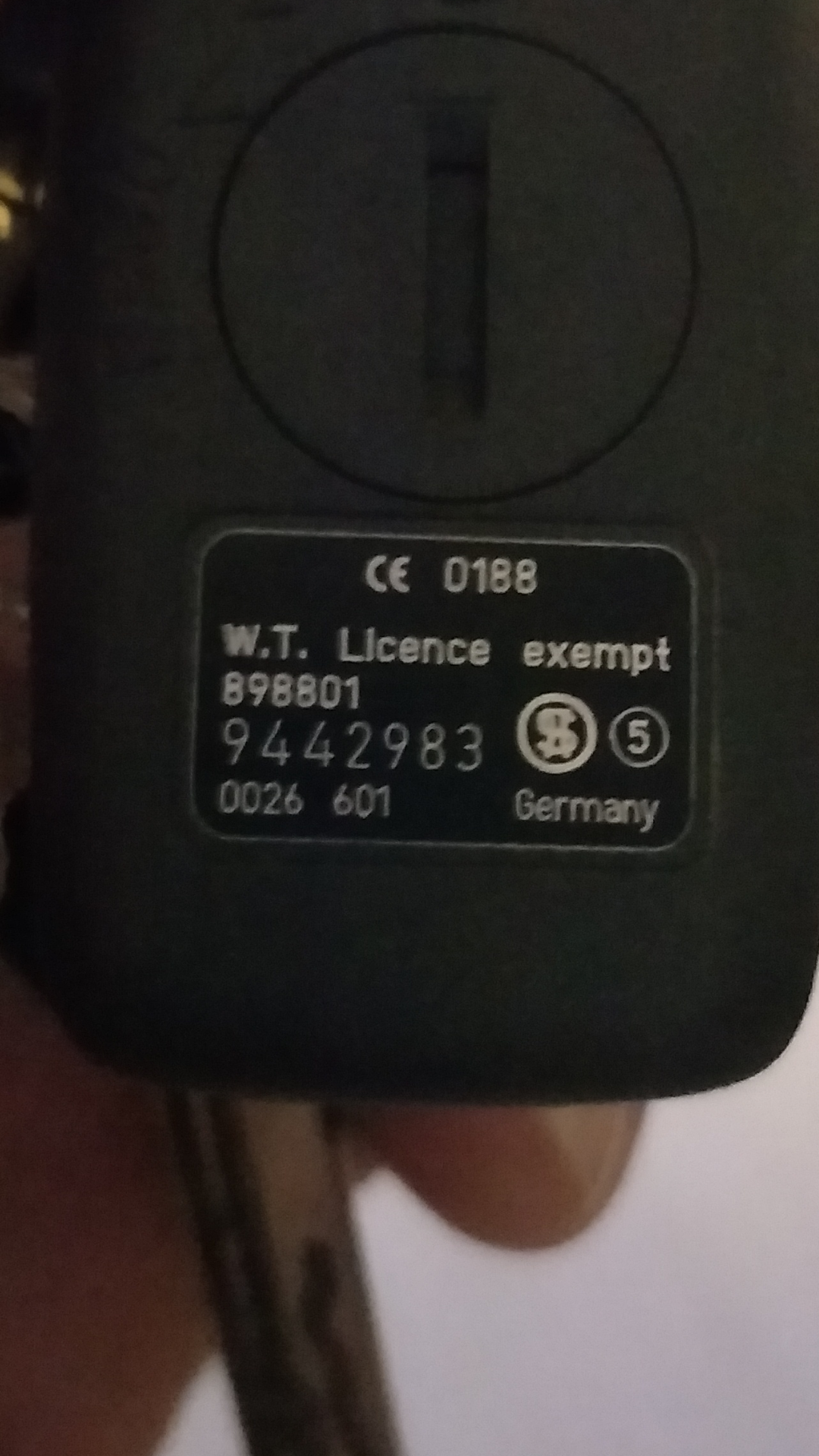

Hi. I'm hoping that someone could give me the right remote for my 1996 Volvo 850 GLT.
It came with the 91 77 999 relay (no alarm, just lock and unlock feature)
It had no remote when i bought it.
Purchased the remote with part number 9442983 in the hopes that it would work.
Did some research and found that the relay or this remote should be the 9148881 and it is freakin difficult to find one.
1. Can a volvo guard tester be used to program my relay so that the remote would work?
2. Any idea what the part number of the remote that came with relay 91 77 999 (brown relay)
Thank you in advance

The brown relay is for locking and unlocking the doors without a remote. You need to swap that with the gray 210/211 relay. See an earlier post of mine with details
