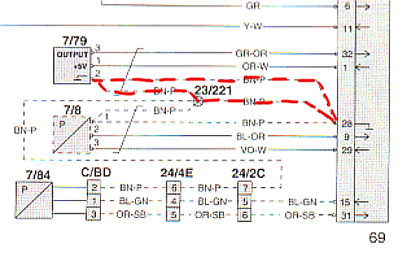

I see from the wiring diagram that the negative wires from the accelerometer, the A/C pressure sensor, and the tank pressure sensor come together at pin 28 on the ECU, so there is some speculation about those other sensors tripping this code. But I still haven't read a story of somebody fixing their tank pressure sensor and getting rid of their P1308. Or swapping the A/C sensor and getting rid of the code.
Does ECU pin 28 connect to the chassis ground somehow?

I'm new to reading these wiring diagrams, so I can't tell if there is a wire which runs straight from pin 2 of the accelerometer and also a redundant wire through 23/221, or if it's an either/or situation.

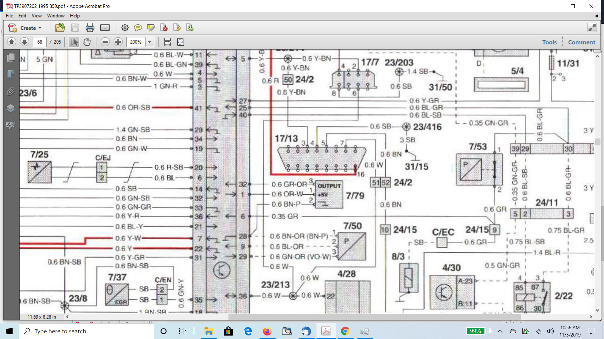

Are you reading it old school (paper) or a electronics pdf file?I can't tell if there is a wire which runs straight from pin 2 of the accelerometer
Pin #2 of the accelerometer goes straight to ECU pin #B28, It is the Accelerometer and A/C pressure sensor ground ... grounded through the ECU.
No redundancy.also a redundant wire through 23/221, or if it's an either/or situation.
Four lines off that junction.
1. 4/28 TCM pin #22
2. 4/46 ECU pin #B36.
3. 7/17 MAF pin #6.
4. 17/13 OBD Socket pin #7.
It is a CAN bus.
Active
Past
Past

I'm reading a PDF scan of a paper manual, TP 3911202. I put red lines on the two current paths from the acceleration sensor to the ECU pin 28.
This is an ISO 9141 car. I didn't know they used CAN.
Last night I pulled and reseated the connector on the acceleration sensor, but I was still reading 5 volts on my scan tool and getting the code. Today, however, I'm getting 2.49 volts and that code is staying cleared.

TP3911202 is 1996 850.
This is TP3907202 1995 850.

This is a bit embarrassing. After I started this thread I went back and discovered that the car is a 96, not a 95. That 95 diagram you posted is considerably different.RickHaleParker wrote: 05 Nov 2019, 10:05 TP3911202 is 1996 850.

I found the same image in TP3911202. It is not redundancy it, is options. The EWD is written as one size fits all, that is cover all the markets and configurations. The dashed lines represent variations. In some configurations the Accelerometer is grounded straight to the ECM. In other configurations it is grounded via junction 23/231.850oldschool wrote: 04 Nov 2019, 20:03 I put red lines on the two current paths from the acceleration sensor to the ECU pin 28.
Because of a reevaluation of engineering and manufacturing finanaces in the 90s. You see less and less of that practice after the 90s because, they found it is more cost effective to use one part fits many then the old practice of trying to save money on parts. The saving from a reduction in handling overhead is greater then the savings in part cost.

Rick, thanks for the background info! When I look at the diagram I'm quite skeptical that a fault with any of the other three sensors which are (potentially) bonded to the common ground at pin 28 could cause the accelerometer fault if the accelerometer ground is intact. It looks pretty simple: 5 volts goes out, and a fluctuating signal around 2.5 volts comes back.
