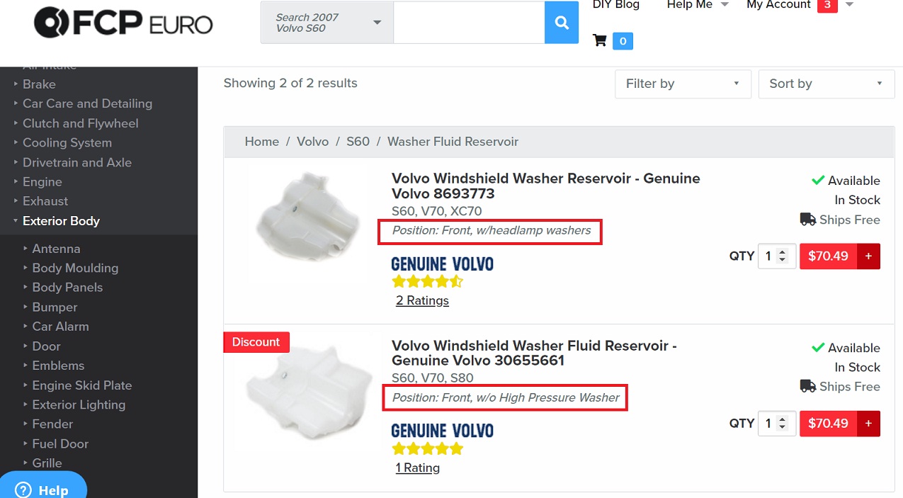

Not sure this helps anyone but I ordered the "wrong" washer reservoir.
My car has intensive washer feature for the HL lens, but I ordered the standard reservoir.
The P.O. probably used "summer juice" so the intensive washer pump cracked open in half.
I was about to return the Washer Reservoir in exchange for the proper part.
As it turned out, I installed a standard reservoir (for models without intensive washer system) and
it works perfectly bc I don't want the intensive washer system anyway (wasting juice etc. etc. that I discussed
in this forum before).
So, for those who want to install the standard reservoir into a car that came with intensive washing system, you can.
You just have to decommission the intensive washing system: just unplug the intensive washing system and call it a day.
Here is the PNs for these different reservoirs....

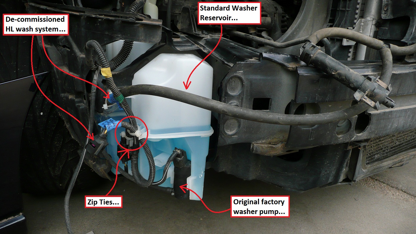

This is the "Standard Reservoir" installation in a car that came with HL wash system...
- As mentioned above, I de-commissioned the HL wash system as shown.
- Factory washer pump + new rubber seal (genuine Volvo seal).
- Zip ties as shown.
- Glad I de-commissioned the HL wash system.

The nice thing about the standard reservoir is:
- Since the HL washer pump itself was rusted and broken in half (you can find photos of this issue on the web), I don't have to use the broken end of the motor and the old rubber seal, just another source for leak.
- So if one needs to replace the reservoir and decides to get rid of the HL wash system, one may as well buy the standard reservoir.
My mistake of buying the "wrong" reservoir turned out to be perfect...
