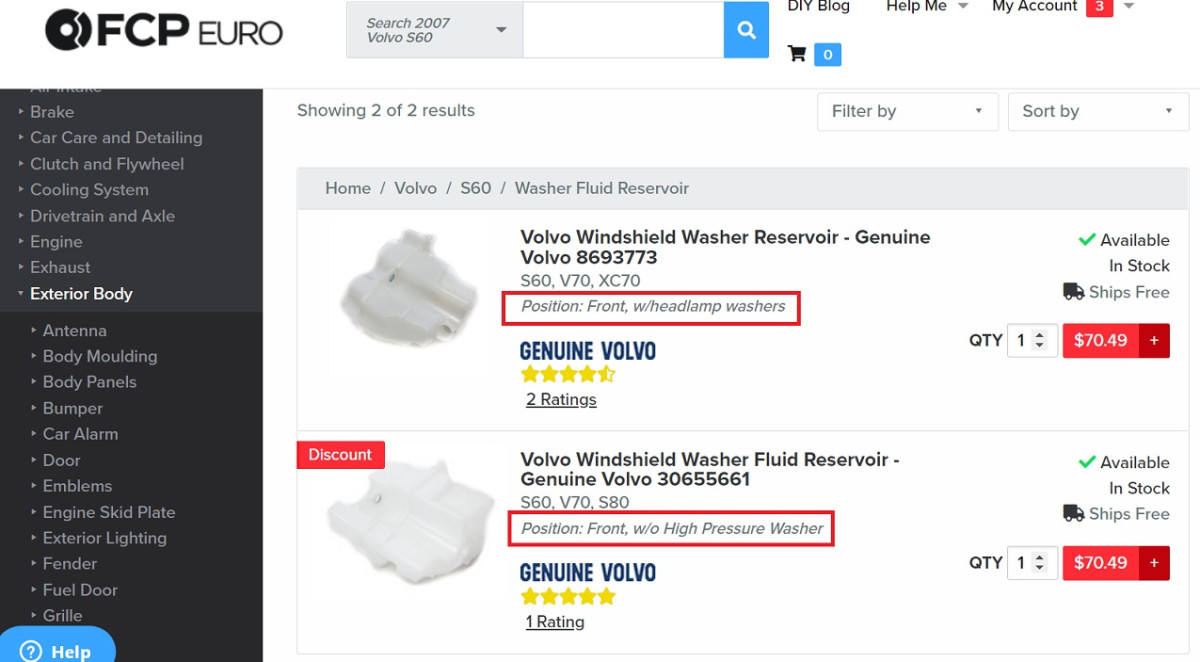

Not sure this helps anyone but I ordered the "wrong" washer reservoir.
My car has intensive washer feature for the HL lens, but I ordered the standard reservoir.
The P.O. probably used "summer juice" so the intensive washer pump cracked open in half.
I was about to return the Washer Reservoir in exchange for the proper part.
As it turned out, I installed a standard reservoir (for models without intensive washer system) and
it works perfectly bc I don't want the intensive washer system anyway (wasting juice etc. etc. that I discussed
in this forum before).
So, for those who want to install the standard reservoir into a car that came with intensive washing system, you can.
You just have to decommission the intensive washing system: just unplug the intensive washing system and call it a day.
Here is the PNs for these different reservoirs....
