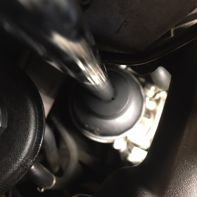

Functional Test of Oil Anti-Drain Valve
If you have any doubts about whether your B6304 (T6) or B6324 (3.2) engine is retaining oil in the filter housing while the car is off:
Here is a Function Test which assesses the plugging action of the anti-drain valve. You can do it as a routine part of the oil change, or sooner if your engine is noisy on cold startup.
Tools used:

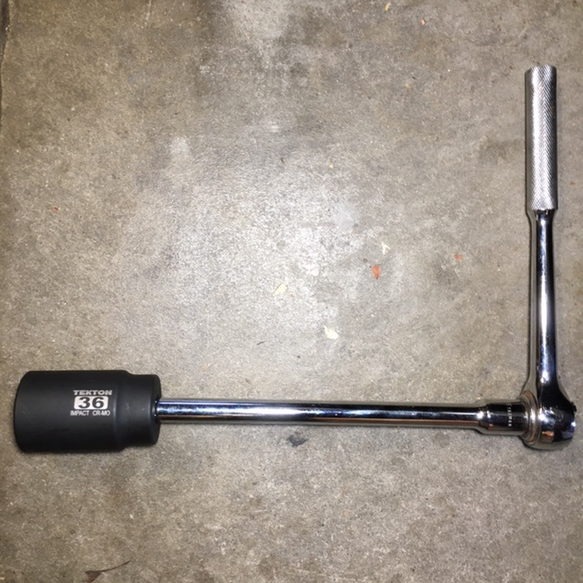

36mm socket wrench (12" shaft) 100cc syringe with 12" extender hose CLEAN PROCEDURE : Take care not to introduce any dirt onto the exposed oil system parts.
Prep:

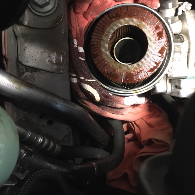

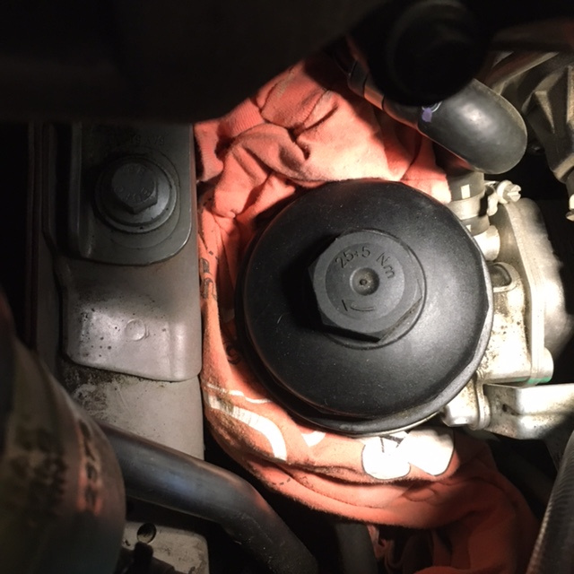

1) Remove engine cover
2) Lift Power Steering Fluid Reservoir up and move to left for working room
3) Pack drip rag around filter housing (below cap level) 4) Unscrew oil filter cap using 36mm socket wrench 5) Pull filter element down, separating it from the cap. Move cap off to the left,
taking care to keep exposed "core" clean.
Press filter element firmly down to base of housing (it will click into place) -- if

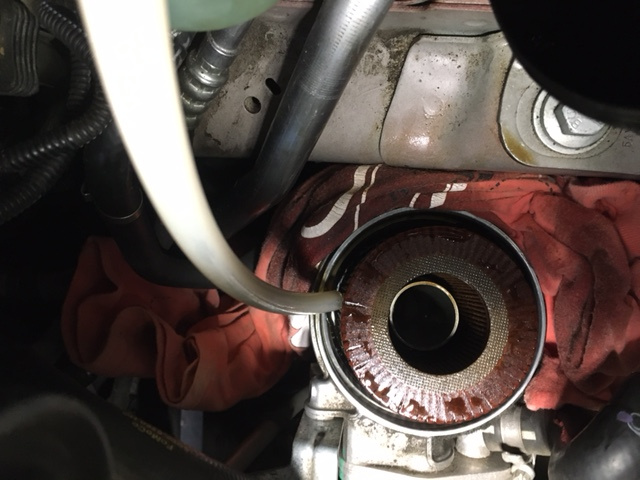

the anti-drain plug is intact, this will close the drain orifice and it will pass the test. 6) Using fresh, clean oil, fill syringe half-way (50cc)
7) Dispense oil into the gap between housing and outer edge of filter element.
Repeat - add 2nd squirt of 50cc.

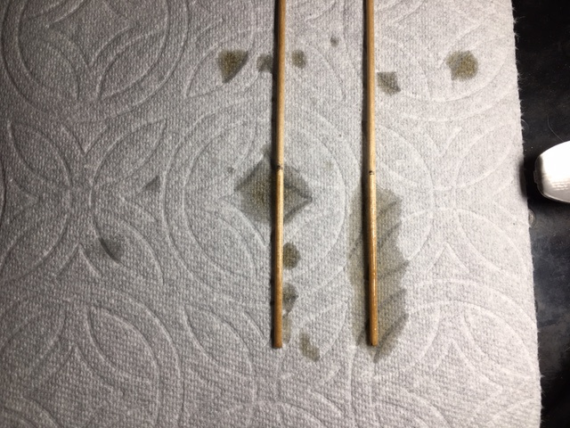

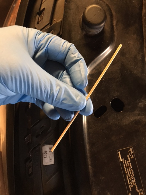

Cut two identical wood depth measuring sticks
9) Take the 1st depth measurement by dipping the stick into the reservoir periphery to bottom.
Mark meniscus line with pencil.
WAIT 10-15 MINUTES - A WELL-FUNCTIONING ANTI-DRAIN VALVE WILL HOLD THE OIL LEVEL
- A DEFECTIVE VALVE WILL NOT HOLD THE OIL LEVEL -- IT WILL DRAIN DOWN
10) Using 2nd stick, take 2nd depth measurement. Compare oil depths recorded on sticks:
NOTE: My valve tests FUNCTIONALLY GOOD If doing an oil change, swap in the new filter element.
11) Place the cap back on filter element, and screw back down until snug. Don't over-torque!
