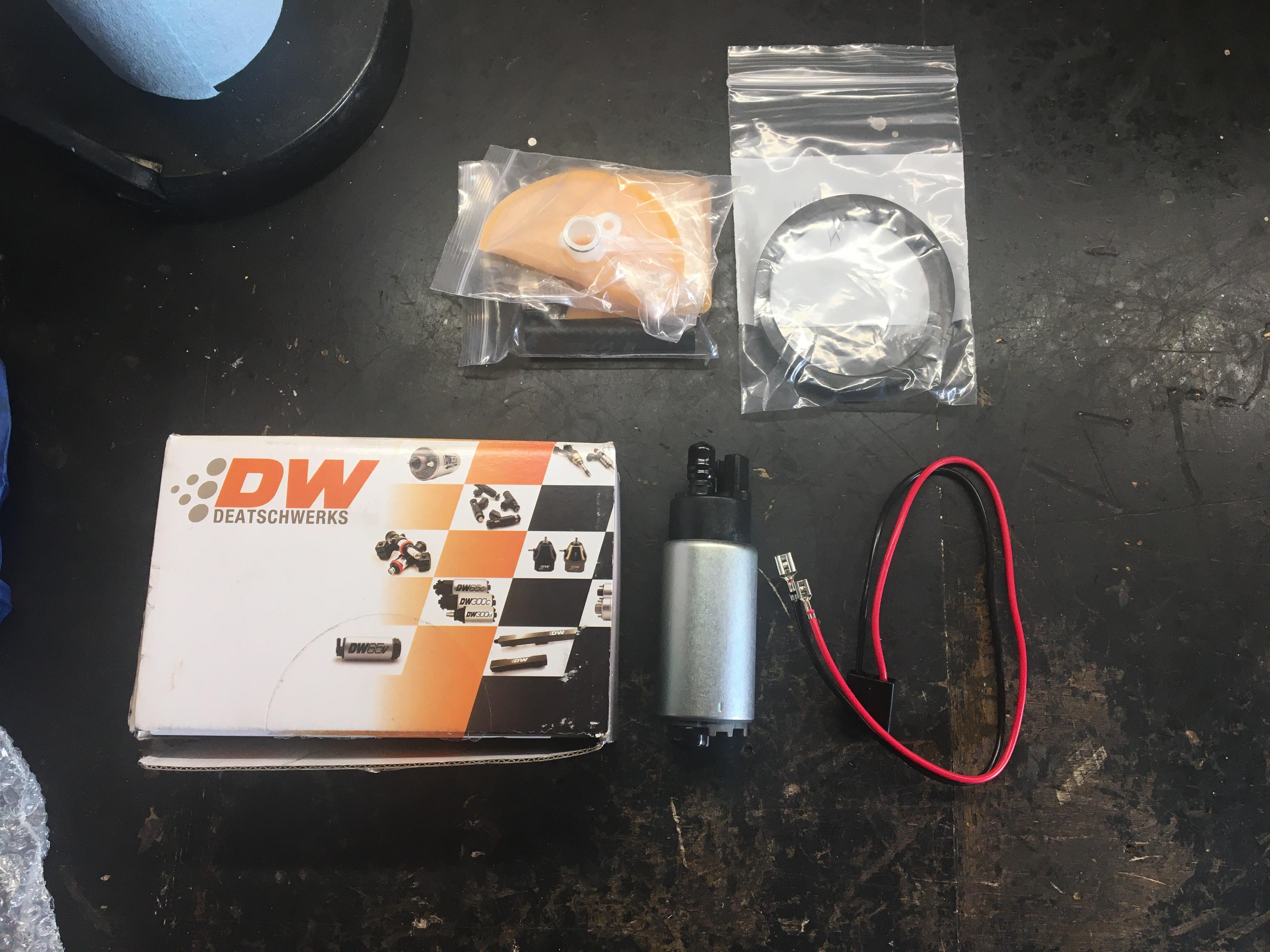

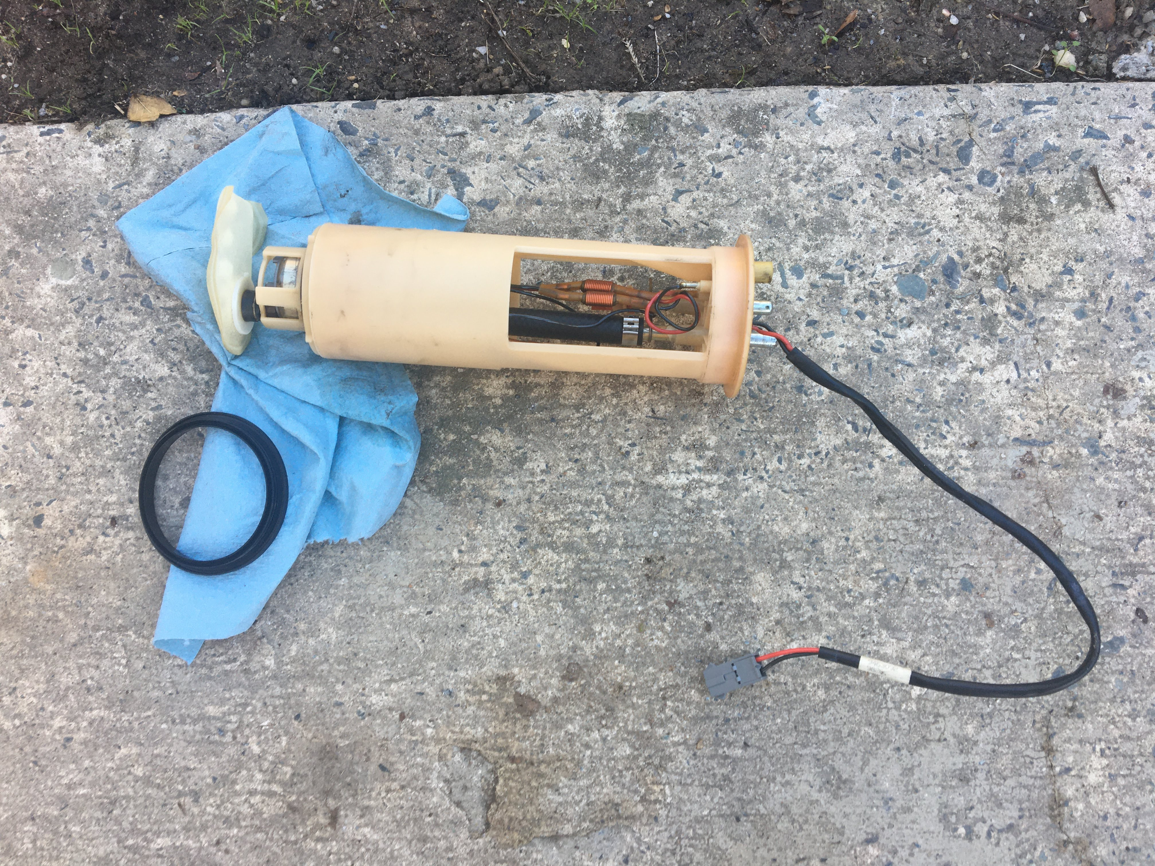

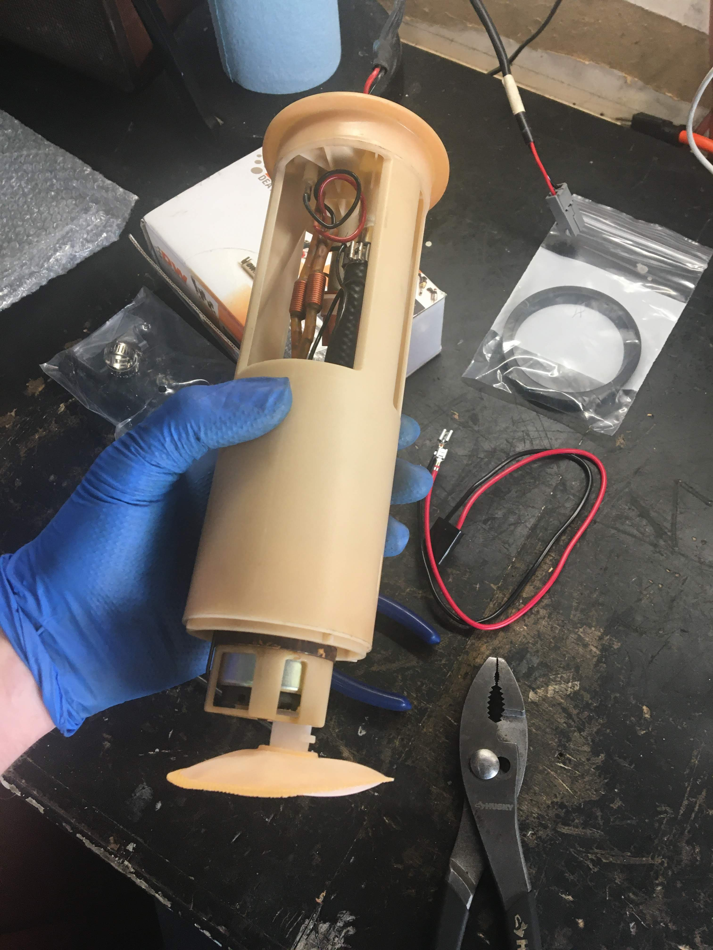

Yesterday was fairly productive. I replaced the fuel pump with the DW200. Very easy install! It uses the same connector as the Bosch 69693, so fortunately no wiring work was required. I found it odd that the pump itself didn't have the "DW200" branding on the body, but it seems to be a real Deatschwerks pump otherwise.
DW200 installed and ready to drop back into the car.

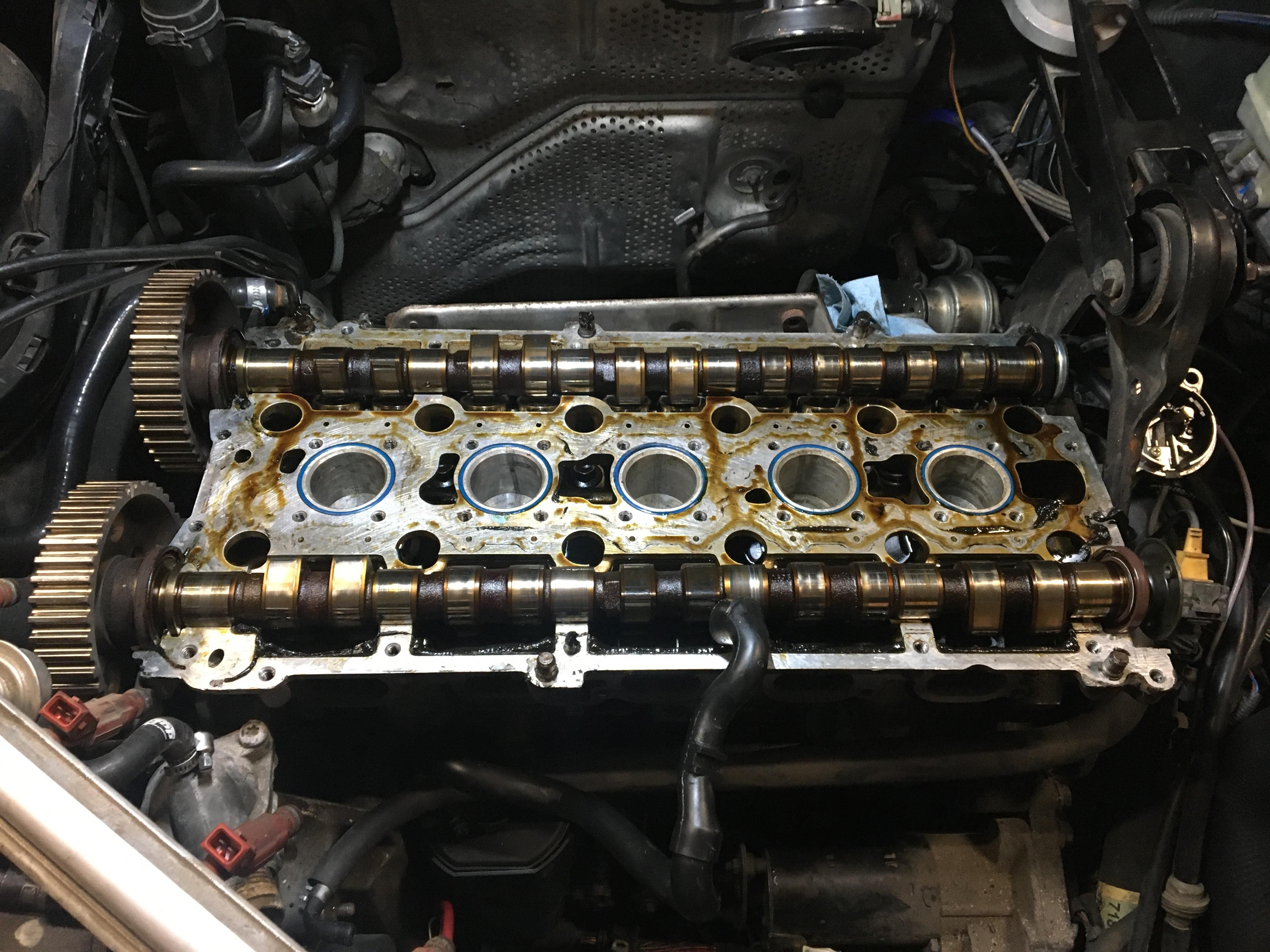

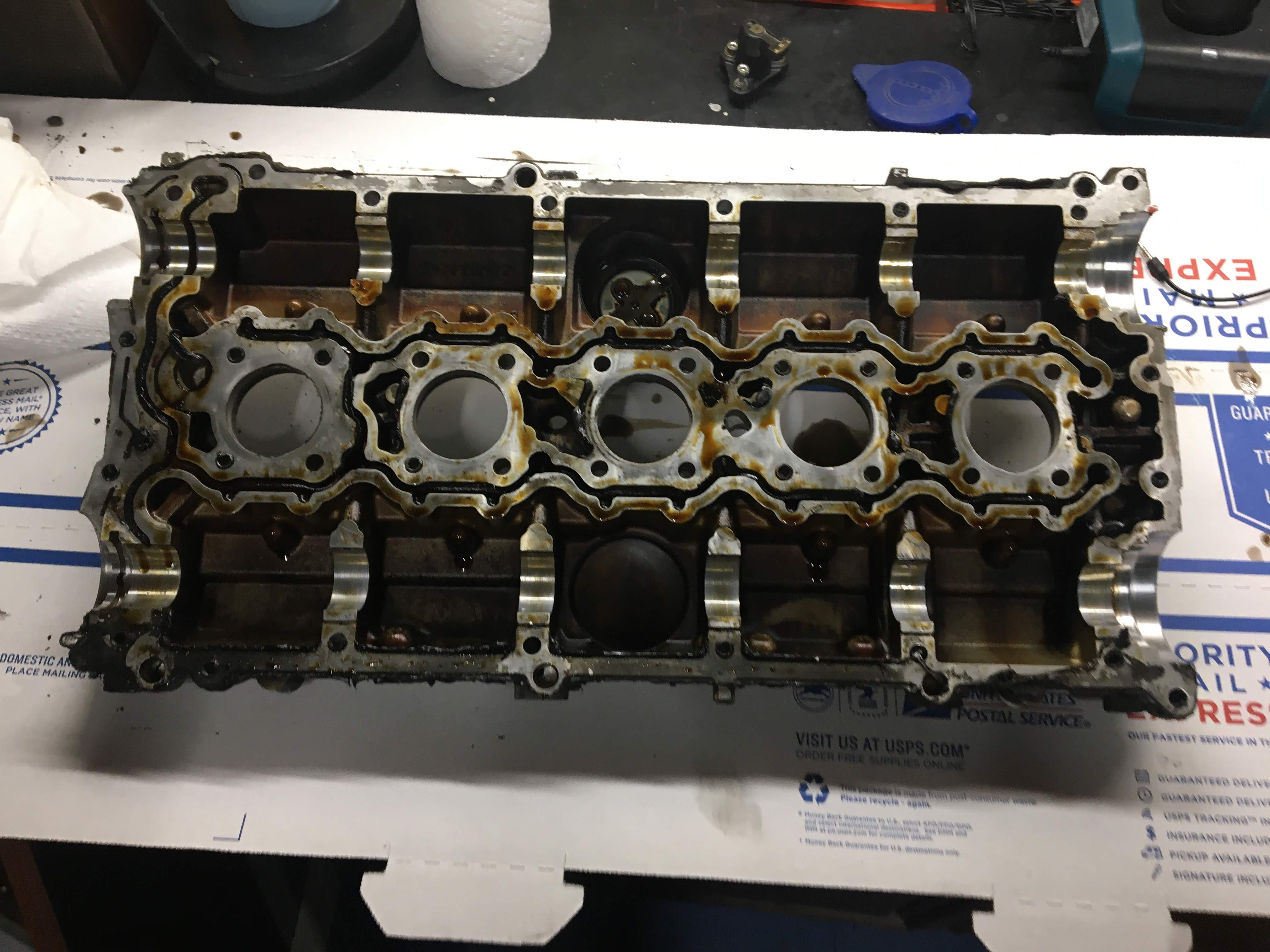

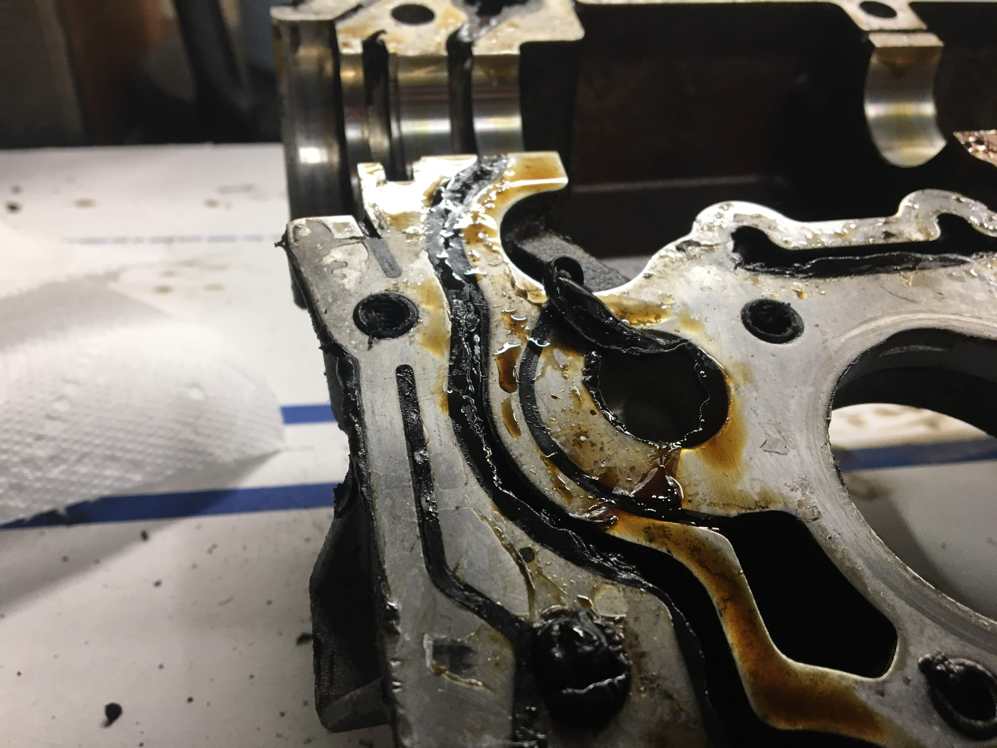

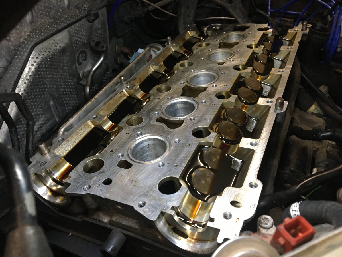

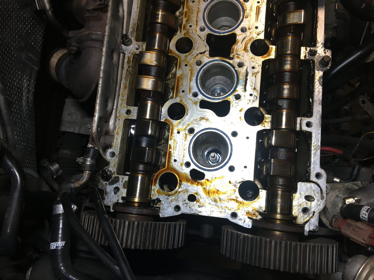

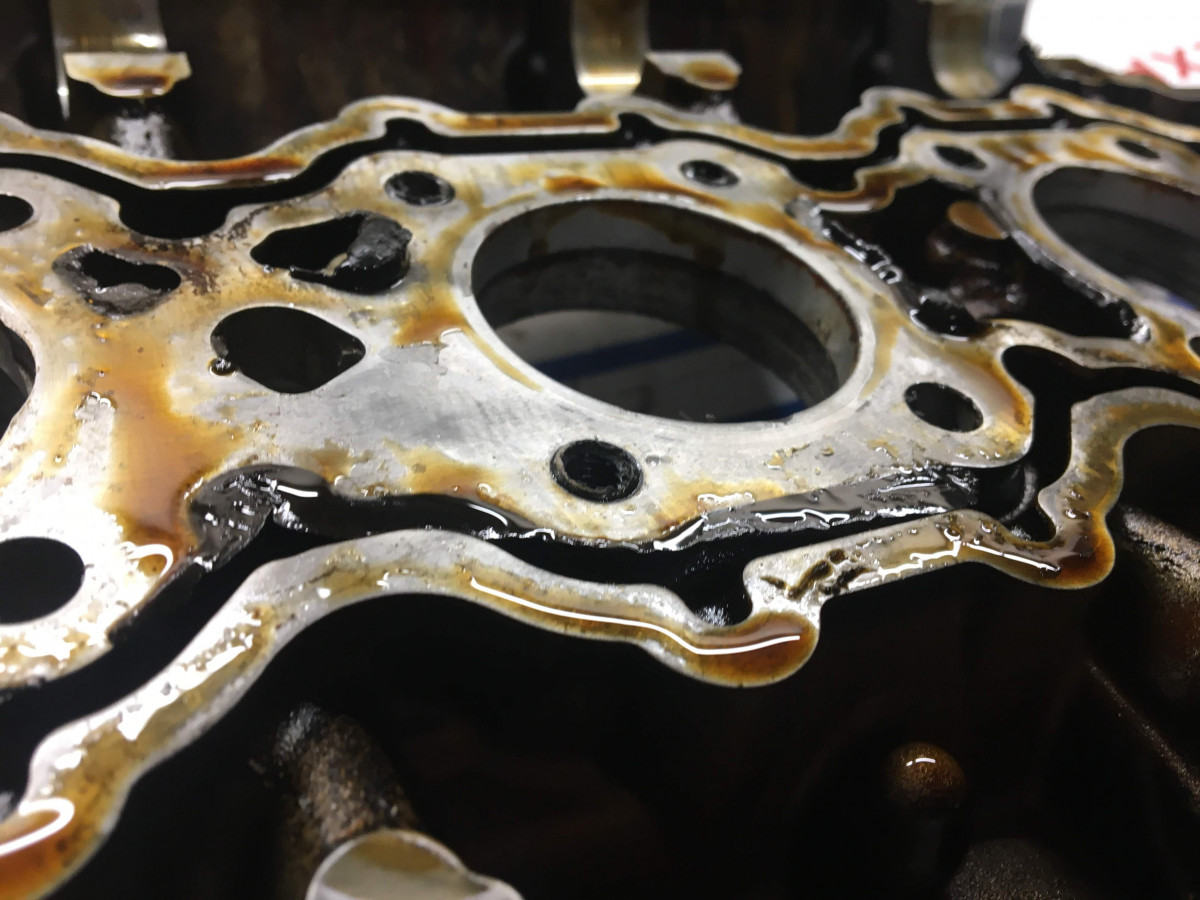

Also pulled the cam cover and cleaned all of the old RTV that the previous owner before me (well, the shop he used) had put on there... two lessons here:
1- NEVER use RTV/silicone sealant on a Volvo cam cover!!!! It will clog the hell out of the oil passages. This is almost certainly why this car occasionally had noisy lifters. Yuck!
2- ALWAYS use the designation "pry points" on the cam cover... NEVER stick a screwdriver between the cover and the cylinder head. See that big screwdriver gouge? Not good!
The cam cover is machined to the head... this isn't something that you're supposed to just swap between engines. That's why you can use anaerobic sealant rather than the typical RTV/silicone.
On the other hand, the RTV made it easy to lift the cover right off! Much easier than when I pulled the cam cover from my 2000 S70.
Before cleaning up
Much better!

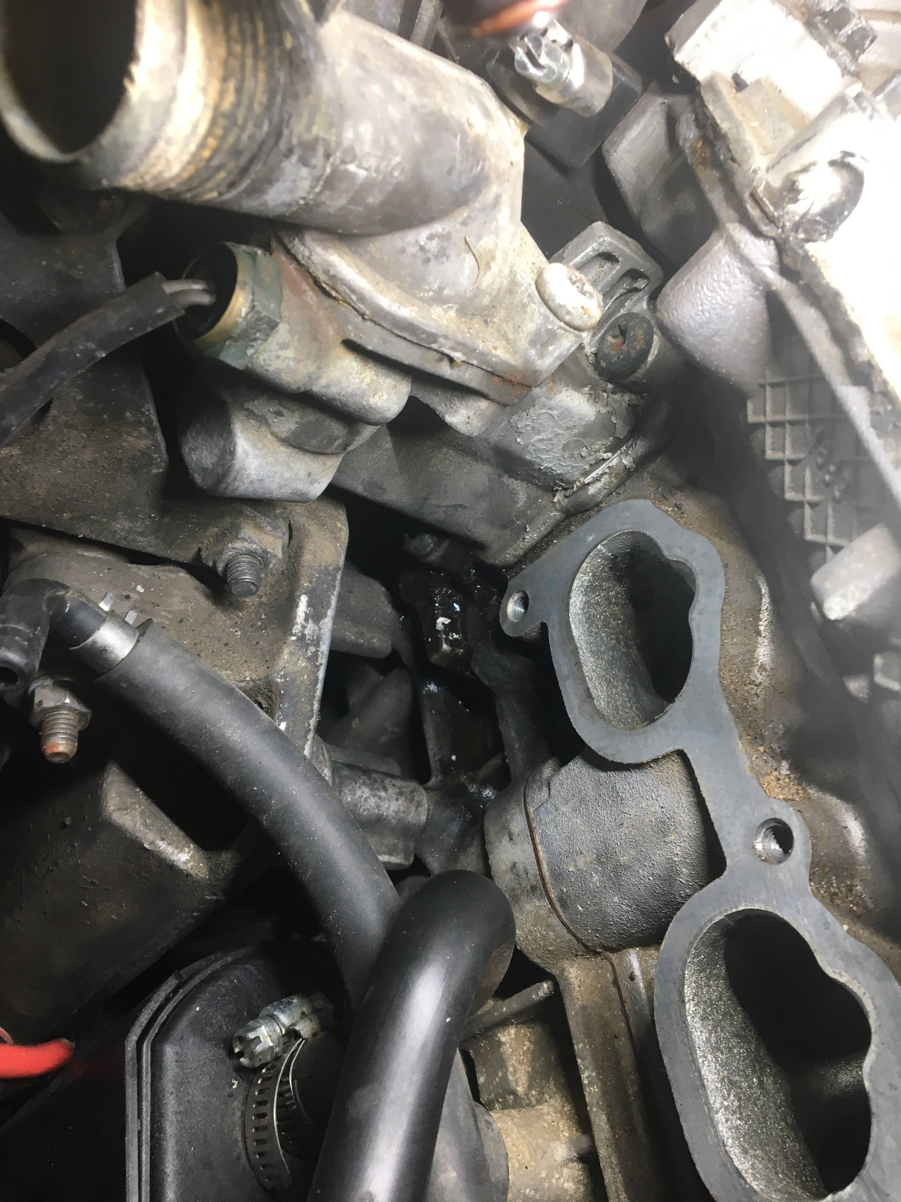

Looks like I should replace the thermostat housing gasket while I'm in here.
Somebody must have sanded the cover or used some sort of abrasive the last time, it was all scratched up. Hopefully that won't affect how it seals.
The M10x1.0 tap should be arriving today from Amazon, so I will drill and tap the intake manifold for the two vacuum barbs, then that will go on. I need to call the dealer and see if I can get the thermostat housing gasket today while the intake is off.

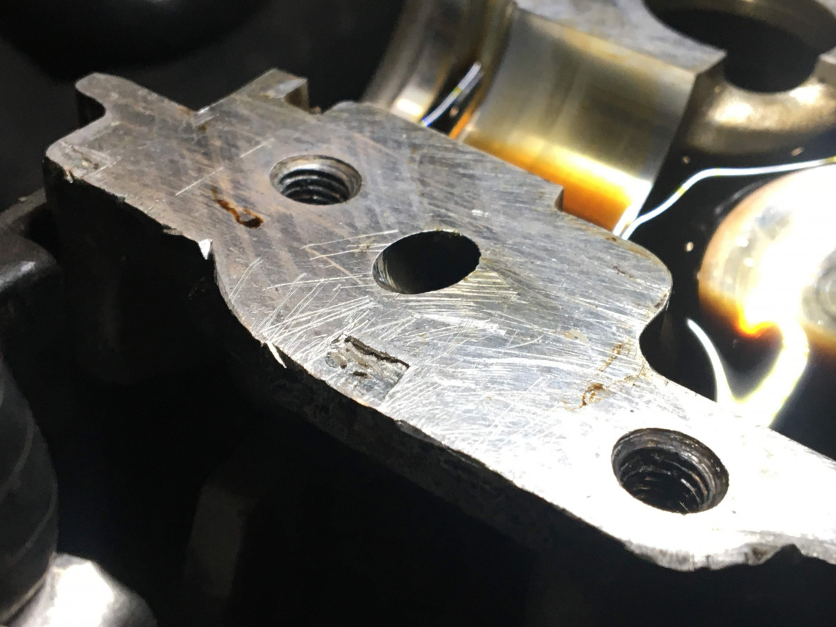

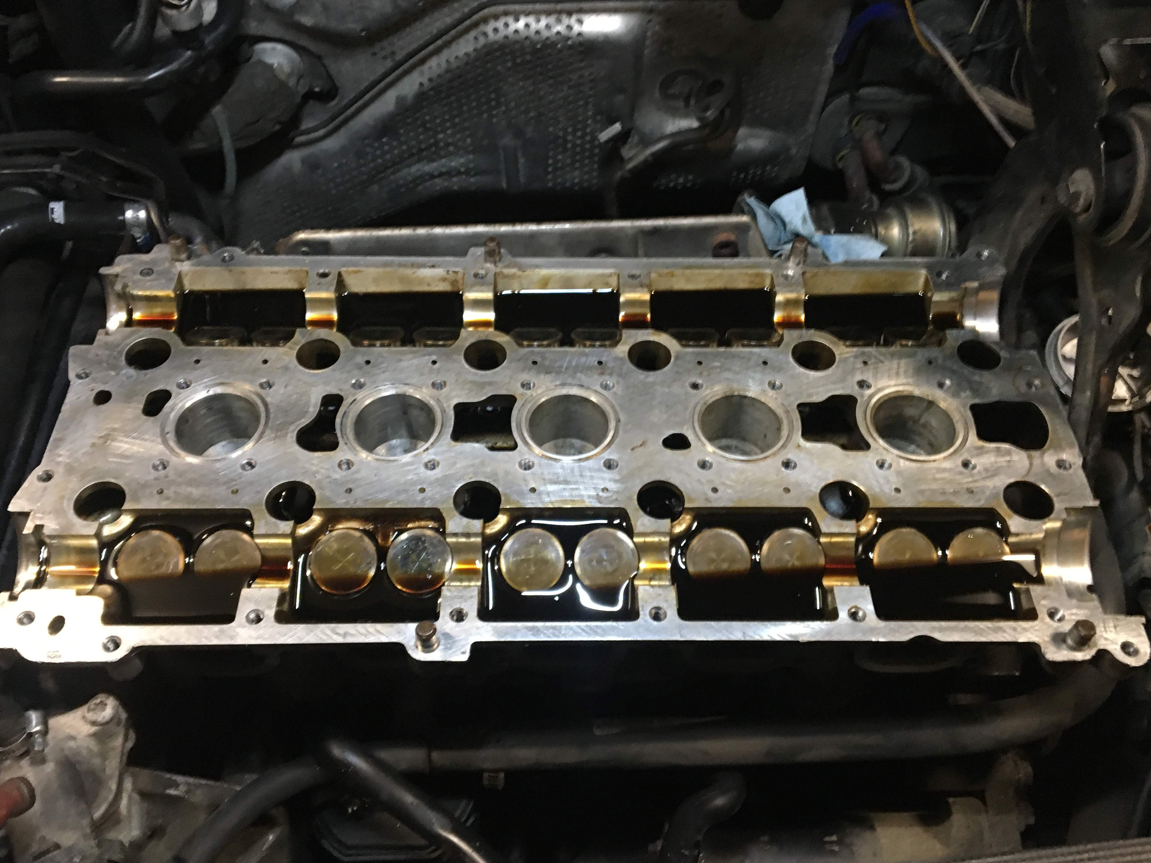

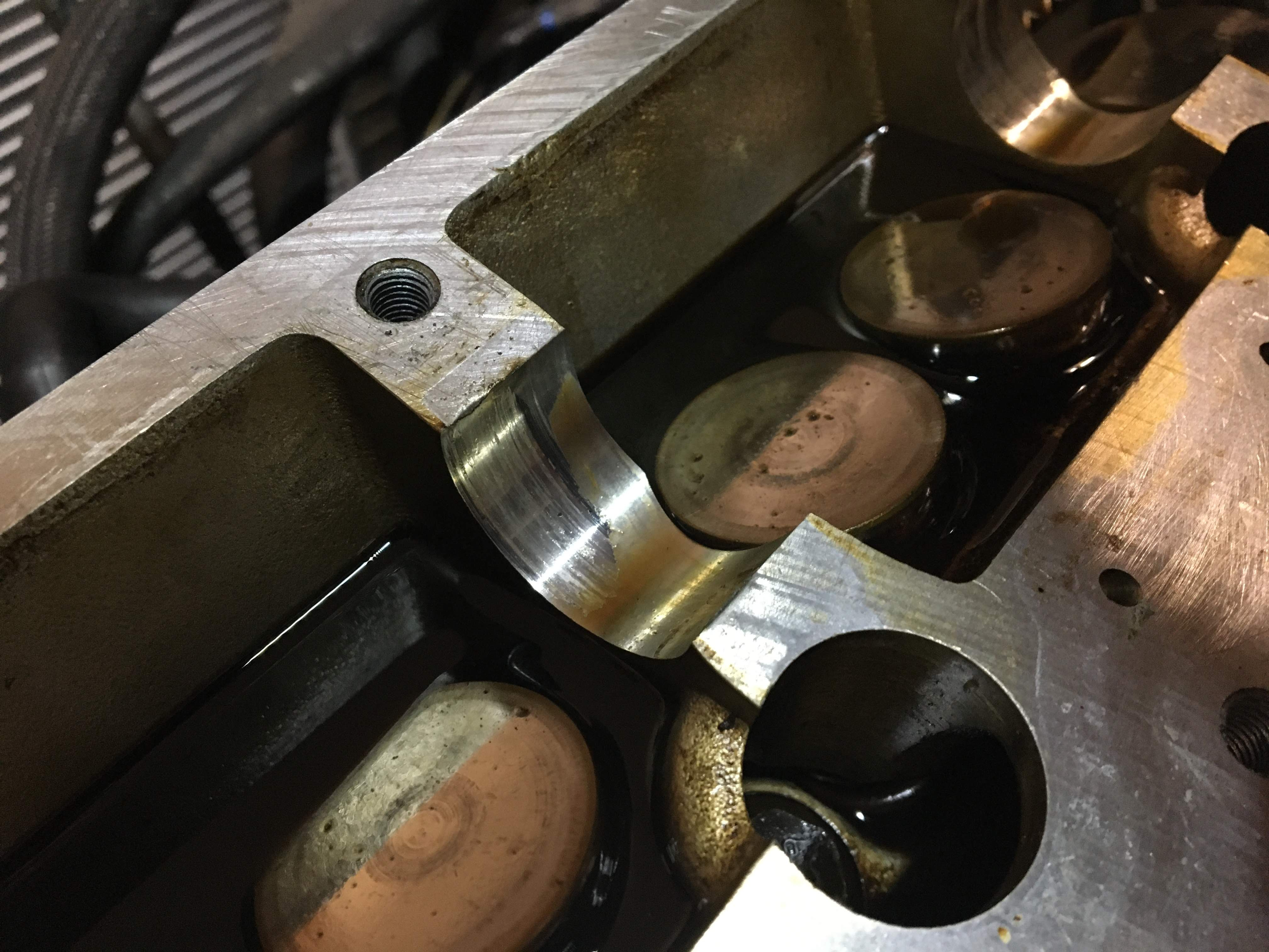

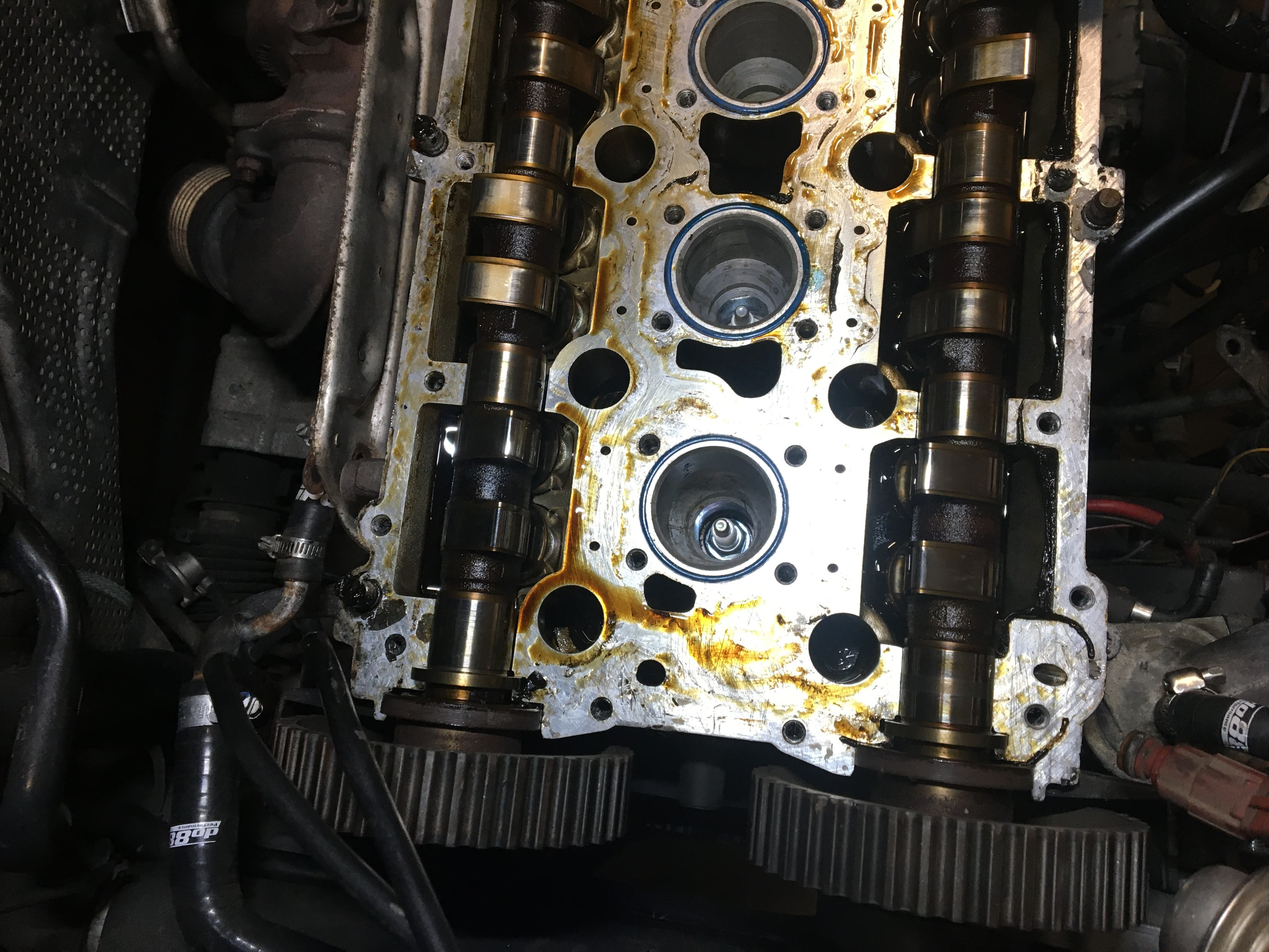

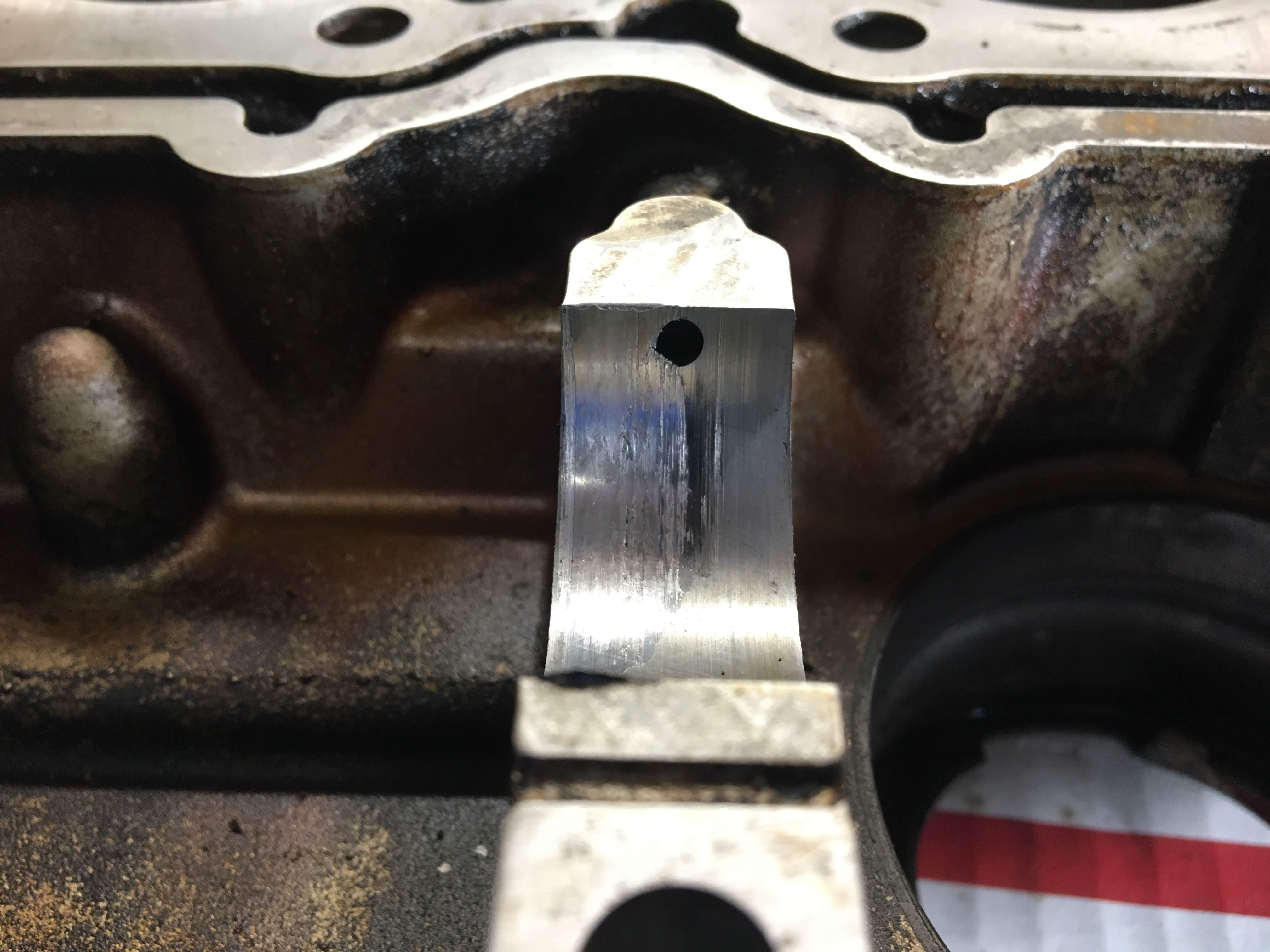

Also made some worrying discoveries... the cam carriers were BADLY scored on the intake side. Hopefully that's not going to be a problem, I'll put it back together for now knowing that it'll need a cylinder head somewhere down the road. I'm not too worried though, it's been fine the past 30k+ miles!
Without a doubt the aftermath of clogged oil passages... once again, DO NOT USE RTV!!!
