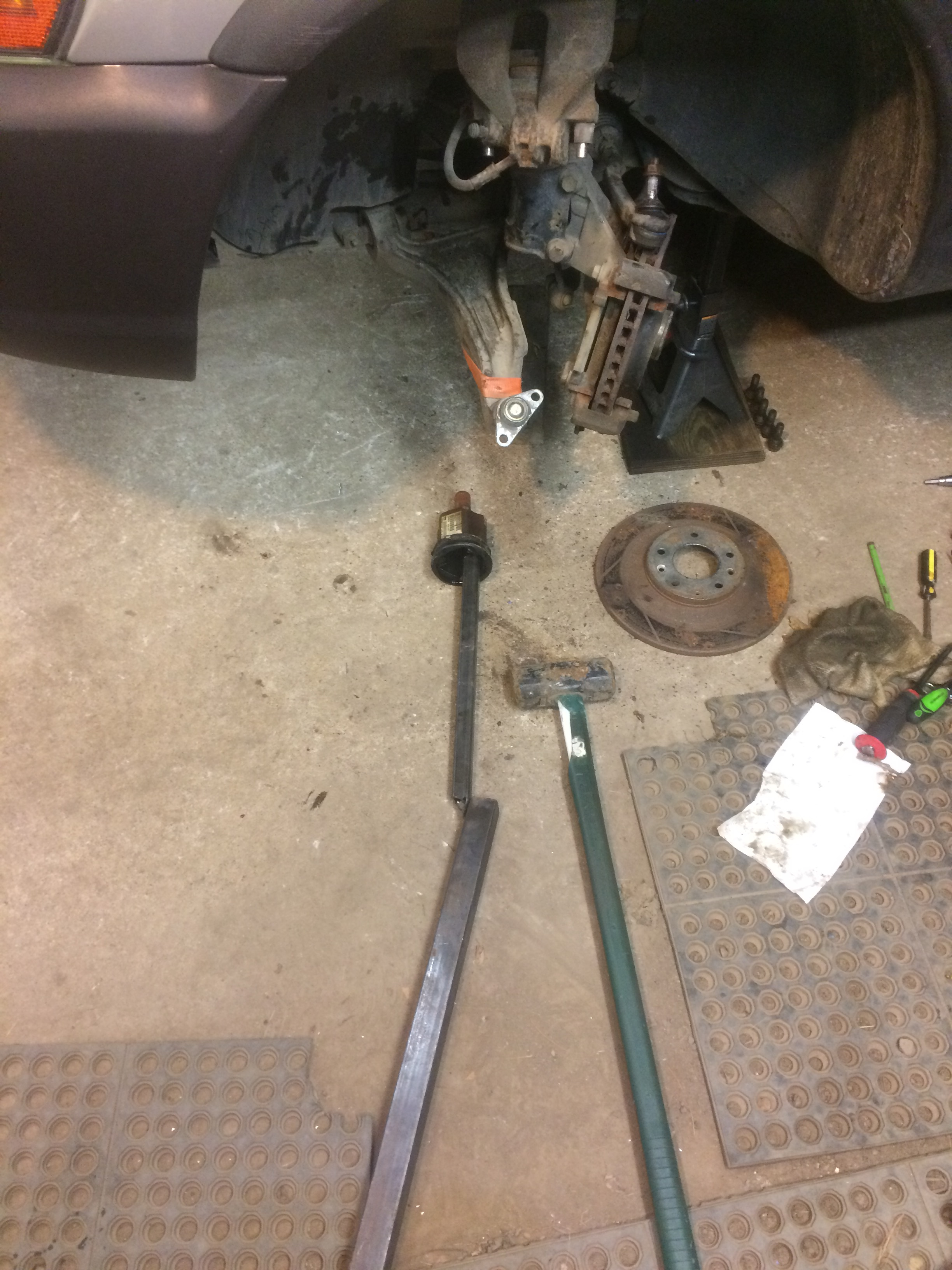

Yeah it sure puckers you up good & tight the first few attempts. The relief that follows once it pops out is euphoric.
Did you do the “pry, push back in, turn 1/8, pry, push back in, turn 1/8...etc” method?
I’ve had success both ways, prying & striking the inner CV joint. The worst P2 I did was the drivers side on our 04 XC70 several years ago. I actually had to remove the inner boot (I just yanked on the half shaft so hard it tore), then drill a hole through the inner CV joint housing, bolt a steel bar to it & then used an old brake rotor combined with the steel bar as a “slide hammer”. I had welded a plate on the end of the steel bar so when I would slide the brake rotor out it would hit the plate & act as a slide hammer on the other end. Hopefully you don’t have to go that far, but if you’re replacing the half shaft at least you don’t have to worry about trashing the original.
There is no accessing the retaining clip. You can try bathing the area where the splined shaft goes into the trans, but I doubt the spray lube will travel all the way in to the clip.
Edit, looks like I may have used a maul in addition to the brake rotor. Also, I can't think of a time I've ever spent less than 73 seconds removing a drivers side CV axle. Maybe Steve's French is more persuasive than mine?
