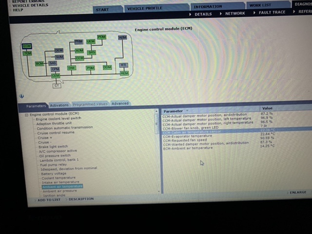

Yesterday I was able to work a little on the car;
-Installed a new cabin filter and verified function of the blower. Seems okay based on the amount of airflow.
-Removed the ccm and verified the fan of the cabin temperature sensor is running( left electric connections in place)
-the air flow through vents reduces greatly when the flow to windshield is activated. While the flow coming from these vents is small.
- the heat has improved, not sure what contributed, but still not great.
-Calibrated the Ccm with Vida.
-Did the read out in Vida and the cabin air temperature rises quickly. Which leads me to believe this may be the root cause of this problem. Attached 2 screen shots from Vida, showing cabin temperature at max.

90 degrees C, as it should while idling on my drive way.
