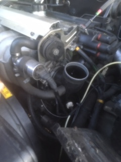

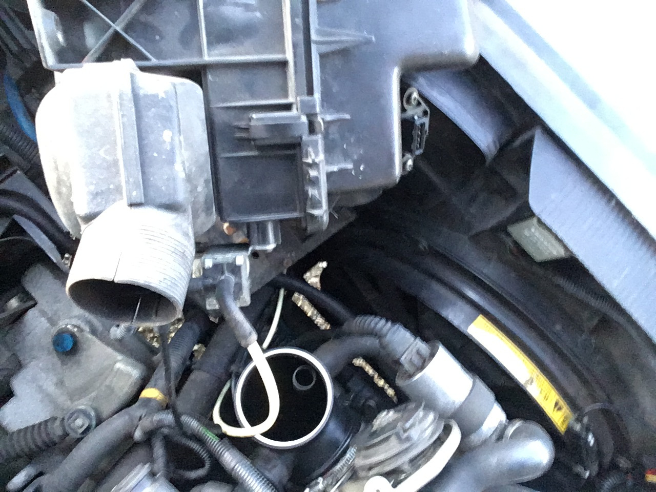

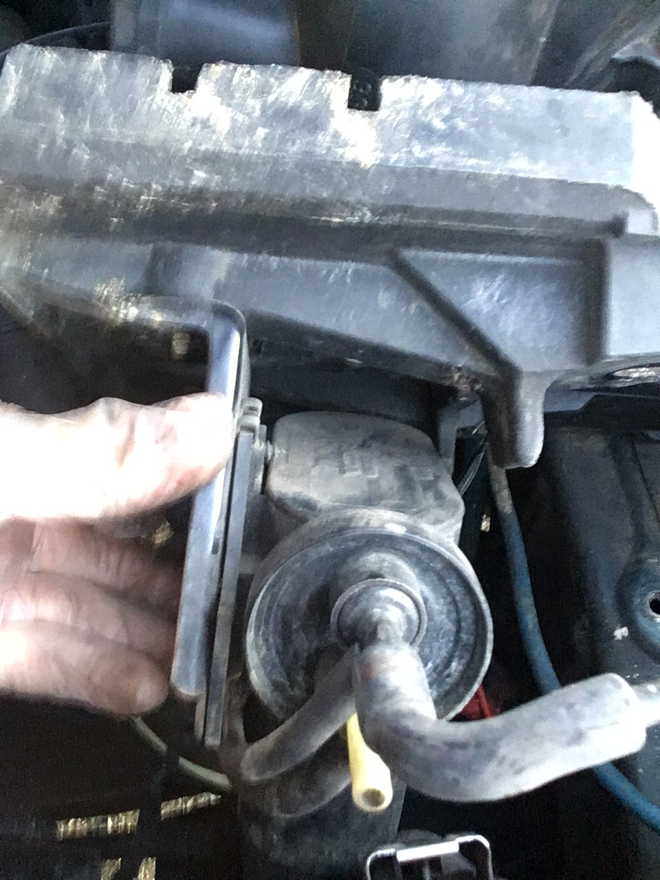

These are photos from my vehicle. Every time i pass a volvo driving down the road Im thinking ill ask them to pull over and look at their vacuum lines. haha
No lines running up towards underneath the hood latch/in front of the radiator like i saw in other posts.
Again i have three lines running south towards the bottom of the vehicle. I think those are correct, however there may not be enough of them. There are exposed nipples
on the object in the photo and down there as well. Still looking for that item labelled "vacuum tank"
