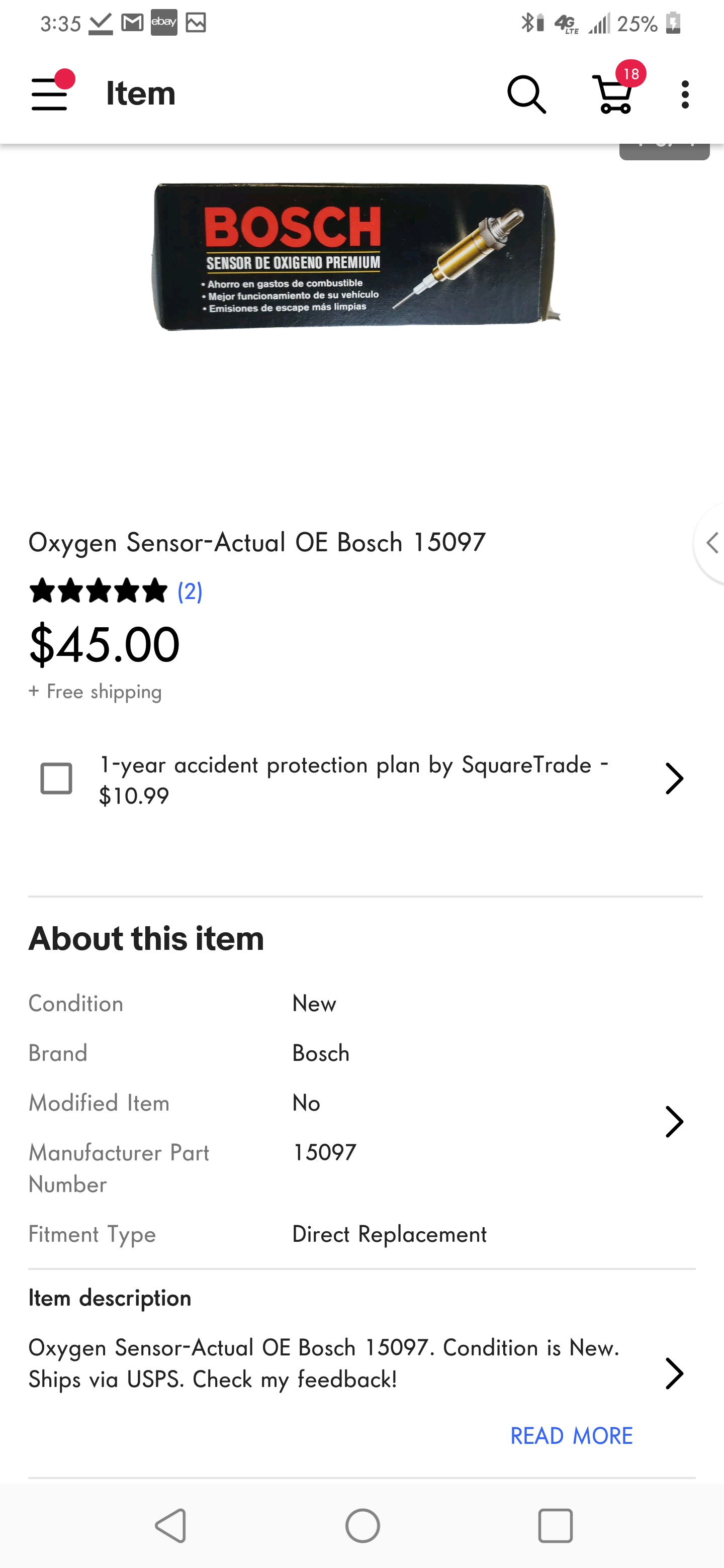

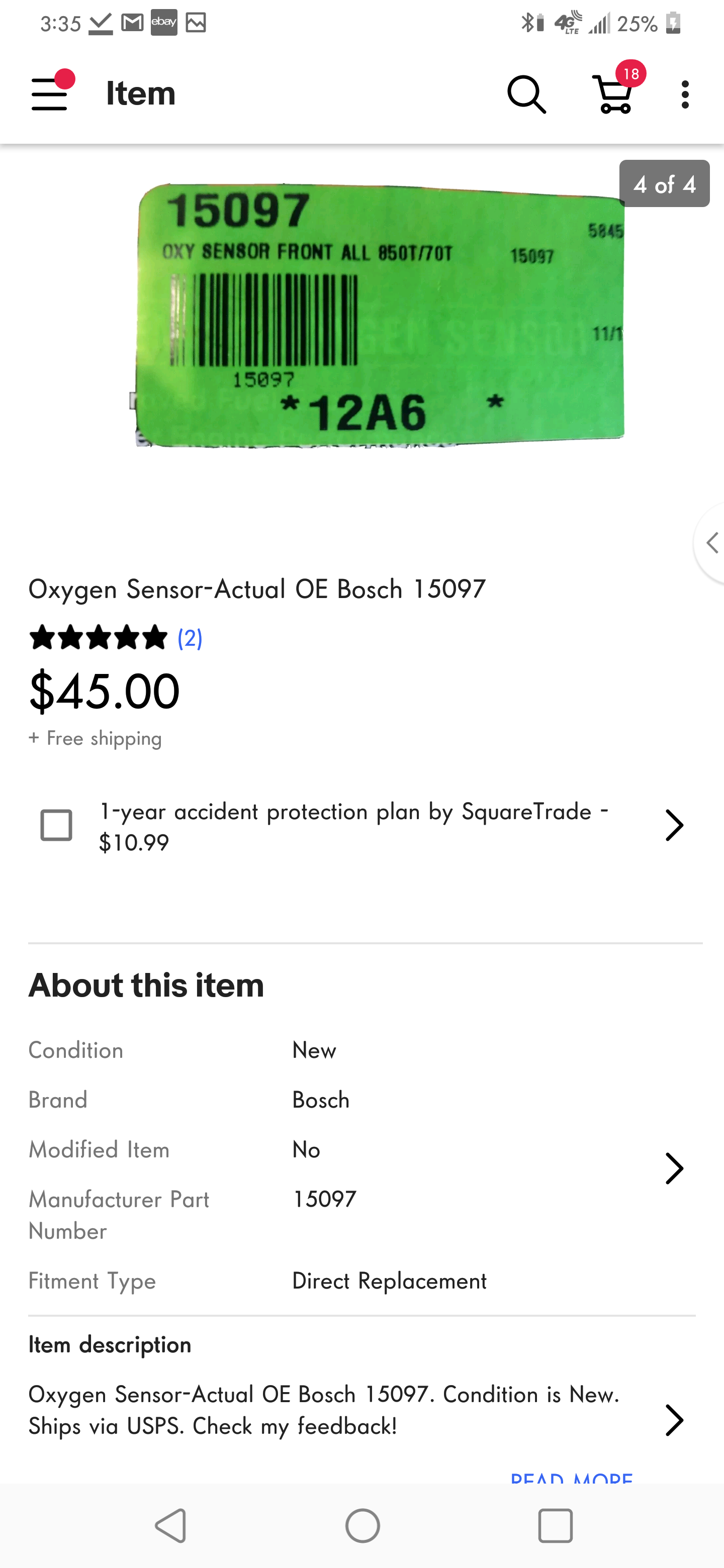

Can y'all please tell me if this looks like a real Bosch product/O2 sensor?

Bosch 15097 = Volvo part number 9202719, You might had fitment problems on the wire length.
Bosch 15062 = Volvo Part number 9202720, Chassis -409465.
Bosch 15063 = Volvo Part number 0202621, Chassis 409465-.

I'm not sure what Rick is getting at. Bosch 15097 is exactly what you want for the front O2 and will fit, the wire is the correct length.
As for your actual question ... I can't tell. The only way to be sure is to know and trust the buyer. You just can't tell by looking at the sensor or the packaging if it is a Rupert Busch or a Robert Bosch. RockAuto is the cheapest sure thing I can think of right now, and that's still $73.

Yes the Bosch 15097 is the short upstream for 97-98. He is looking for down stream. Trying to steer him away from the possability of needing extension cables 9202714 or 9202715.erikv11 wrote: 07 Apr 2020, 23:06 I'm not sure what Rick is getting at. Bosch 15097 is exactly what you want for the front O2 and will fit, the wire is the correct length.

You Cant tell a fake OXS from a picture because the seller can use any picture they want in an ad.
If the price is not within 10% of FCP, itβs fake. No one gets a β special eBay dealβ on auto parts wholesale.
