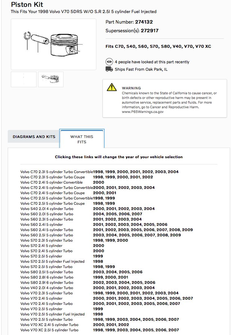

May of found some hope for this engine. Found a local machine shop that charges $94.00 + sleeve. Waiting to hear back on the total cost and if they can do a Volvo 5 cylinder. Their website mentions 5 cylinder but not Volvo specifically. If it can get #3 repaired. About another $300.00 in parts to rebuild the lower end, assuming it does not need some more machining.
Been thinking about replacing the block with another 2.5L RN block. Would be best to locate a block with pistons classifications DDDDE. That would keep the number of replacement pistons down to one. At $150 per piston it would make a difference.

Rick - are the pistons in my 1998 parts car block of any use here?

Unlikely that those will work. The 04-07 R motors B5254T4 had an 83mm bore.abscate wrote: 10 Apr 2020, 06:04 Rick - are the pistons in my 1998 parts car block of any use here?

Ah. the R motor is the killer, otherwise...

The pistons I need are 83 mm forged pistons and where only use in the 2004 - 2007 R engine. Look and at the pictures above. The Volvo part numbers are 274461 (C) , 274462 (D) and 274463 (E). A 274462 (D) is what is in cylinder #3.abscate wrote: 10 Apr 2020, 06:04 Rick - are the pistons in my 1998 parts car block of any use here?
Engine is out, I can strip for less than it costs to bribe a politician, as long as I am at least 500 feet from a school.
Push come to shove, I might be able to make your '98 block work.

I probably wouldn’t bother with an NA block. IMHO, your best bet is to source either a 2003-2004 2.3 T5 motor or 2005+ 2.4 T5 motor. I believe the late 2.3 (B5234T9) has dual VVT as well, so it’s a direct bolt in for the R, possibly with some sensor changes and whatnot.
