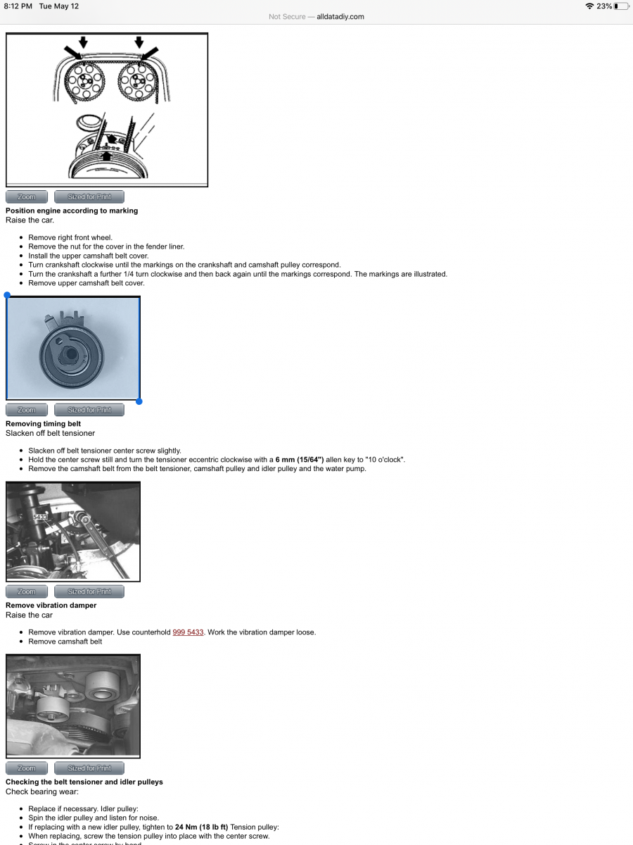

Here is the procedure to set the crank and cam for,belt removal and replacement

If it were a solid cam, you would just grab the sprocket and set it to the mark, then put the belt on. It doesn’t matter which way you turn the sprocket since they have a fixed position to the cam.
With VVT, you do exactly the same thing, except you have to approach the mark from the counterclockwise direction, so that the sprocket is fully ccw in relation to the cam.
As long as the crank is on the mark, you can turn the cams anywhere, Nothing will hit.
- Posts: 36153
- Been thanked: 4068 times
DefinitionsSCP74 wrote: 12 May 2020, 23:33 Fully CCW as in when turn the cam 8 degrees CW the mark would be about 5 min past ?
Still, how can I perform the reloading?
Sprocket...geared part you fit the belt on
Cam - part you can’t see inthe engine.
The sprocket on a VVT car will turn about 16 degrees of cam rotation, or two teeth, without turning the cam.
Correct, when the mark is lined up, if you rotate the sprocket it will be two teeth off
The procedure says you remove/ install the timing belt with the sprocket rotated counterclockwise
With belt off:
Put crank on mark
Put intake cam on mark
Turn exhaust sprocket past markclockwise. By several teeth, like1/4 turn
Then turn sprocket back to mark until it lines up
Install timing belt
Adjust tensioner
Now turn crank two revolutions and confirm all three marks register
Readjust tension.
