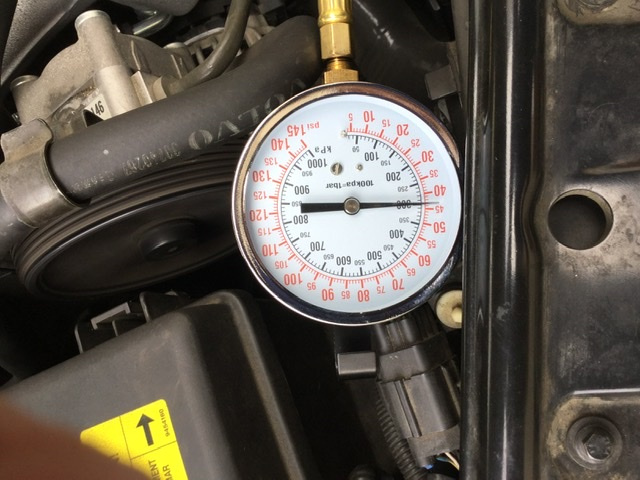

Ordered a CTA fuel pressure gage from Fcp.
Gauge shows 300 kpa & Vida shows 400kpa while idling.
The FPS has been replaced at 175k. Which one is correct?
Vida did not detect any codes.

Gauge is correct. VIDA aid probably calculating pressure based on PEM duty cycle.
Have you opened up PEM and had a look inside ?
