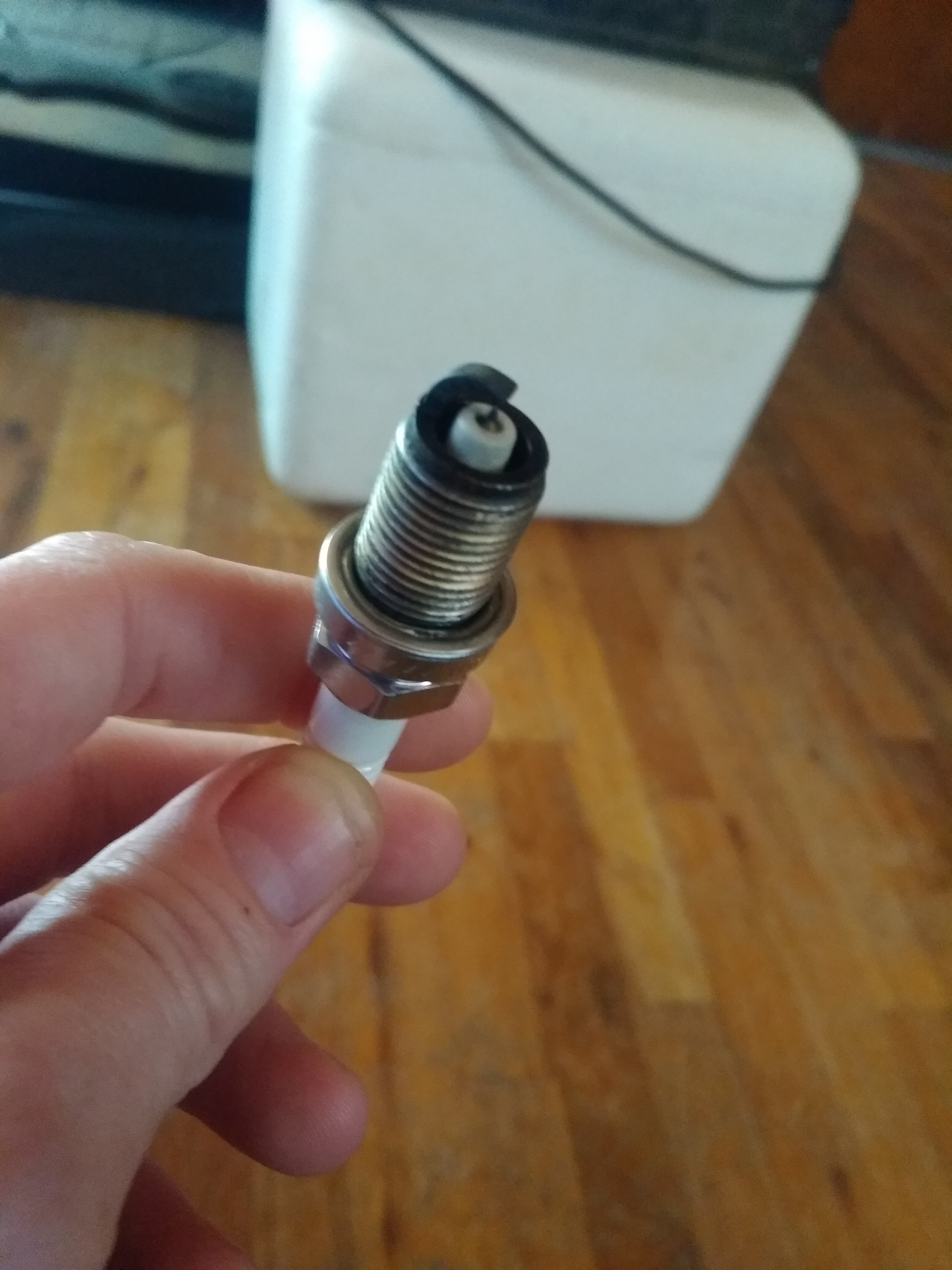

here is a better picture.

Are these not the exact same thing ashttps://www.fcpeuro.com/products/volvo-spark-plug-bosch-fr7dpp the OEM Volvo plugs minus the Volvo badge,the part numbers look the same.

yes, I posted that back on the first page of this thread.subzerocarfanatic wrote: 04 Jul 2020, 12:33 Are these not the exact same thing ashttps://www.fcpeuro.com/products/volvo-spark-plug-bosch-fr7dpp the OEM Volvo plugs minus the Volvo badge,the part numbers look the same.
