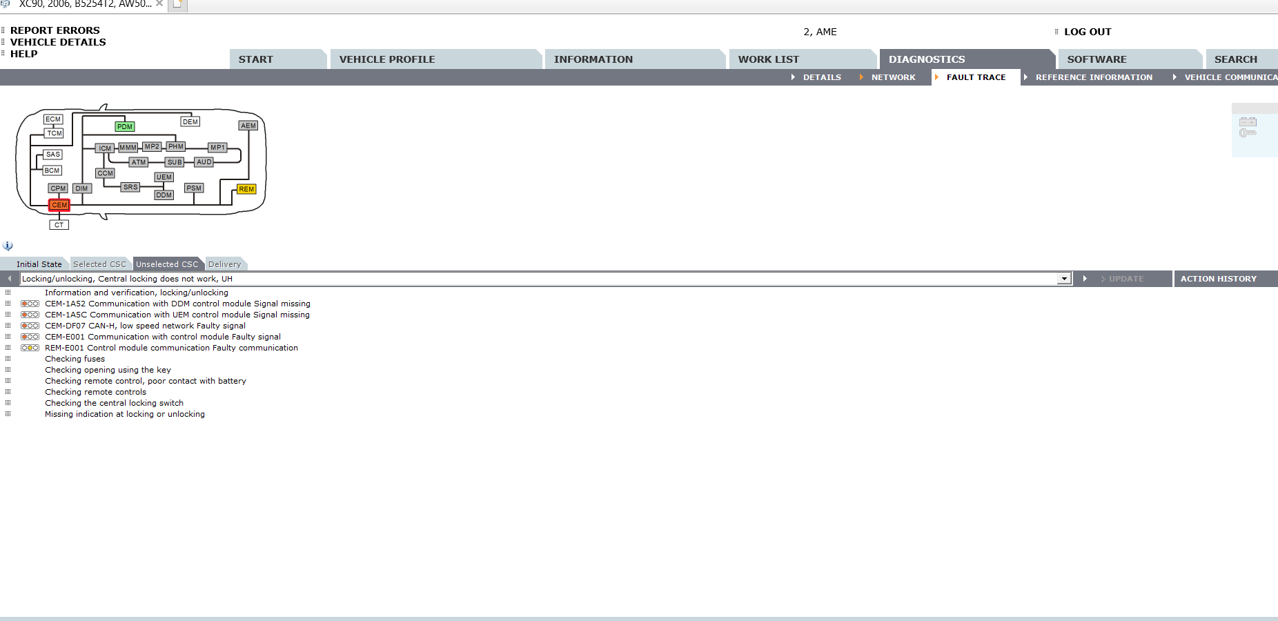

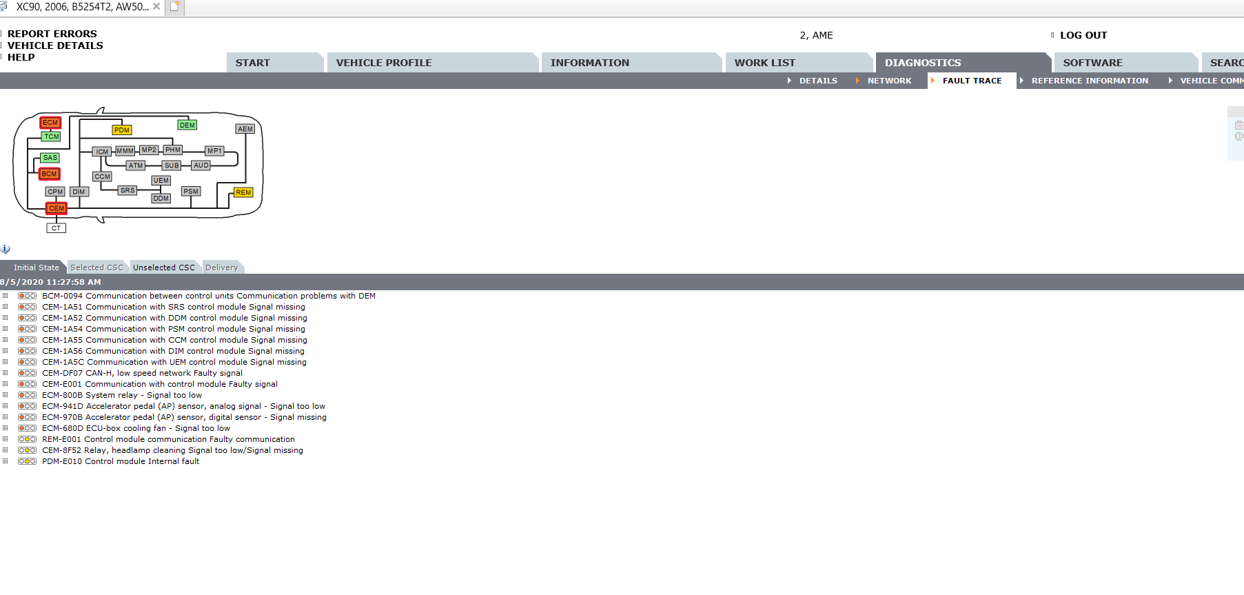

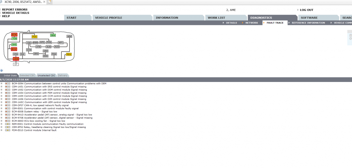

Attaching most recent scan fwiw...
Dash dead / Windows won’t open Topic is solved
