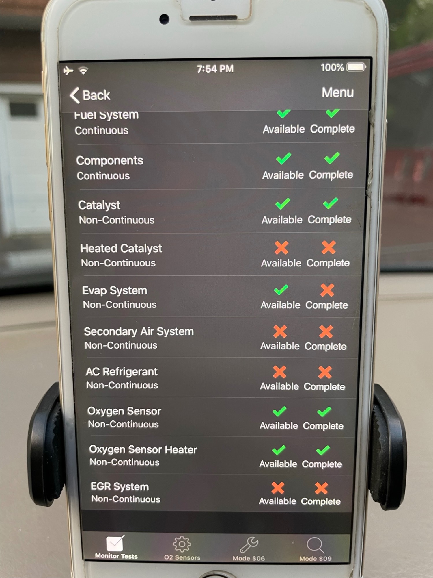

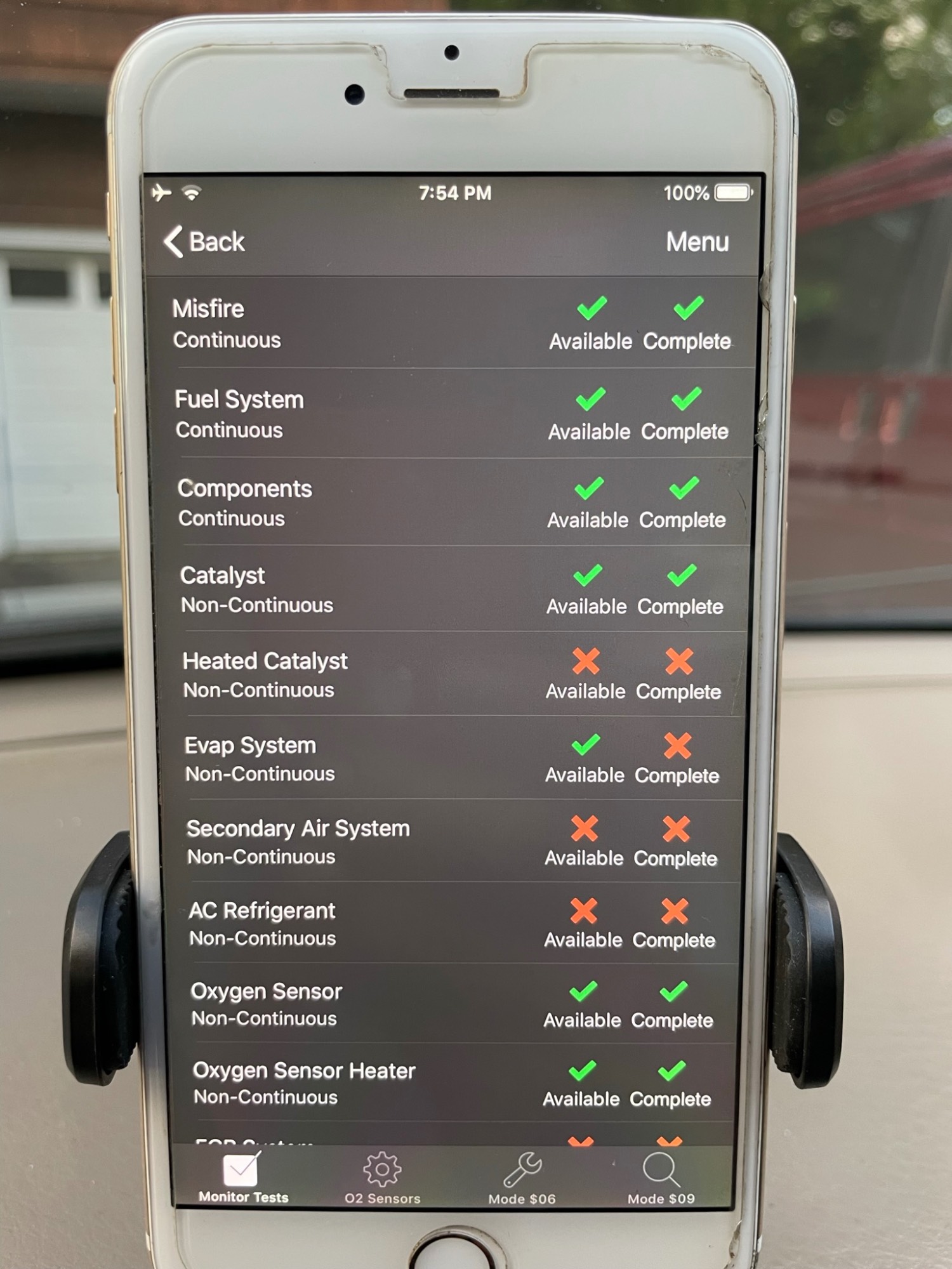

Update on my 1999 NA DENSO equipped V70 Shagg
I just drove around for 20 miles on country roads. No AC, 35-50 mph, no full throttle, smooth and slow on throttle application
Misfire, components, fuel and cat, heated OXS continous, cat continous go ready almost immediately.
Cat amd OXS non- continous took 20 miles
Evap still not set, I have a bit too much fuel in the tank.
Awesome yard art!
Awesome yard art!

Thanks.
What app is that? It looks like it is running on an iPhone… Would be useful. Most of the OBD2 apps that I’ve come across are for android only.
- Posts: 36147
CHeck your PMs and Ill share the app on phone.jreed wrote: 30 Jul 2022, 05:54 Thanks.
The small OBD dongle is a bit pricy but it travels with me and has paid for itself 5x so far
OBDLink MX+
Model MX201
