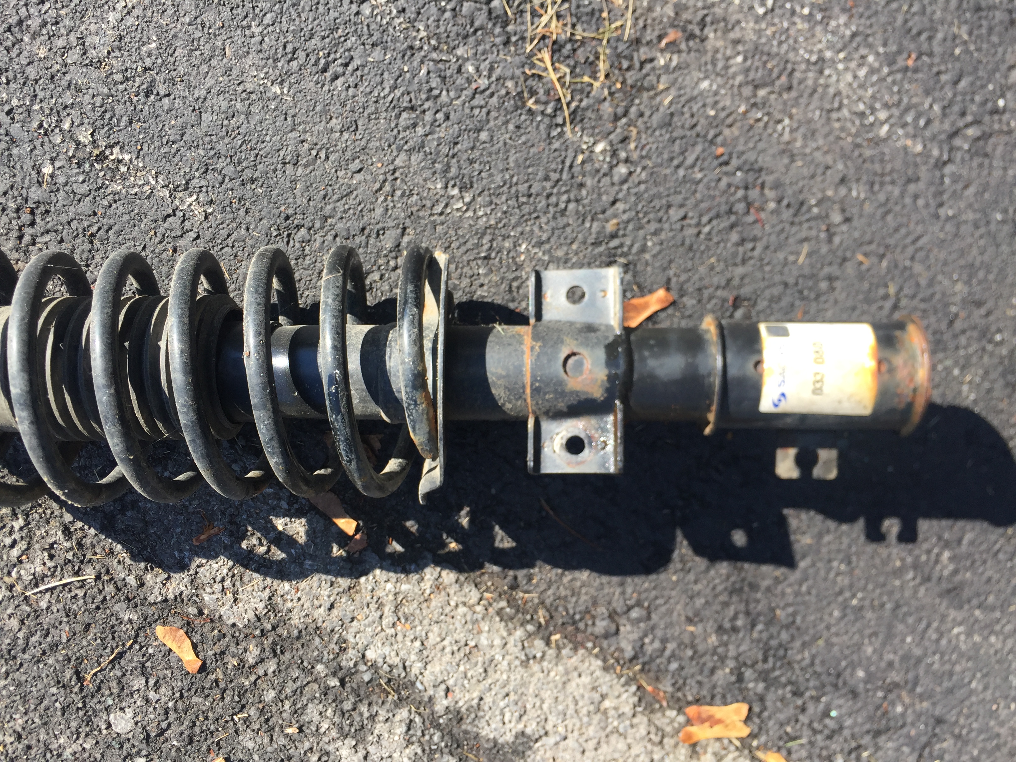

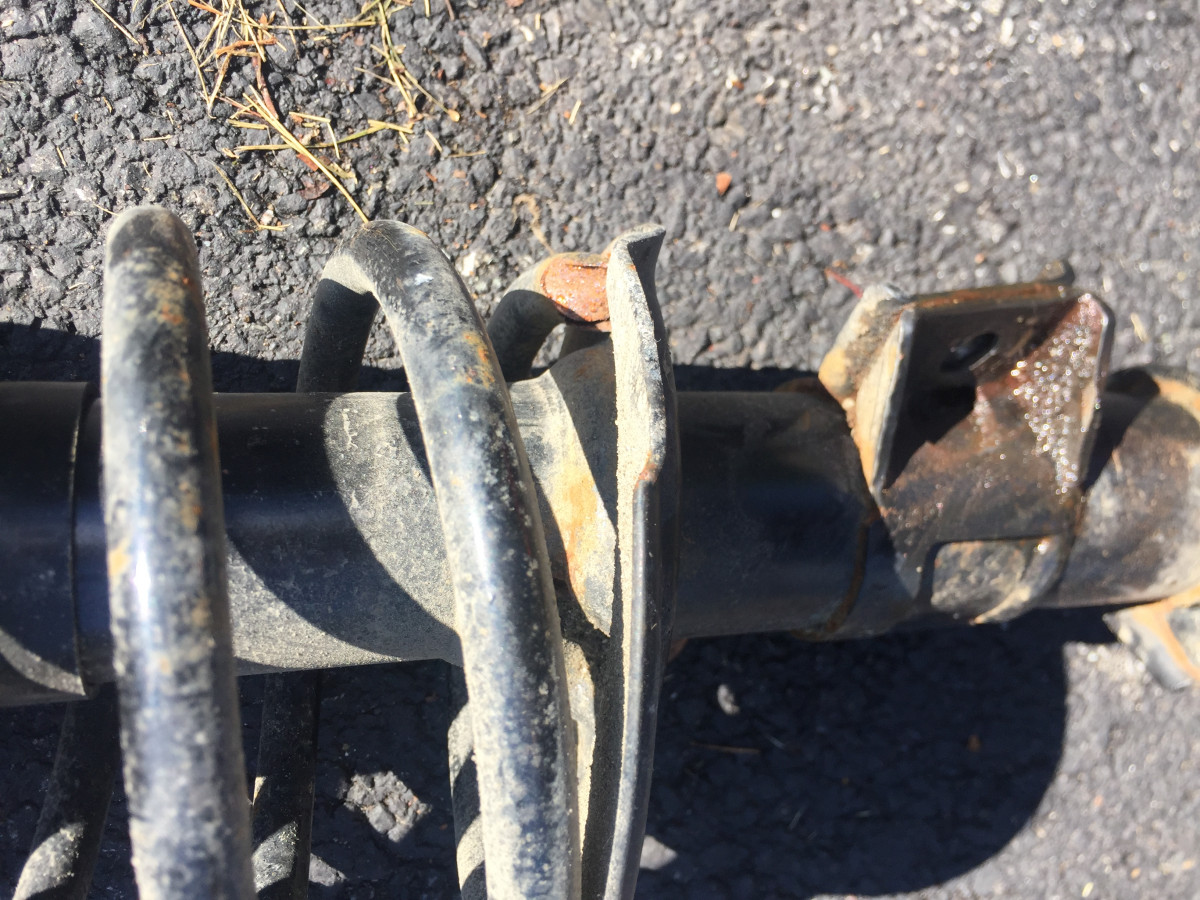

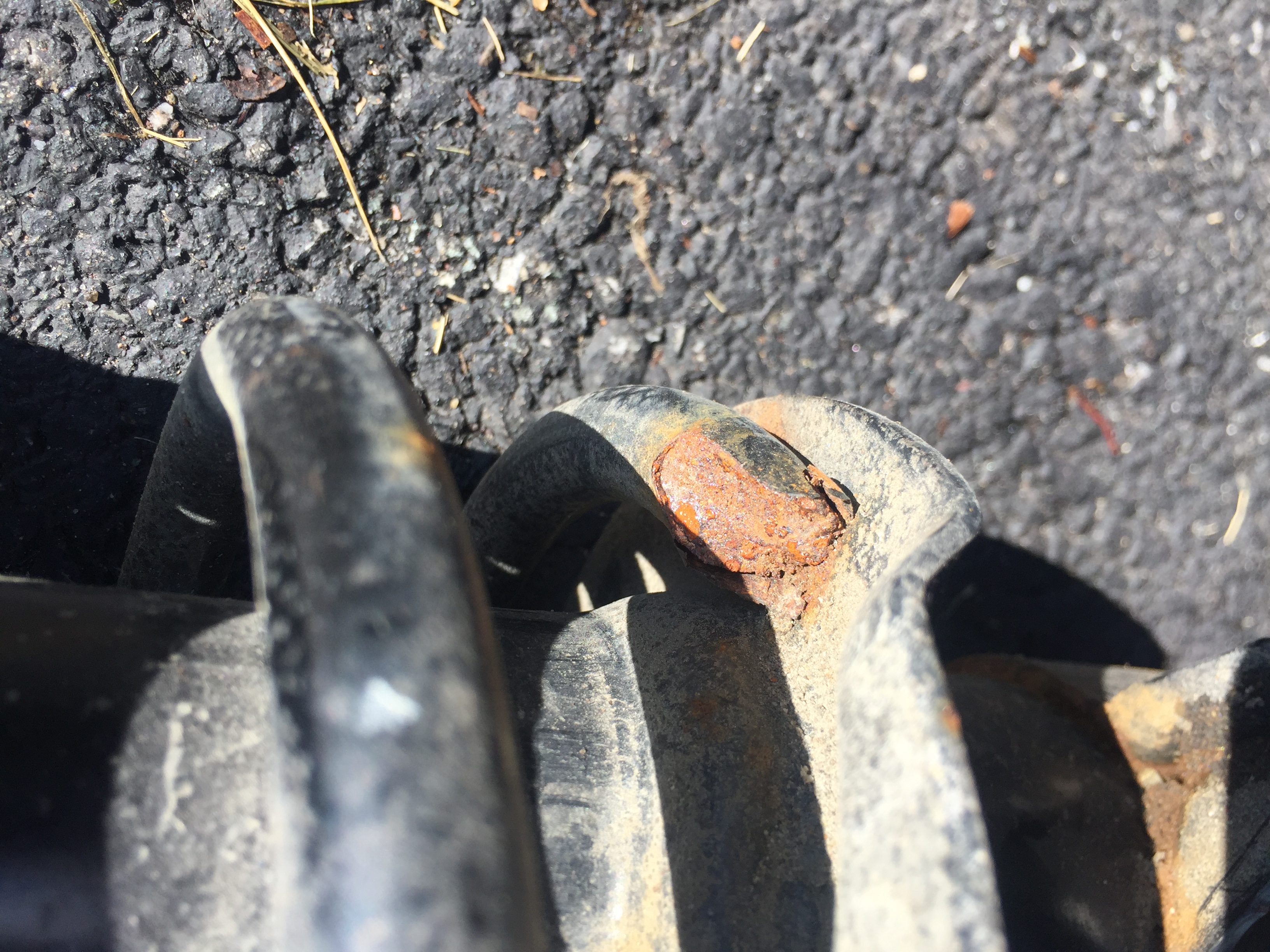

The supplier of the springs should agree to replace the springs. They should also want to obtain the springs and test for hardness in the area of the break. They should also want to test the spring material for steel additives percentages. Their internal heat treatment specifications should have hardness range that is suitable for strength and life before failure. Springs are not rocket science, but this has gone horribly wrong.
Did the breaks occur at the contact of the spring seats? There should also be no roughness on the surface of the spring material.

Wow that looks like a quick brittle failure. I wonder if they were supposed to be shot peened and were not or maybe not heat treated properly

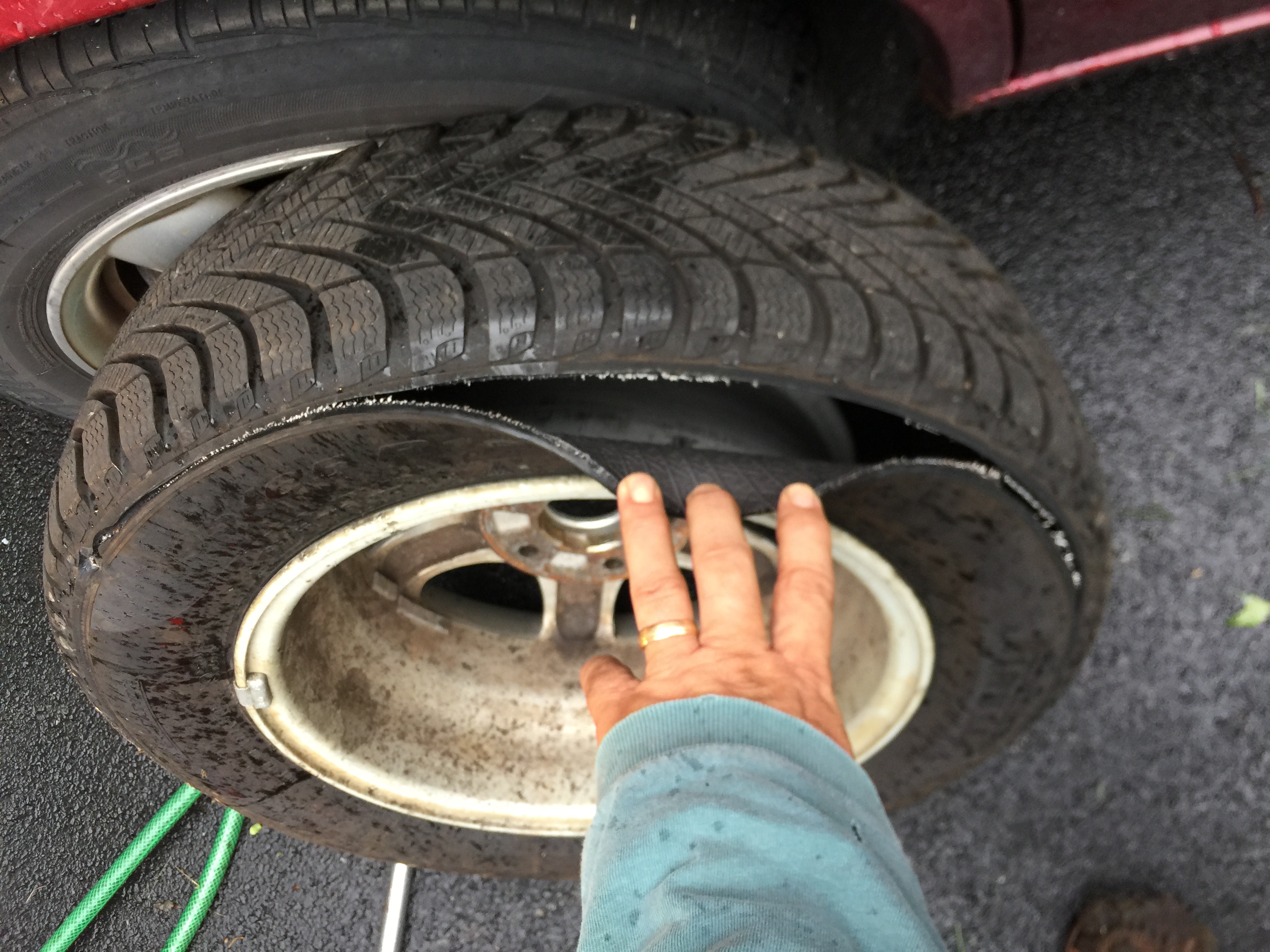

Sorry that this happened. I saw an image of the like-new Pirelli, opened up like a gutted fish. Not pretty.

Second strut had same failure as first. Lower spring coil had fracture and corrosion failure.
Gutted tire. Yikes

That is a serious rent in that tire!
