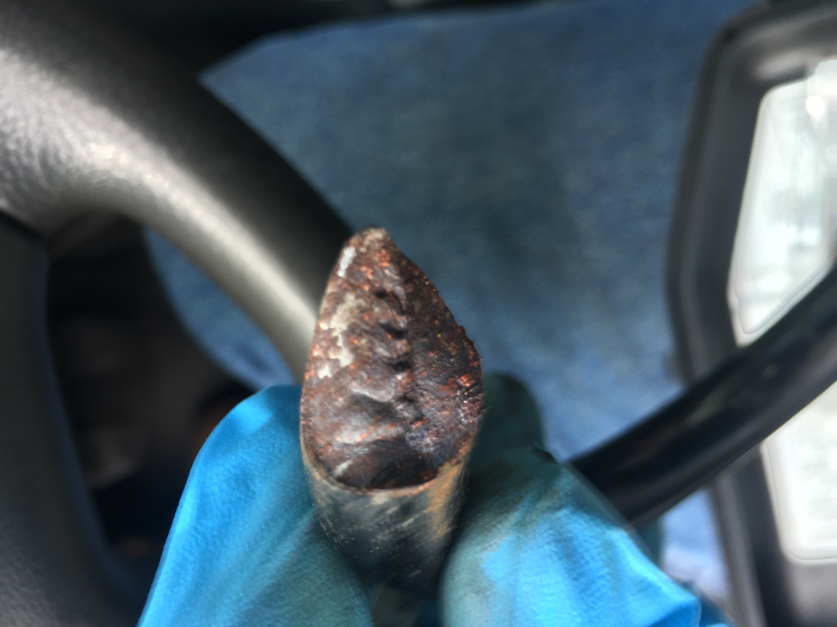

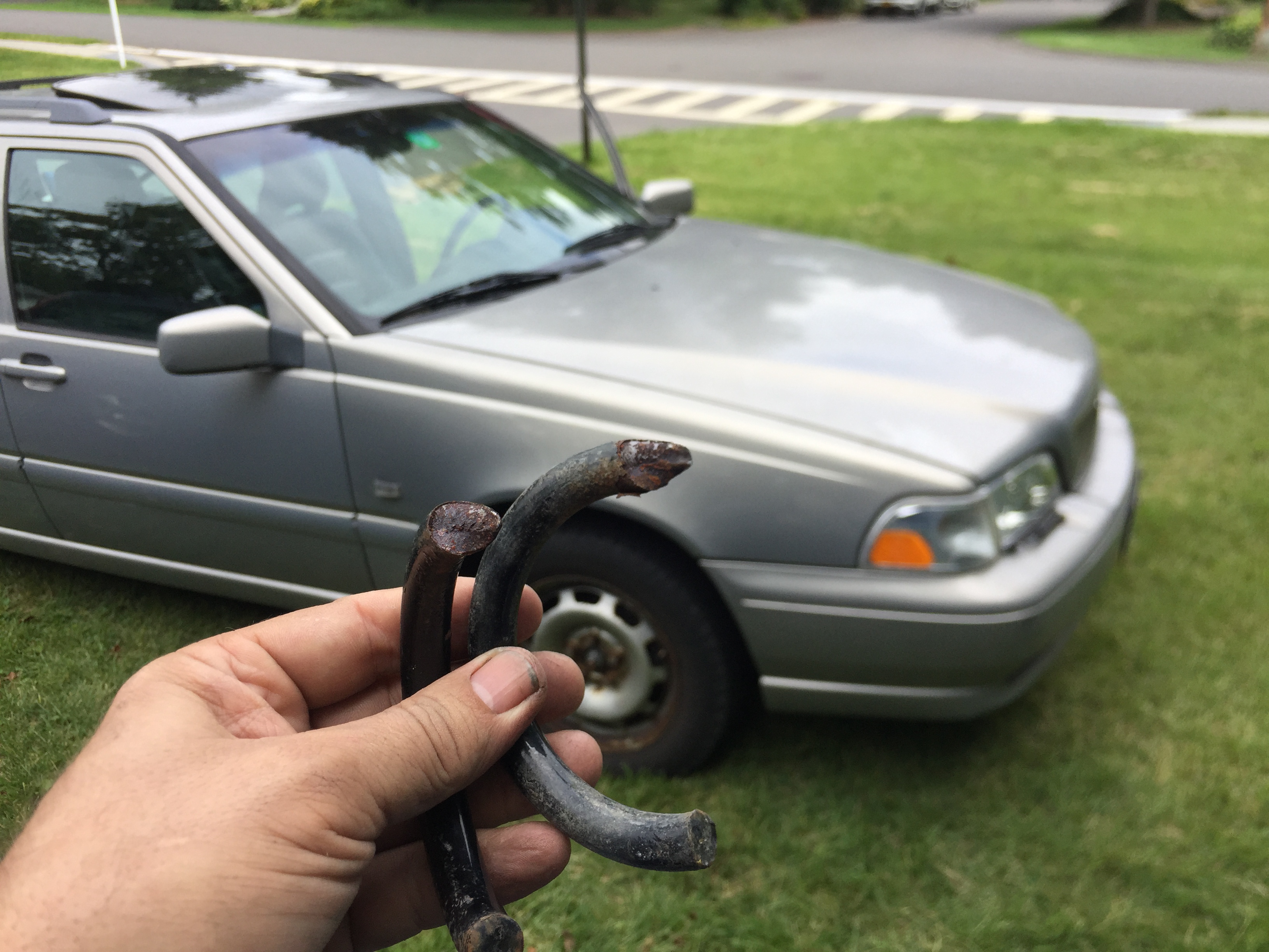

After completion, right front spring suddenly fractured and took out a brand new tire. The initial failure released the spring tension which induced a clean new fracture in the spring up top - part of this shot sideways into the tire and opened the sidewall.

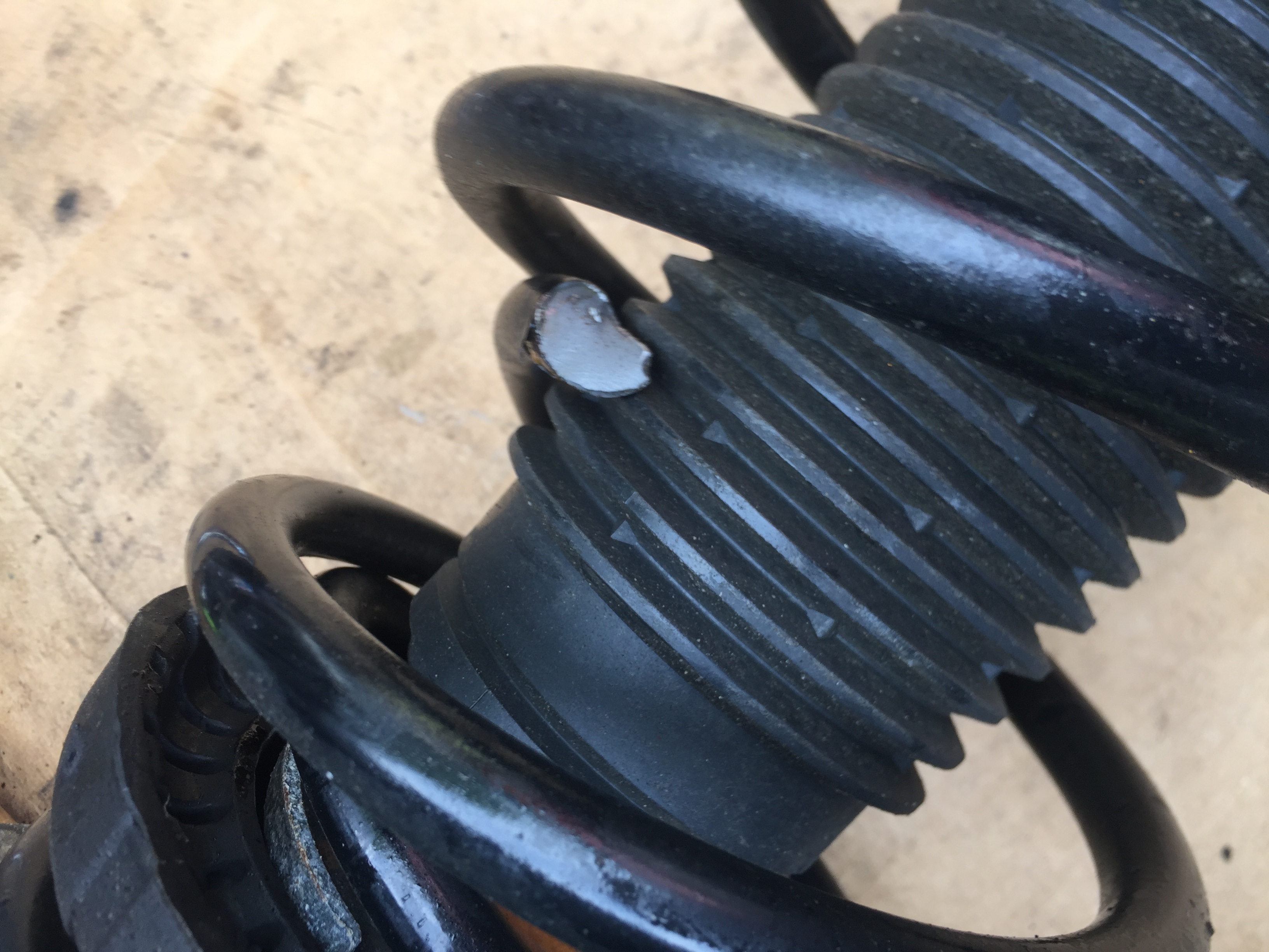

Two days later, the left front spring also fractured with no further damage.
Both failures show evidence of crack, corrosion intrusion, and final fracture shear. Both shear faces are heavily rusted, despite being in a dry envoronment.
Mileage on struts estimated 5000 miles.
P80 Sachs quick strut mount - double failure AUG 2020

Wow! I would certainly be asking questions of the supplier! This is a dangerous product and may be faulty manufacture.

Yea, that crosses the line from crap manufacturer to simply dangerous. Sorry that happened to you, Steve.

I am quite shocked that this happened. As you probably know, I was the one who installed these. The overheating problem may have been a blessing in disguise. I don't want to imagine what could have happened to Mark's daughter if this happened while she was on the road.

Based on my somewhat limited experience with forging, I'd say that those springs were not tempered correctly in the factory.
