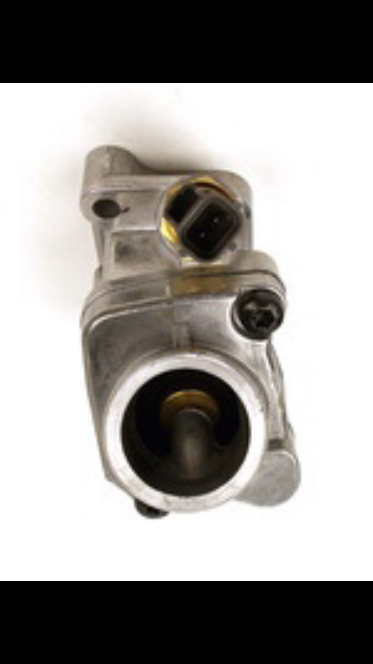

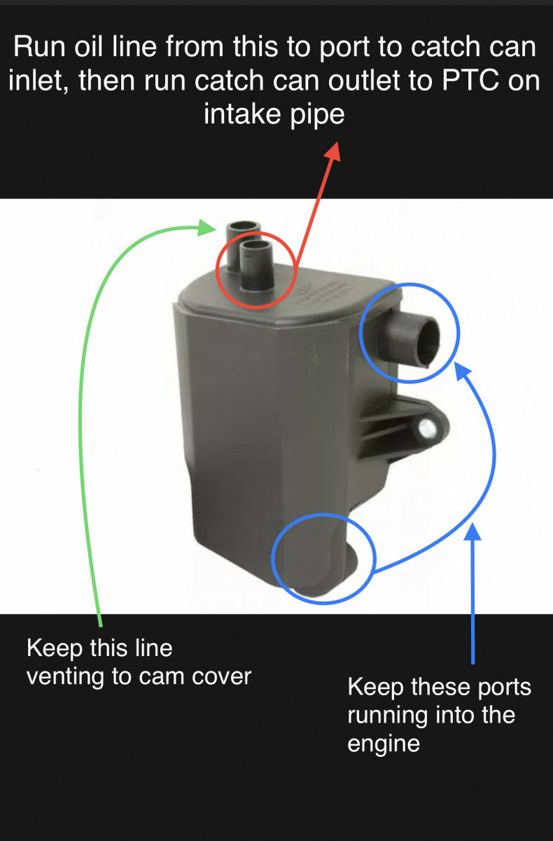

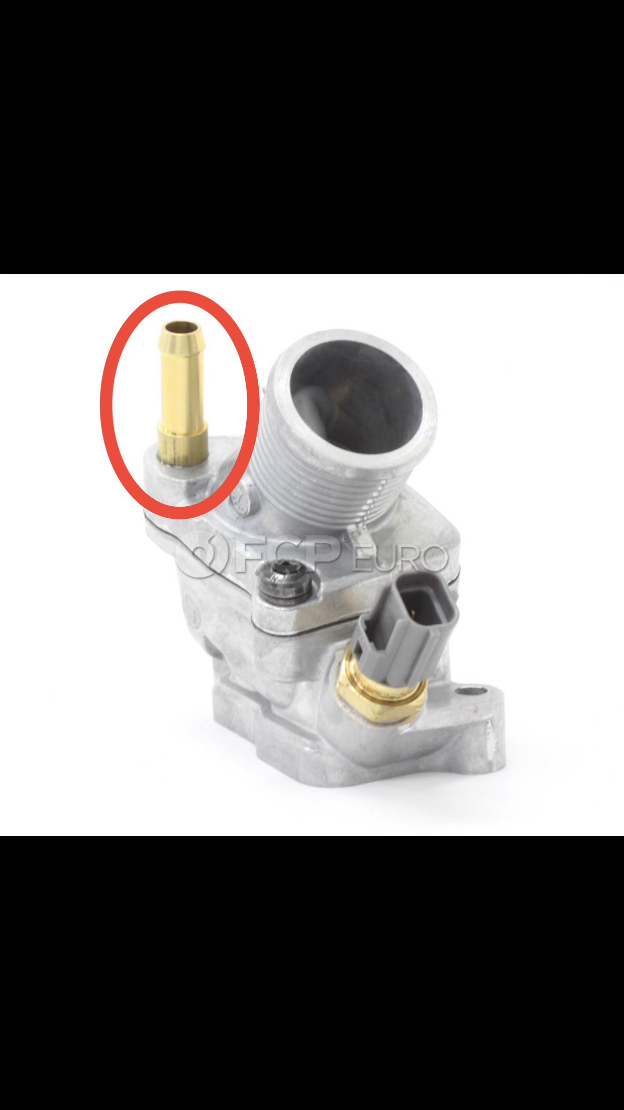

I’m glad I’m not the only one that thought of this. I was thinking of doing the following in this diagram I drew up for a friend to understand. In order to delete the intake banjo bolt and the bolt above the flywheel sensor, you’d then find a proper bolt of the same thread with a crush washer to block off both the intake manifold and the coolant port on the block. And to fix this nipple on the thermostat you could simply run an NA thermostat housing does my logic follow? I feel this simplifies the system in more ways than one along with eliminating oil circulating through the intake with the catch an present.
