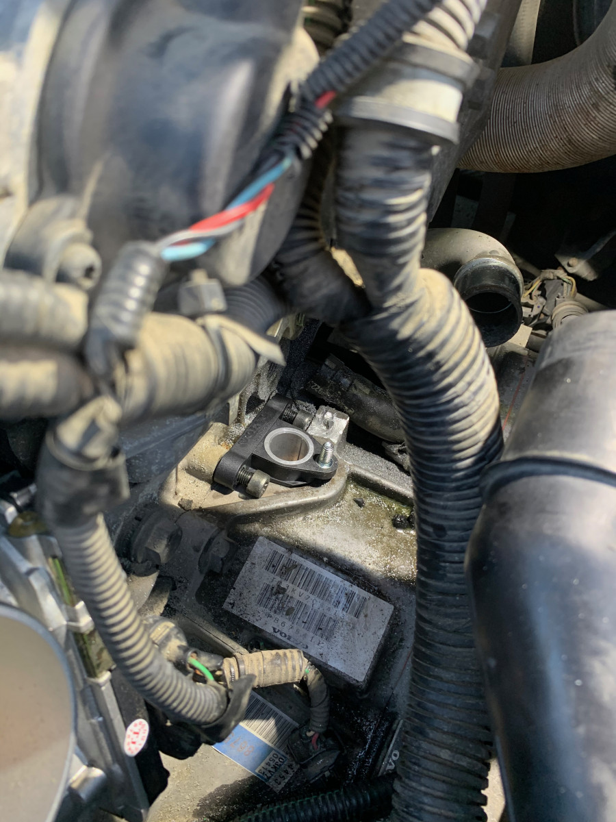

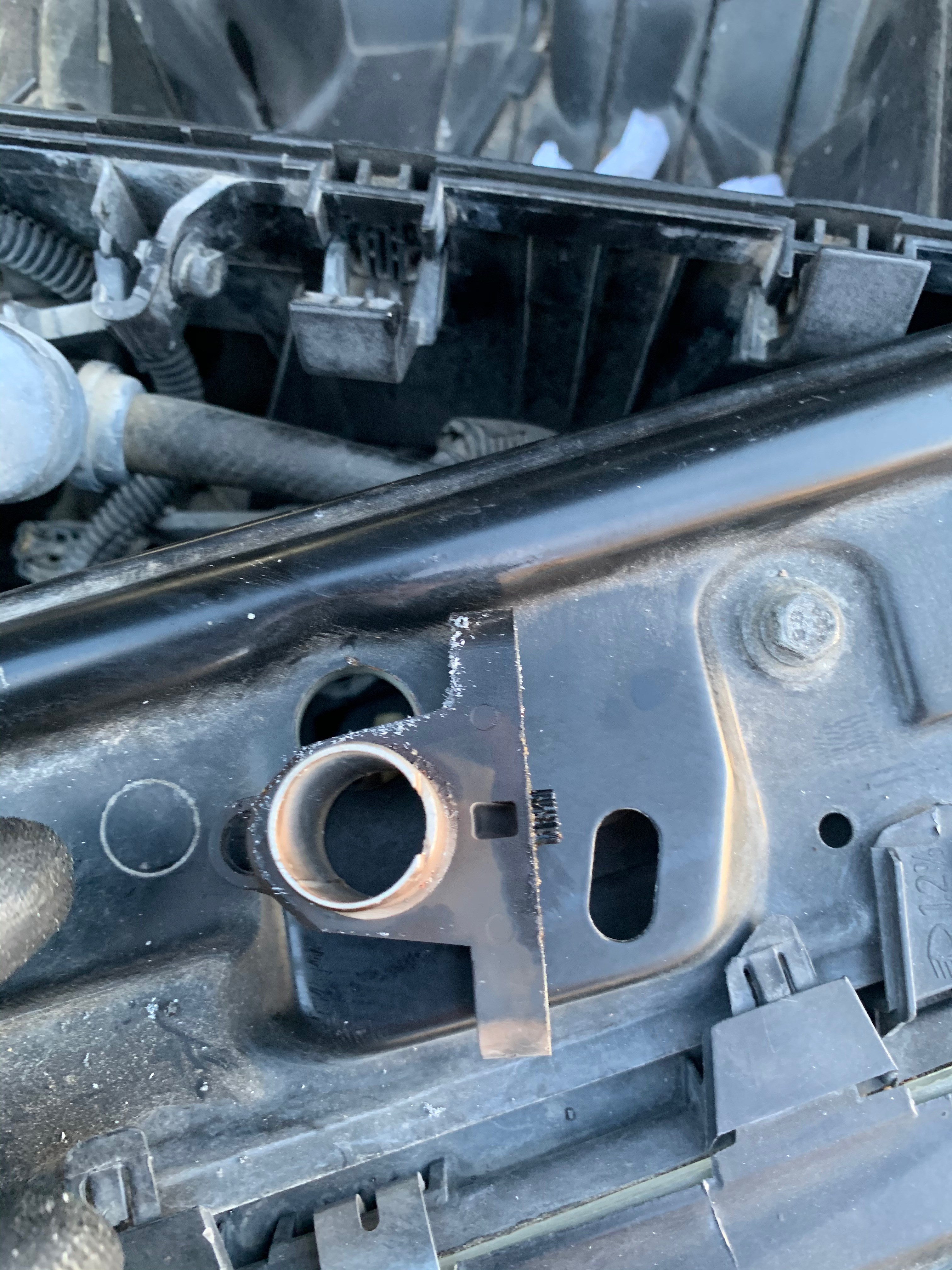

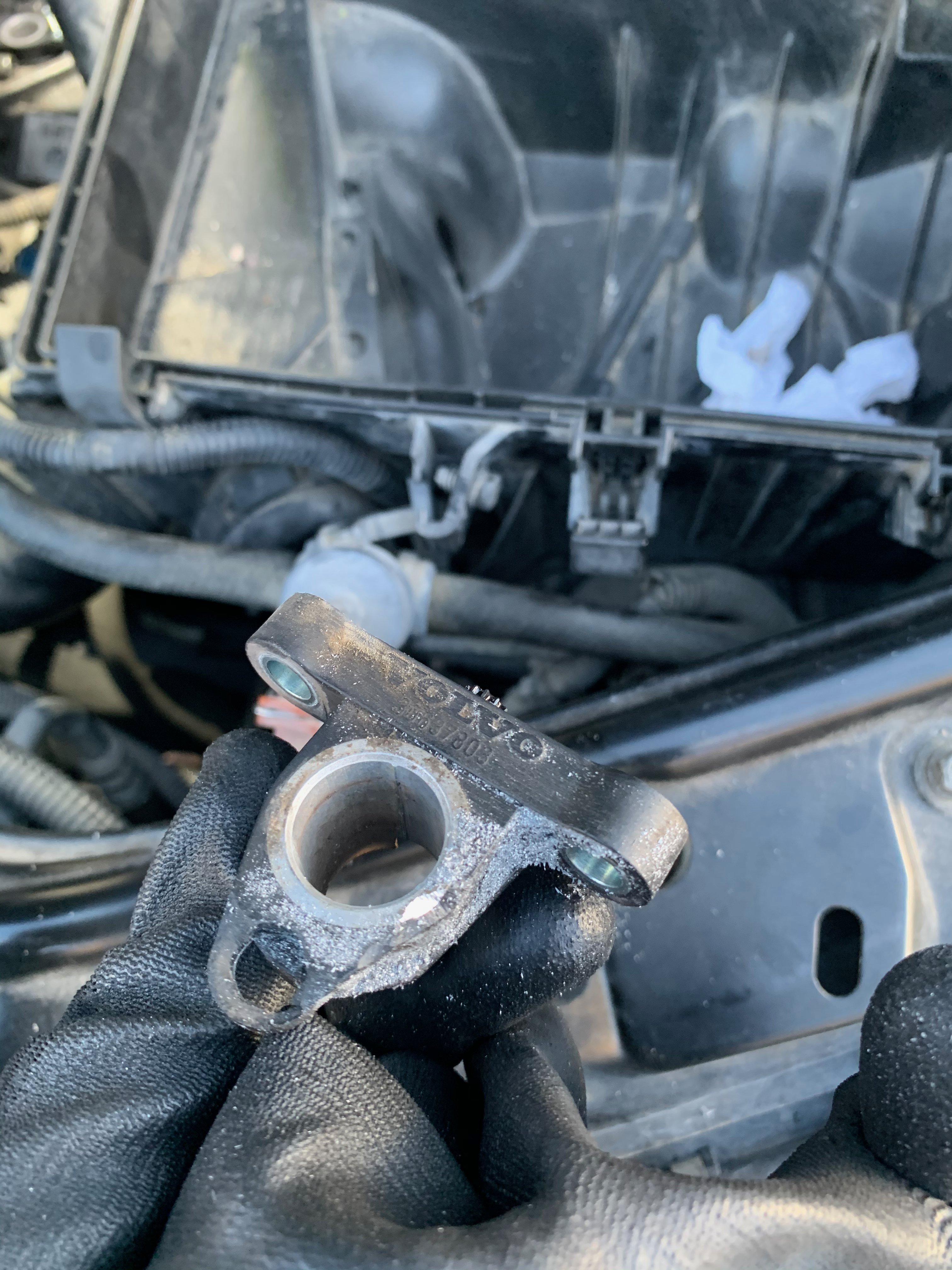

replaced the TMap sensor still did not fix the problem. So went to replace the crankshaft position sensor and while tightening it the damn bracket broke. So I ordered that part and will be replacing it..... Does anyone have a part number for the wiring harness for the crank sensor plug?

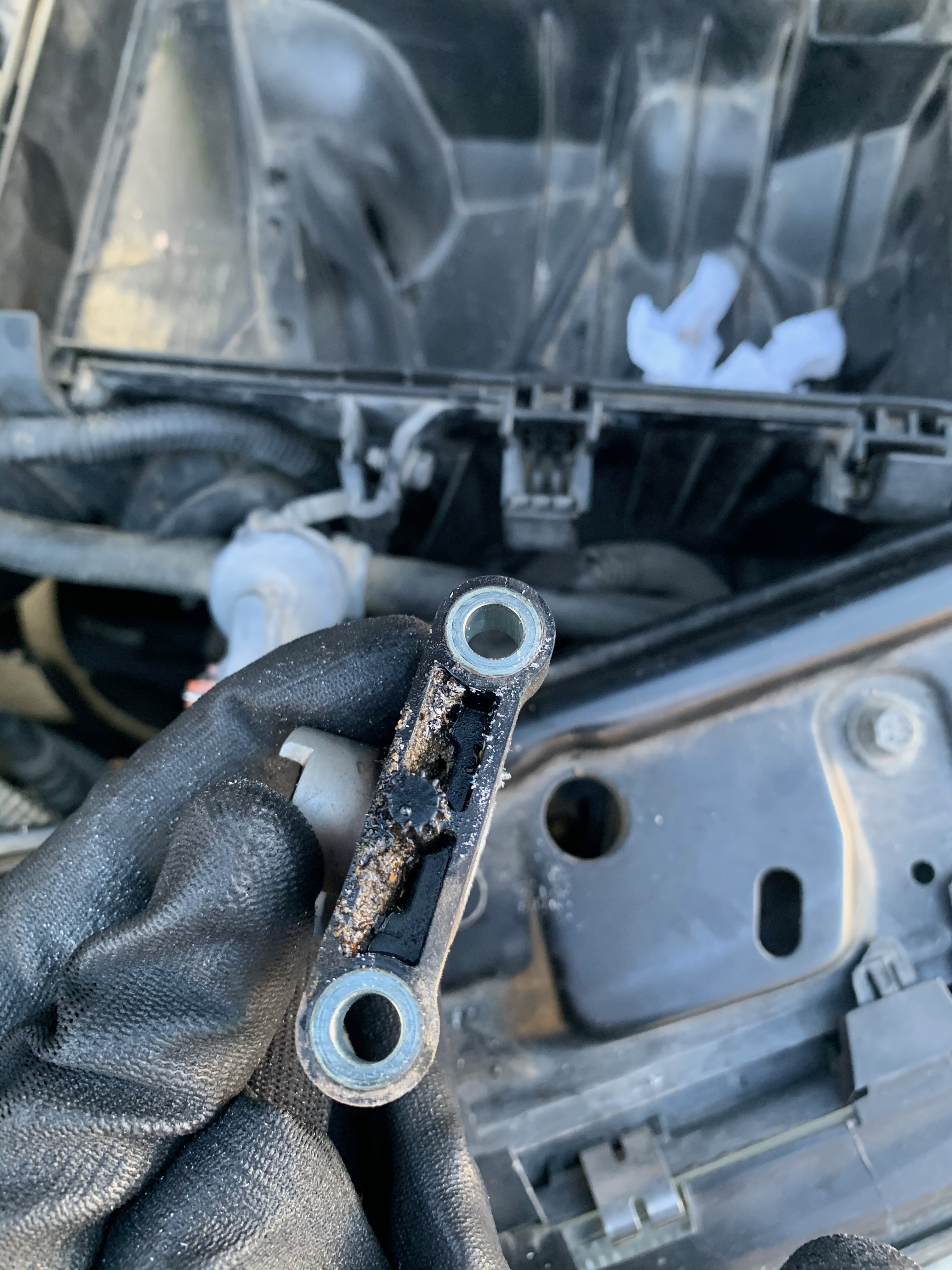

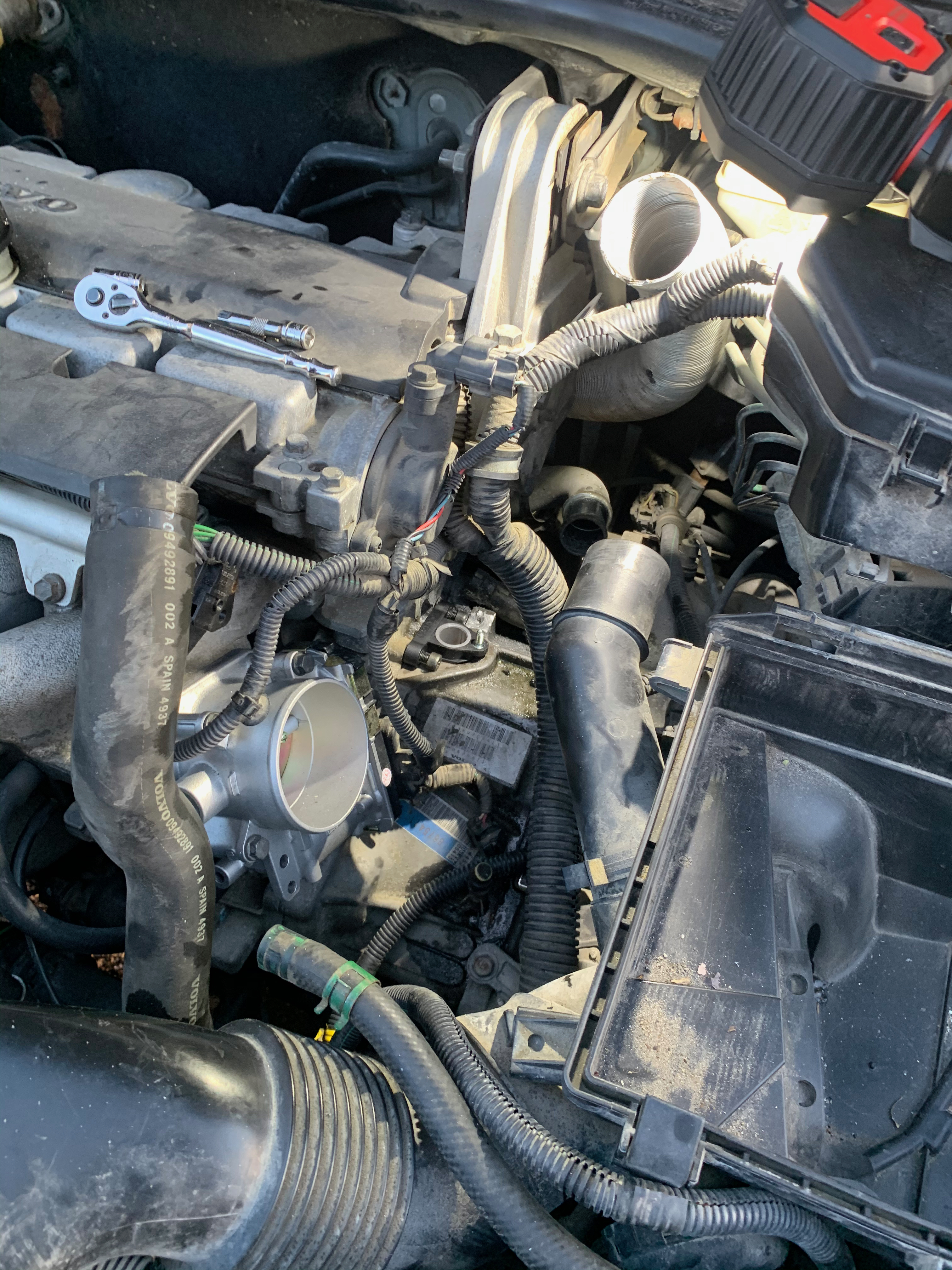

ImageSo I was able to get outside and replace the crankshaft position sensor engine bracket. I had to grind down the tranny slightly to get the bolt out. The car started fine, but it was 40F outside, so not cold. Hopefully, this solves the issue. It almost appeared that the bracket had a bunch of carbon build up on the backside where it's open.
