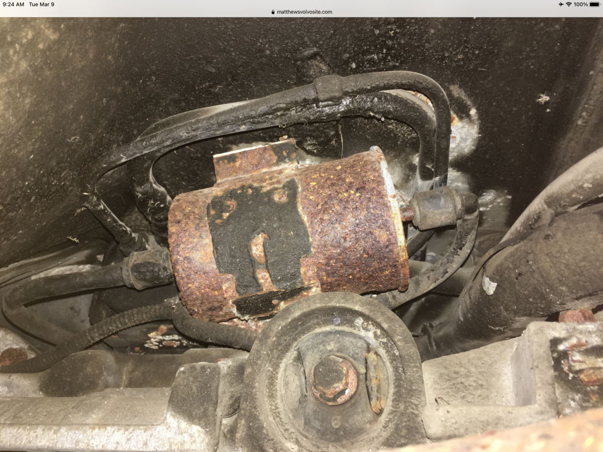

P80 How overbuilt are the Fuel filters 30671182 on our P80 ! Fuel filter autopsy

I completely agree with this; my policy is to change a filter a) when I buy a used car to establish a baseline, b) every 100k after that. Gas quality nowadays is nothing like the past. I cut open a Volvo filter off the used P80 I bought not too long ago. It turns out it had been on about 8 years/50k miles once the date code on it was decoded (date matched t-belt job change so I could guess at miles.abscate wrote: 28 Oct 2020, 10:42 It’s hard not to eye roll at the ‘plugged fuel filter’ diagnosis. Unlike Uncle Joe’s era, gas stations sell a lot cleaner product than the past, and we rarely see fuel systems getting gunked up.
I posted it at BITOG since there are more "filter heads" there, but here's what I found when I cut it open, quite nicely doing it's job.
https://bobistheoilguy.com/forums/threa ... en.338087/
