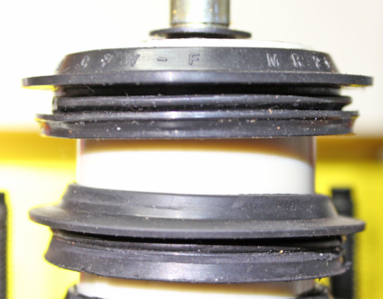

oragex wrote: 02 Dec 2020, 11:42 Good information. I did update this in the video description. So the only way to be sure what to order is to read your old seal ? That would mean you have to first remove it from there, before ordering, which is quite inconvenient.
Yes, no easy task to get the part number off the original seal.

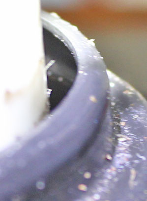

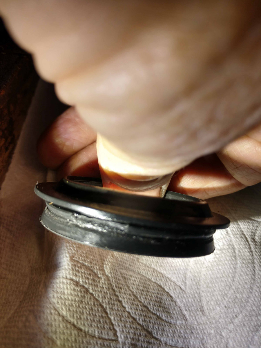

When looking at the two seals, my original seal (top one in photo) and the one from URO it looks like the primary difference is edge of seal that's first inserted into the brake booster opening. The upper lip on the original seal also looks to be a little larger. The damaged that occurred both times during the installation was the upper sealing lip, it tore away when doing the final seating of the seal with the angled end of the supplied pipe (see photo). I also split the lower part of the 1st replacement seal when trying to install the seal while the brake booster was still in the car. The second attempt was on the bench.
After looking at the seal difference I'm not certain the difference between the seals is what cause the damage during installation unless the thickness of the seals is also different, which I couldn't determine. The URO seal fit was very tight in the opening and once the seal was fully seated most of the way around and the last remaining section to seat was a very tight fit and that's when the upper lip of the seal tore away. As I mentioned before the brake booster out of my car has a pretty sharp edge where the seal is inserted so I'm wondering if this contributed to the problem and if there were later changes to the brake booster seal opening.
