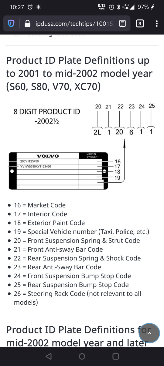

You can look at you VIN plate under the hood by the fender and find the factory suspension codes which originally came on your car. Depending on the year it's either an 8 digit code or a 12 digit code. Here's the 8 digit code breakdown.
