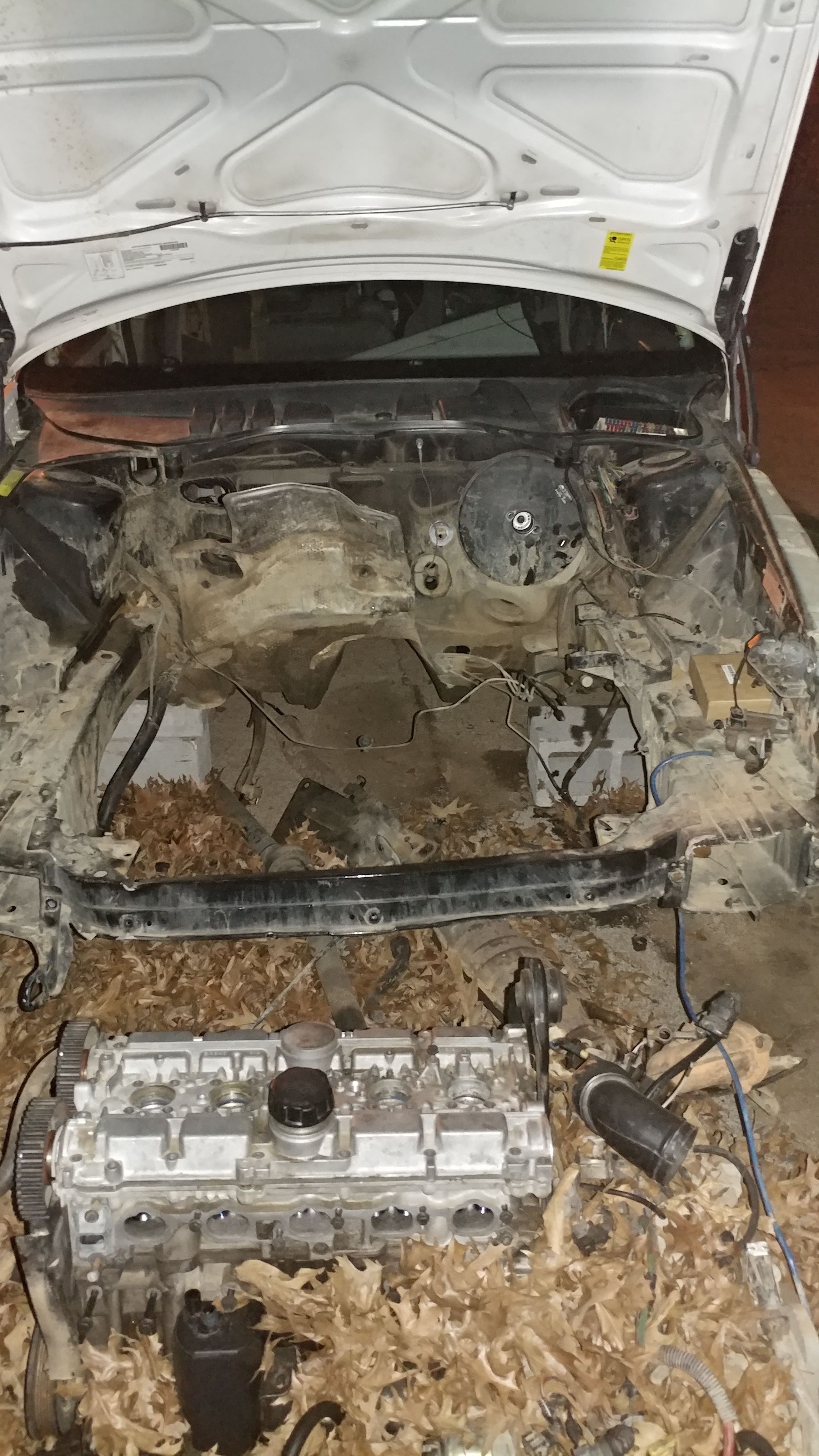

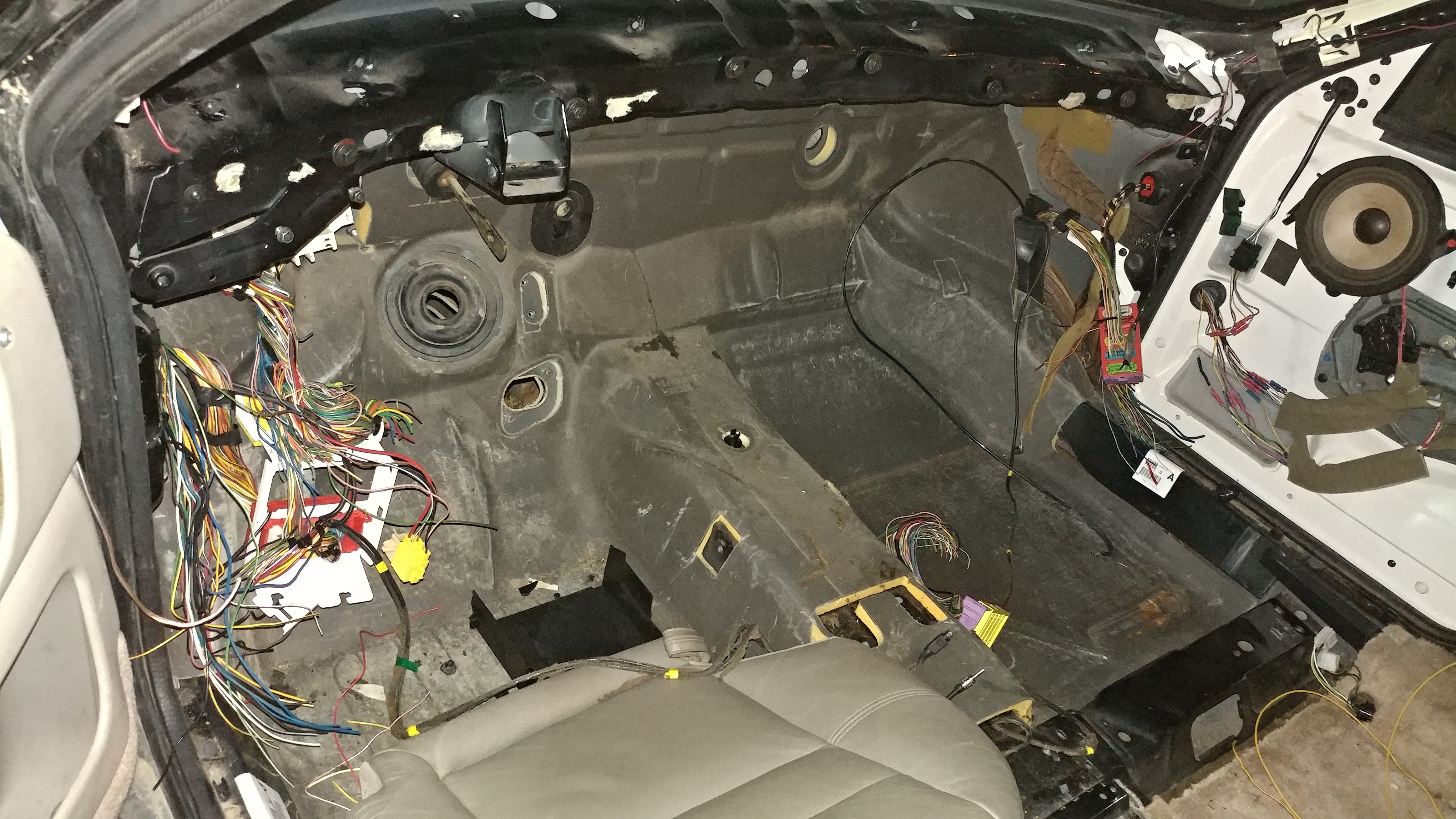

UPDATE #4
I tore out the rest of the engine bay minus the brake booster and also the interior front. This is the point at which it becomes difficult because I have to sort all the wiring to figure out which wiring goes and which stays, as well as how to rewire the items I'm keeping. Wiring is a VERY fun activity for me but this sorting will test how many marbles my head has.

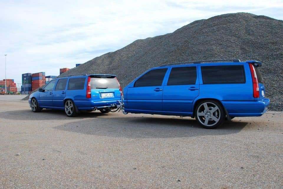

Are you referring to a similar cut like the displayed gray trailer?
I want to go with how the displayed blue trailer was done.
Spoiler: This will be a camper and utility trailer. I want to keep the functionality of the folding 2nd row so i can sleep there. I did that about 2 times in this one. And then if I want to help someone move their giant couch and washer or dryer, I will have...about 9.5 feet front to back. I just measured.
Actually I fit my old couch in my previous 01 v70 base which might have 1/2" more or less than the 98 v70. The couch fit from hatch to next to the back of my driver seat (7.5-8ft?). My friend and I tried fitting his pool table in this 98 but the hatch opening was 1/4" too narrow. I need to change that 😃

CIK7 wrote: 28 Dec 2020, 20:30 Are you referring to a similar cut like the displayed gray trailer?
Yep. Those guys spent a great deal of money on those projects.
Blue one kind of gives me the creeps. Also, it will have a lot more tongue weight because of where the wheels are.
