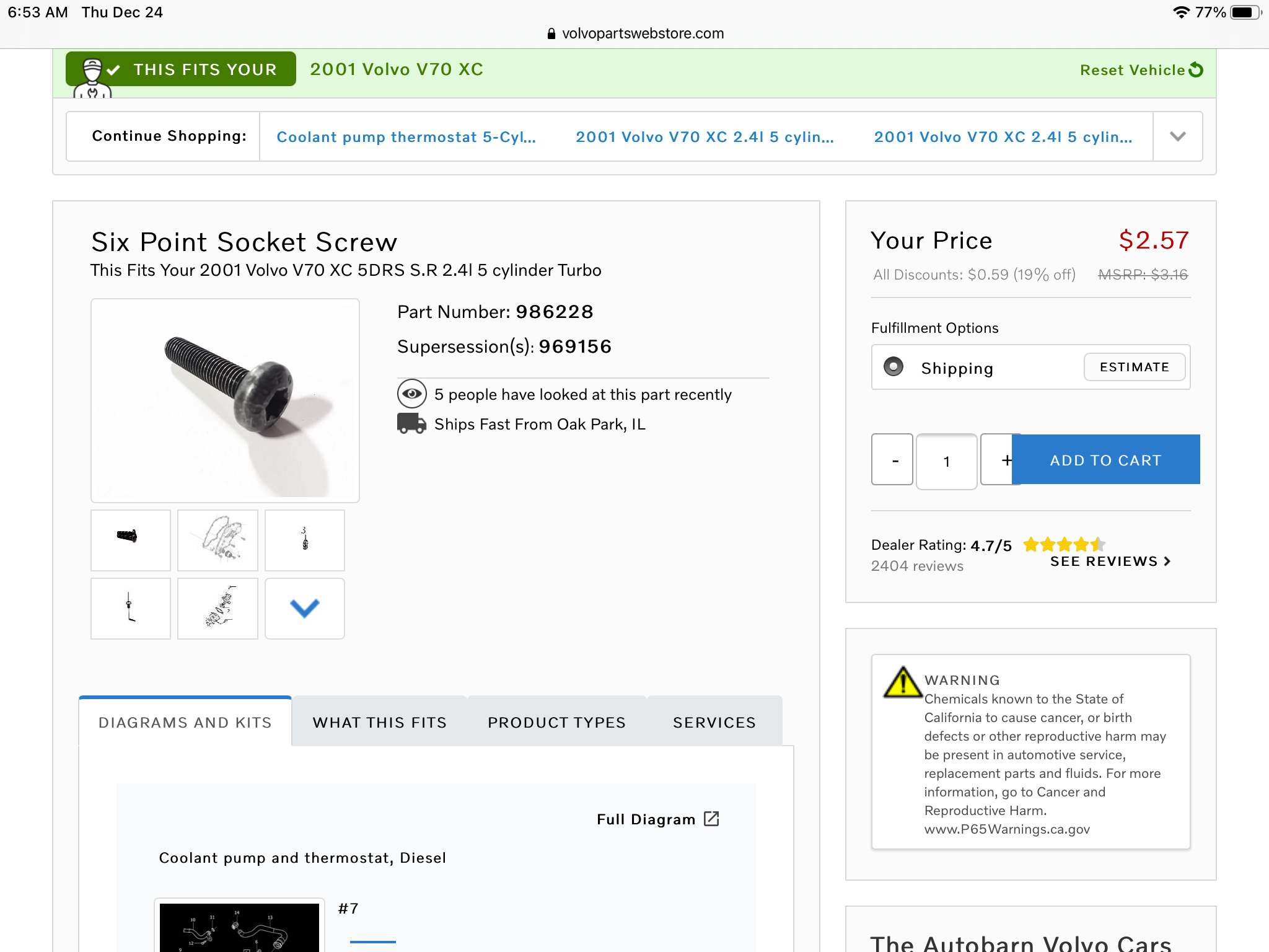

...and add two new bolts to that FCP thermostat order.
986228 ? You have to watch out fir a chassis break on the 2001, so order by VIN

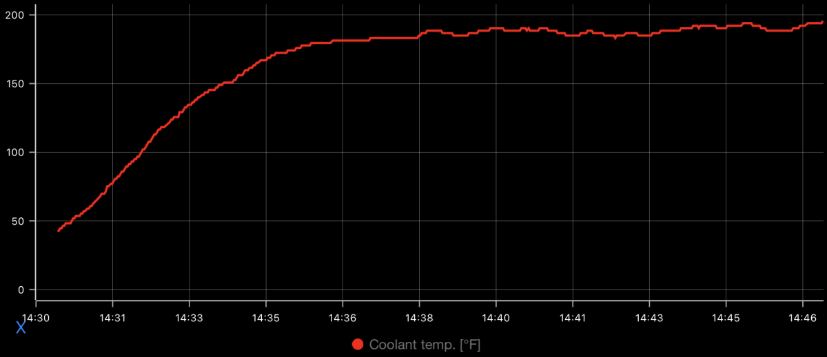

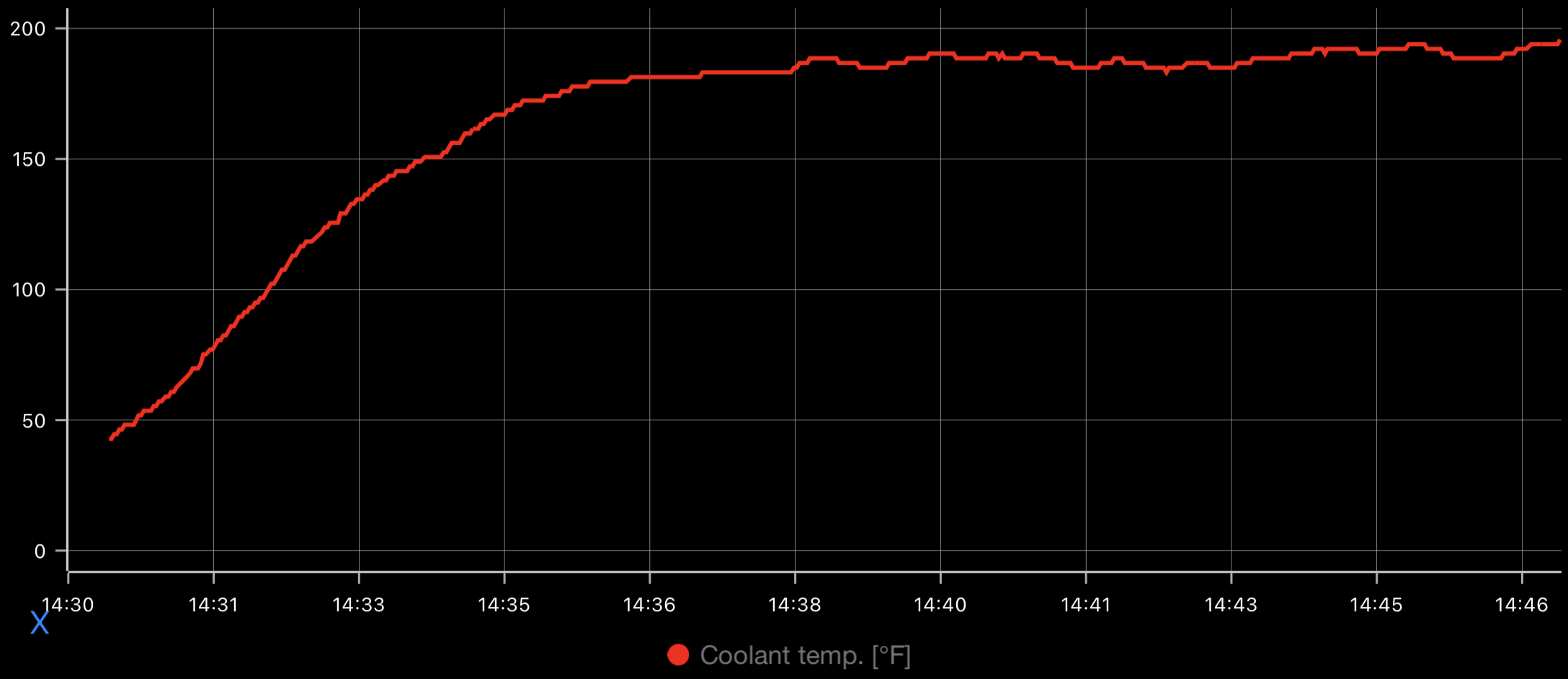

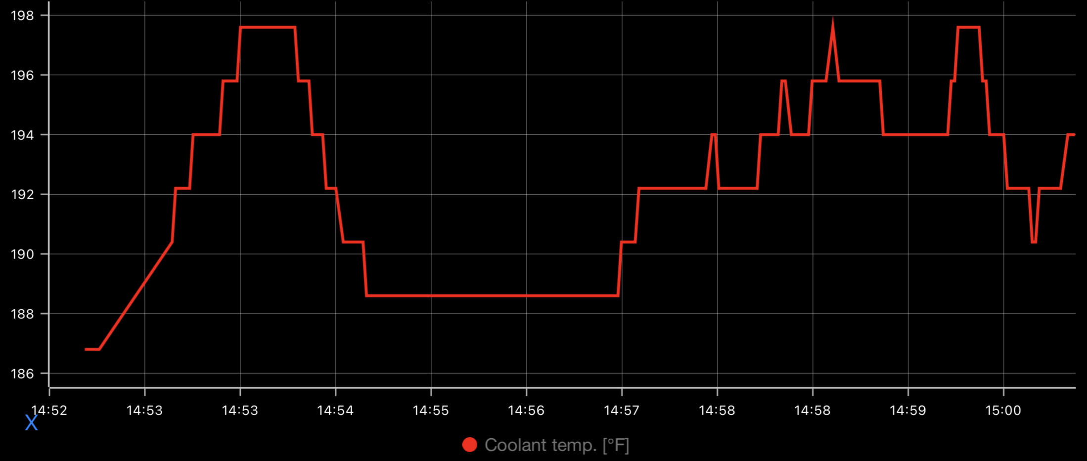

So I got the new coolant reservoir cap, and today I installed it and took the car out for a drive. This doesn't seem to have solved the problem - I ended up having the coolant boil over again once on my drive.
The coolant tank was empty before I started, so I topped it off, then I started the engine from cold and hooked up my OBD scanner and started monitoring/recording the ECT reading. Also, during most of this time I had climate control turned off to ensure that the heater wasn't dumping heat from the engine coolant and affecting the diagnosis.
Graph 1 started from home, where I headed to the highway, and drove highway for a while until I stopped at a gas station. This represents ~15 minutes of run time.
Overall things were looking good at that point. The ECT was hovering right around the thermostat temp of 195.
Graph 2 started from the gas station and ended when I drove to a fast food pickup window. This represents ~8 minutes of run time.
Things were still looking good and hovering around the thermostat temp of 195.
Graph 3 starts just after the fast food pickup, when I was idling in the parking lot. About halfway through Graph 3 (about 15:19) was when I left the parking lot to drive home, and the graph ends when I pull into the driveway. Note that I did not shut the engine off between Graph 2 and 3, the recording program I was using quit when I opened another app at the drive thru.
That means that during that gap, which would be about when I was idling with the gear in Drive in the drive thru line, the ECT temperature went up from ~194 to ~207, which is where Graph 3 starts. So after that, while I was idling in Park in the parking lot, the temperature fluctuated between ~207 and ~221. At 15:19 was when I left the parking lot and started driving again. Very shortly after that, I got the coolant lo warning message, so I pulled over, shut off the engine, and refilled the coolant. You can see this on the graph right at 15:20. After this, I turned the heat on full blast to ensure that the coolant stayed cool til I got home, and the temps dropped down.
So basically, everything looked good while I was driving from local roads to the highway (Graph 1), and everything looked good while driving on local roads, but things got bad when I was idling and reached the boiling point as I started driving again.
Given that I replaced the expansion tank cap, and given the data above, would the symptoms point to a thermostat, ECT sensor, or head gasket leak? Any thoughts what I should try next?
