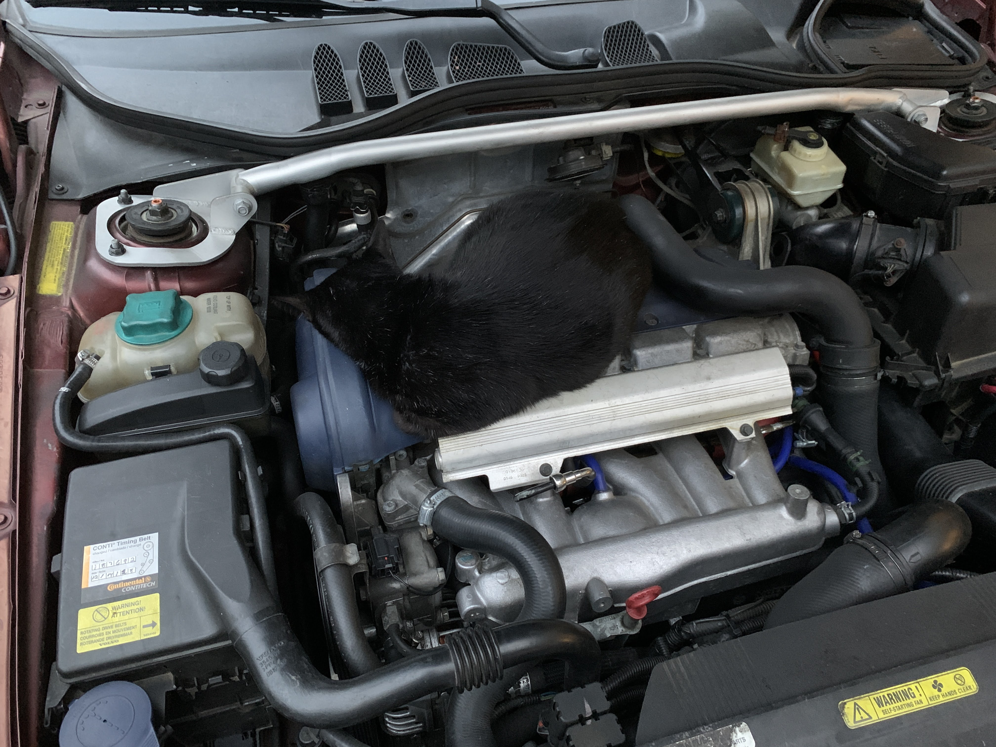

Upgrade to the 2005+ P2 style PS reservoir, it's a must on the '99+ P80s! These reservoirs are so much better, and don't swell up and leak like the older style. I really don't know why Volvo even sells the old style anymore, they're horrible quality.850 LPT wrote: ↑04 Feb 2021, 07:54 I am running into this with a PS reservoir in my S70. This was replaced a year ago and 6k miles with a OEM part from FCP. It's leaking again which is so disappointing. I don't think it's leaking at the seams yet but it leaks at the cap for sure. I could just replace the cap and see if that cures it, but then I have to spend money on that. The FCP warranty is great, but even if I replace the whole thing it's not certain the new part is going to last the way it should.
The new one has as screw-on cap rather than the 1/4 turn cap, so it seals much better. The reservoir is made of heavier plastic, so it doesn't swell up and leak like the old one. All you need to fit it is the reservoir and the suction hose that goes to the PS pump. I recommend junkyard parts since the hose is outrageously priced new.
You can see how clean it stays. Kitty was keeping the engine warm for me.

Wow, thank you so much. I learn something new about these cars every day. And you're right, FCP would actually be well advised to discontinue these as they probably have to replace them under their warranty all the time.bmdubya1198 wrote: ↑04 Feb 2021, 10:10Upgrade to the 2005+ P2 style PS reservoir, it's a must on the '99+ P80s! These reservoirs are so much better, and don't swell up and leak like the older style. I really don't know why Volvo even sells the old style anymore, they're horrible quality.850 LPT wrote: ↑04 Feb 2021, 07:54 I am running into this with a PS reservoir in my S70. This was replaced a year ago and 6k miles with a OEM part from FCP. It's leaking again which is so disappointing. I don't think it's leaking at the seams yet but it leaks at the cap for sure. I could just replace the cap and see if that cures it, but then I have to spend money on that. The FCP warranty is great, but even if I replace the whole thing it's not certain the new part is going to last the way it should.
