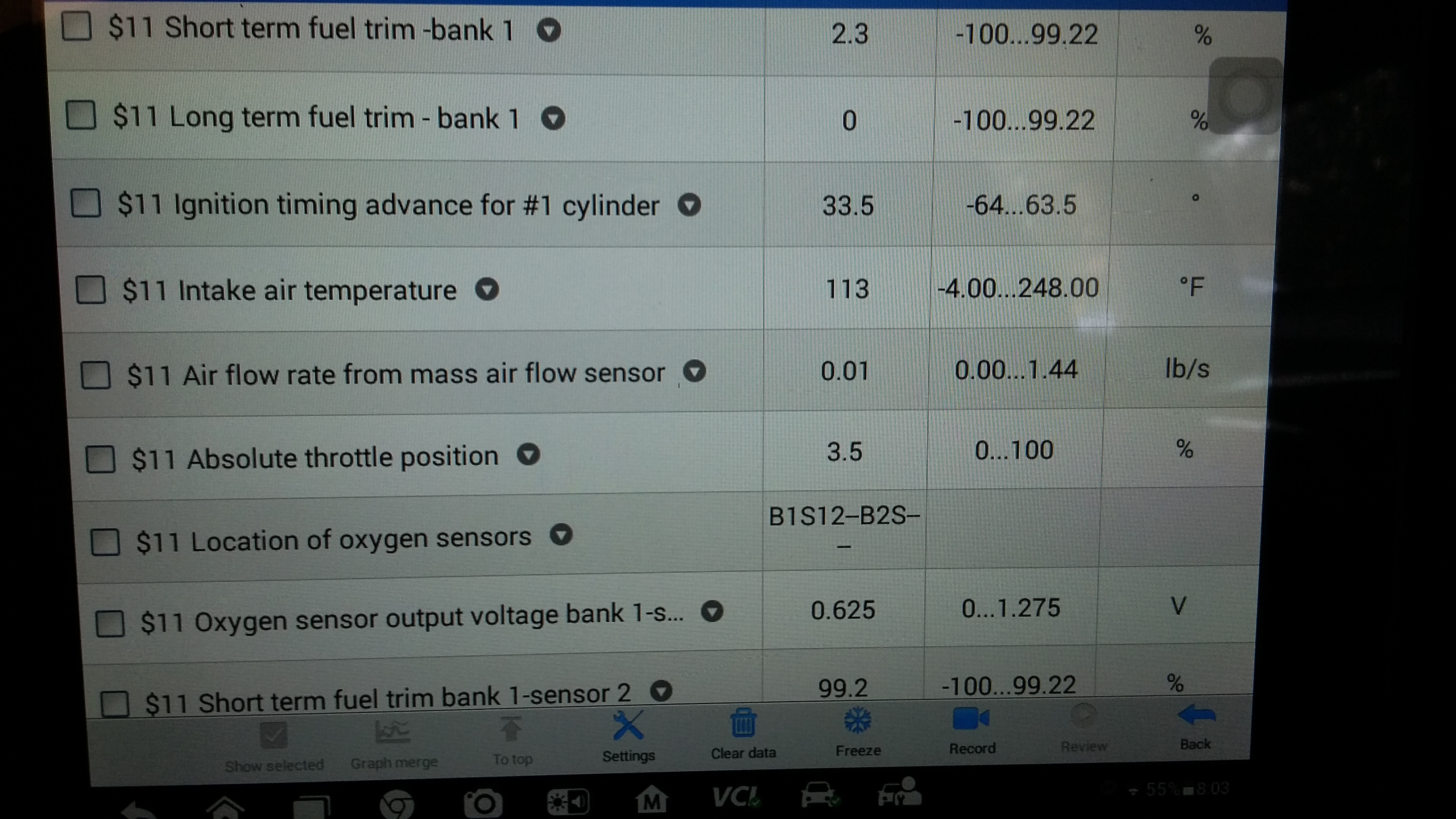

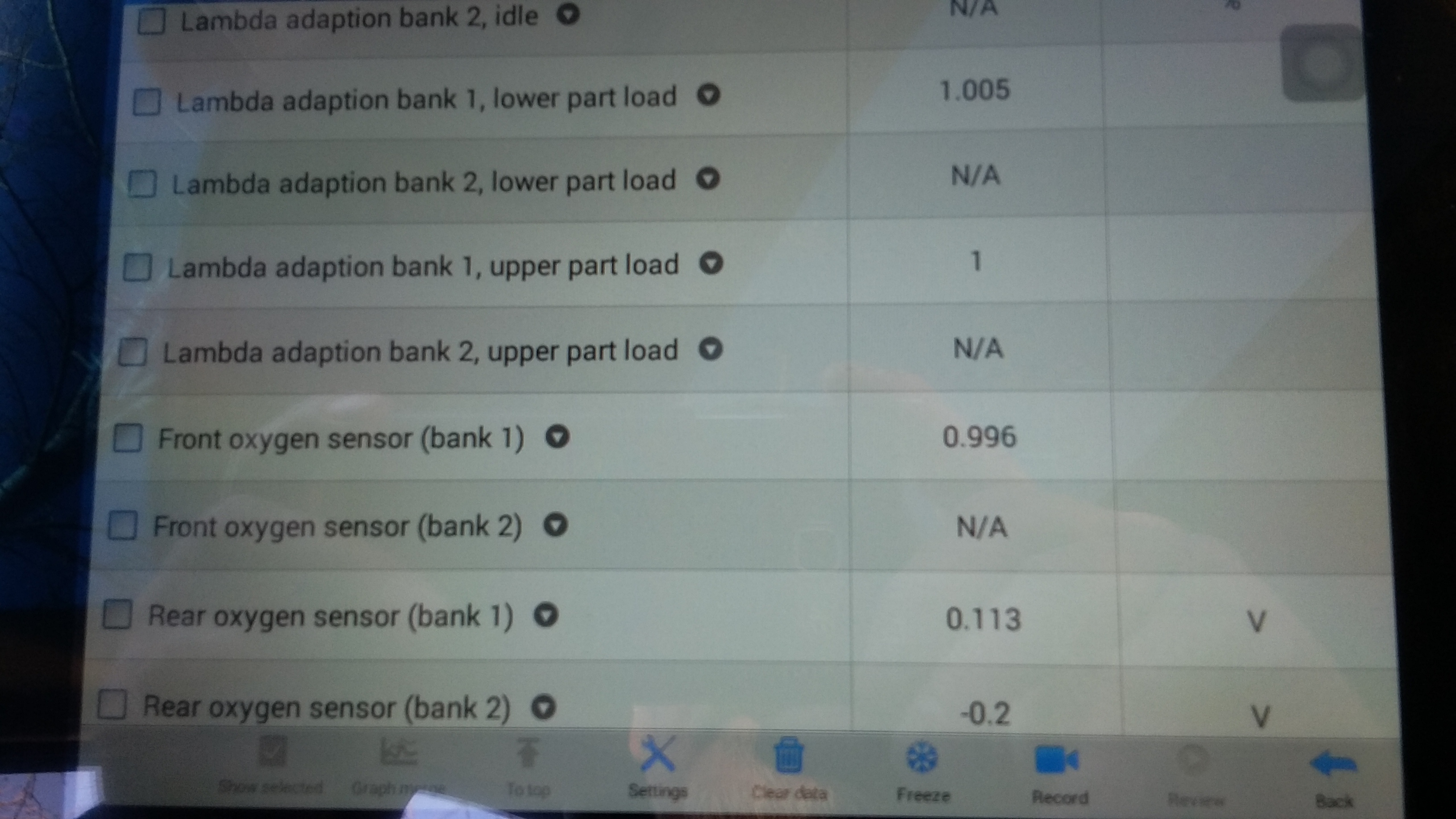

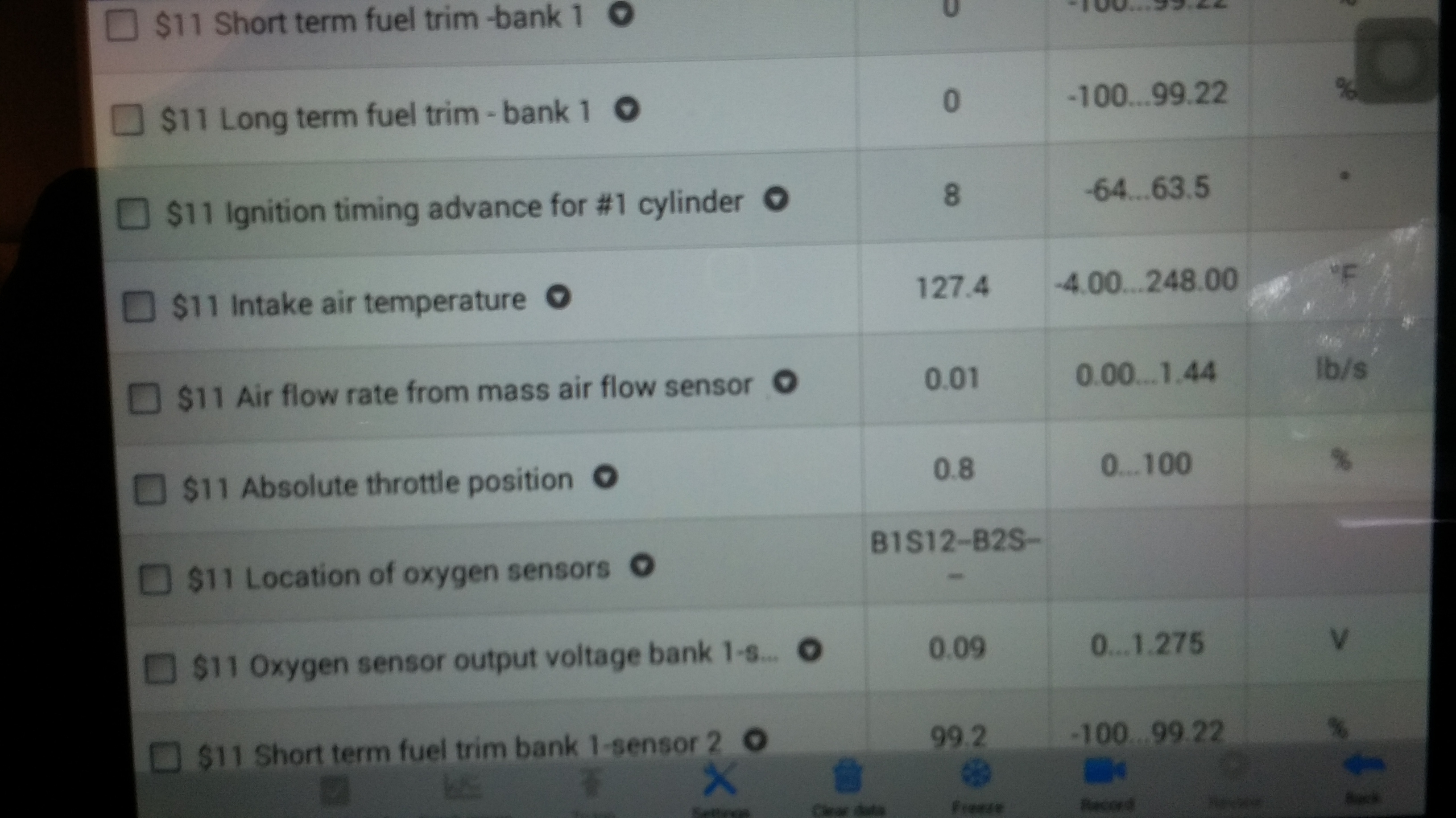

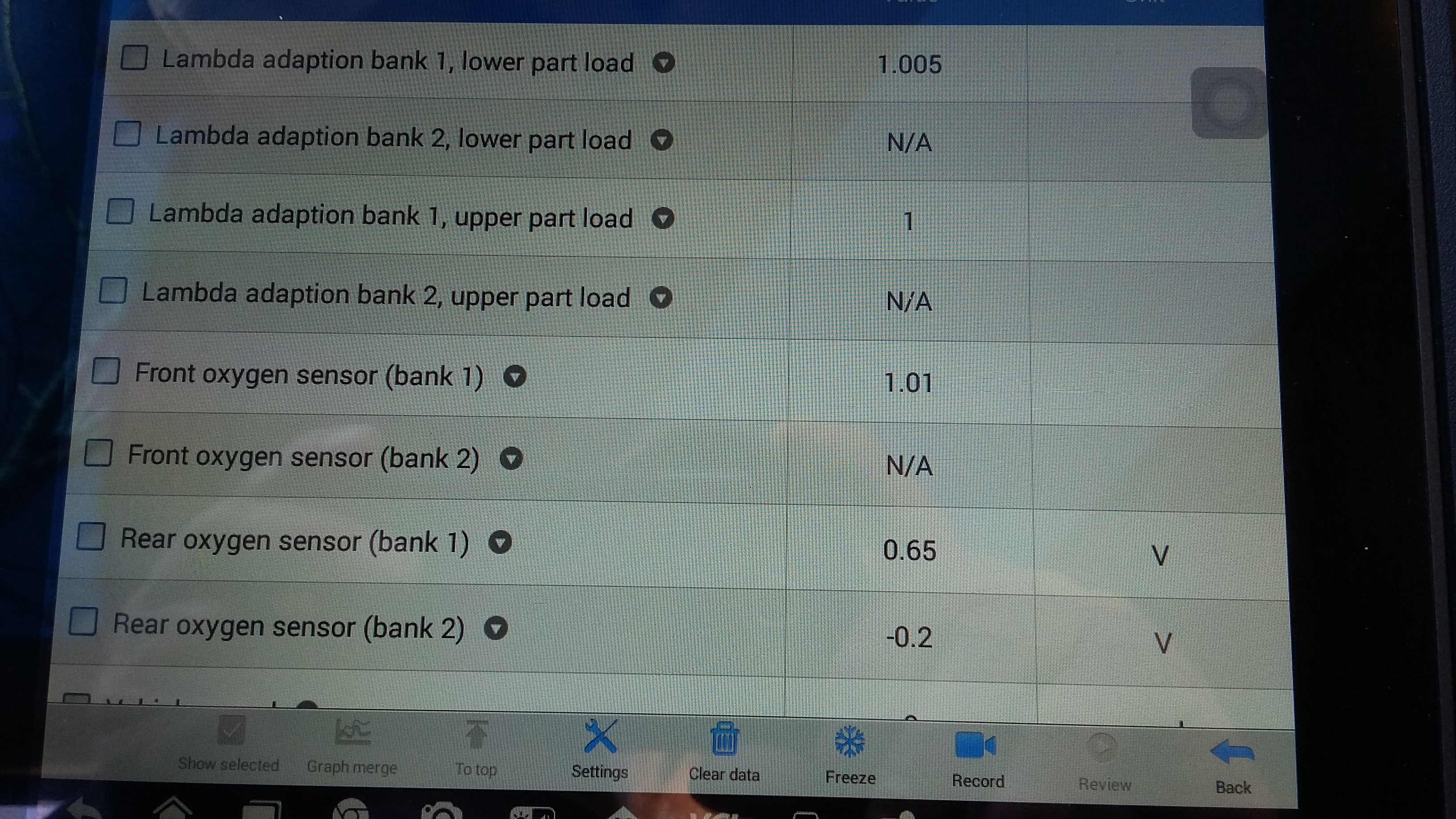

Hi VTI
No signs that the subframe shifted,
I have a scanner but unfortunately I'm unfamiliar with it checking it out now..Autel Maxsys MS 908BT.
This is at idle. 2nd picture is at 2k rpms. Thanks maybe this makes more sense to you
