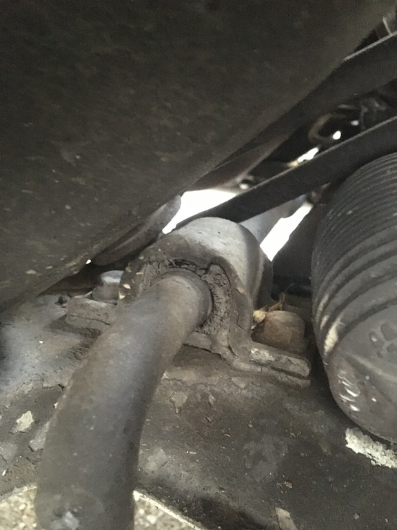

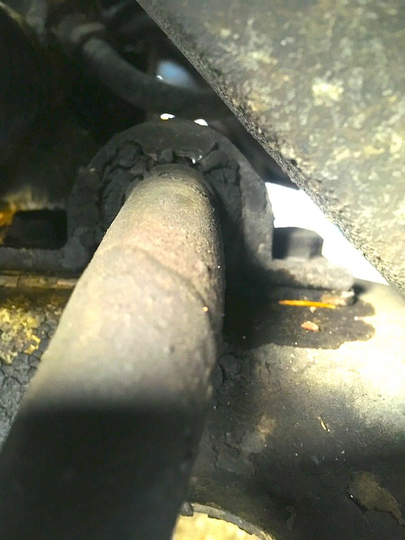

For me, each work down on this car won't have to be to do in the futur. As a newbie in mechanic, everything is good to have a mechanical lesson.Chuck W wrote: 12 Jul 2021, 16:10 Having done this upgrade while undertaking other major work that involved removing the subframe, I don't think it's worth the effort to swap the bushings out on a stock sway bar just to do it.
If you're upgrading the sway bar, do it then. Otherwise, unless the bar is rattling around in the stock bushings, I wouldn't expend the effort.

I was planning on doing it on my car, I have the bushings, I had the opportunity to do it while the engine was out of the car but even that way it seems like a pain in the a**
They will wait for the day I have a lift

I wouldn't touch the bushings unless the sway bar was out of the car already. They don't wear out and there is little to be gained here.

As I mentioned previously, unless you have the subframe down for other work, swapping the sway bar bushings on a stock bar isn't worth the effort for the "gain".
