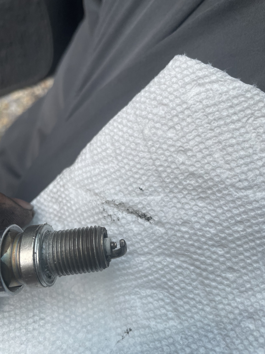

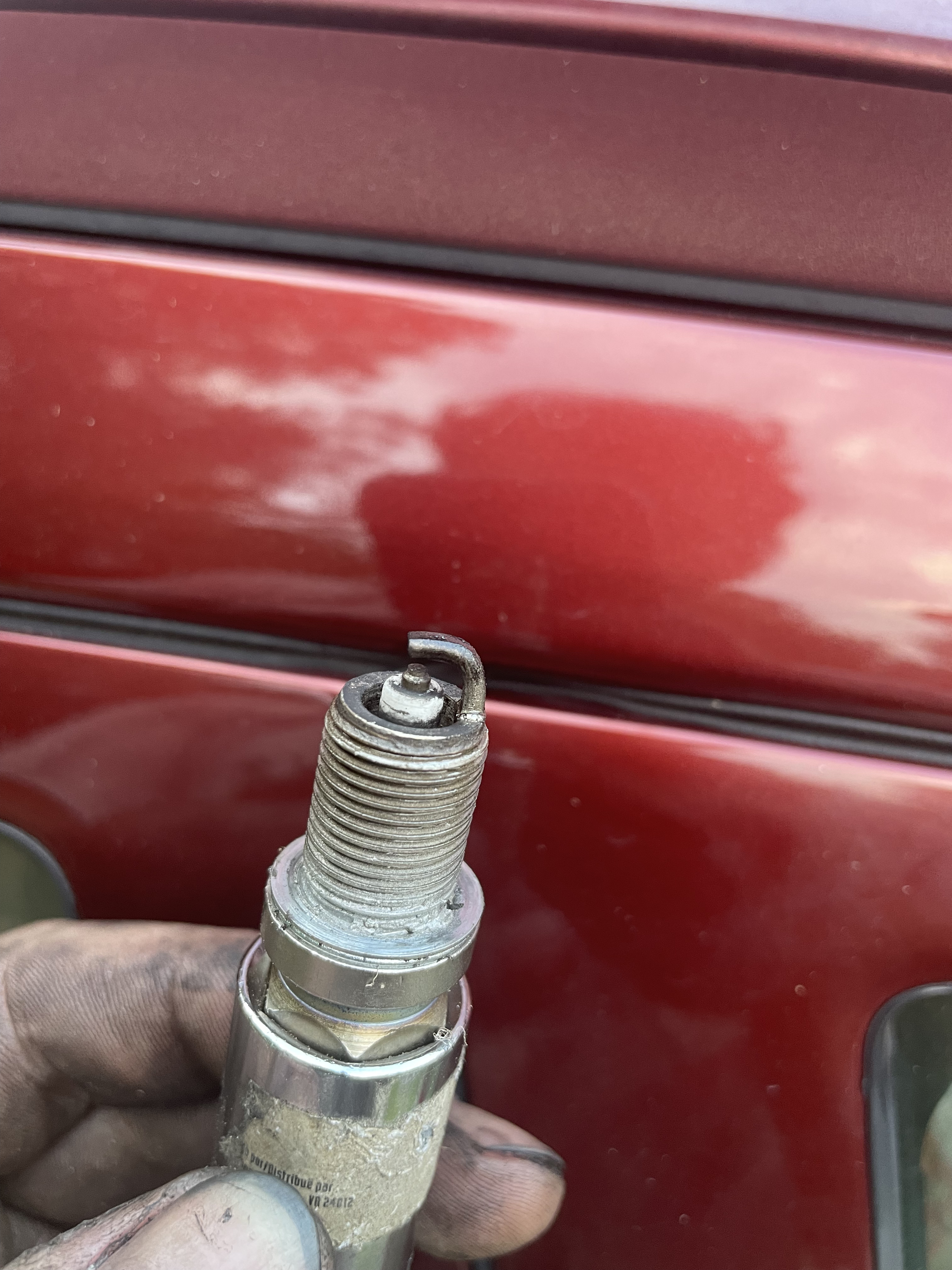

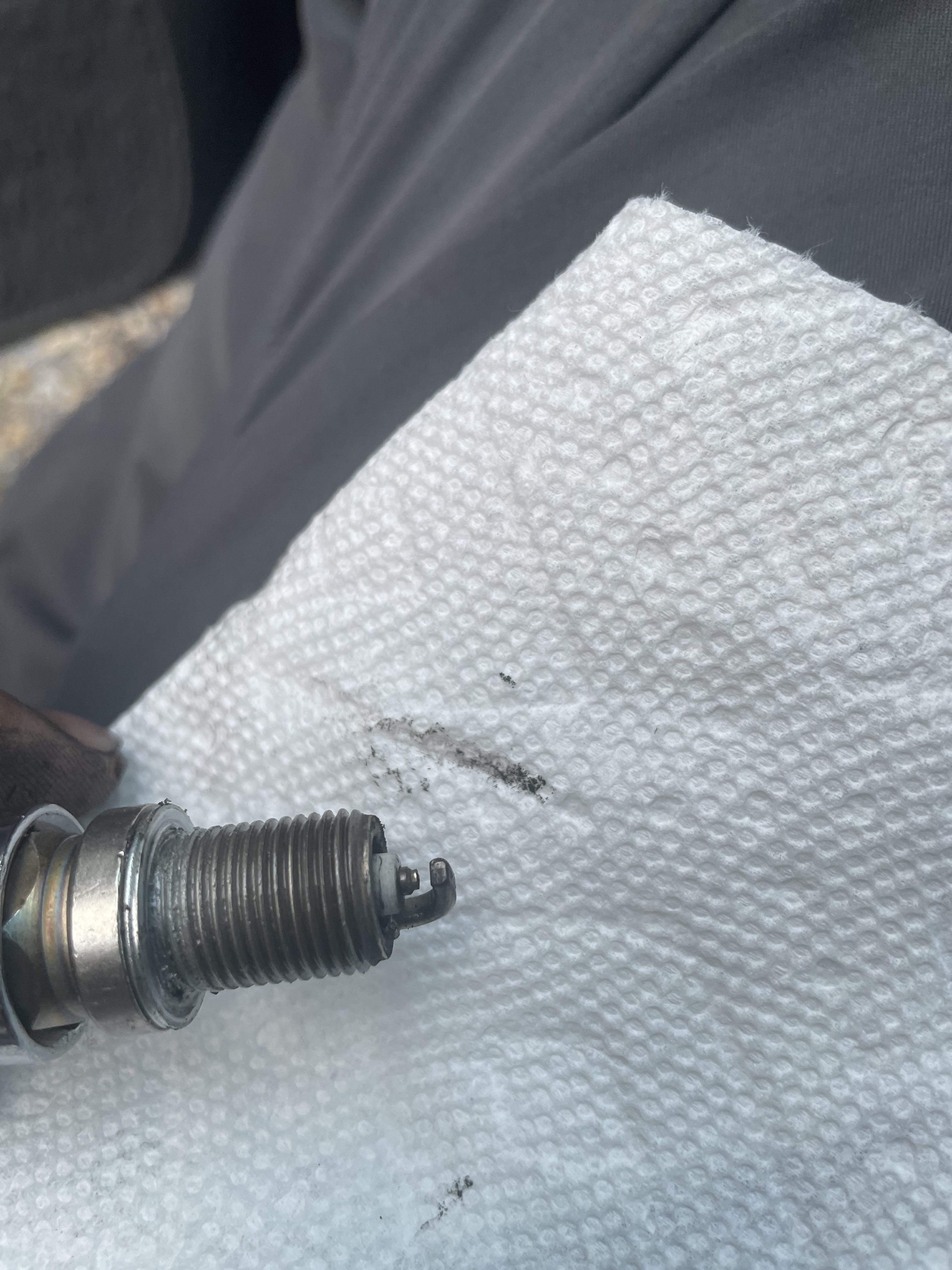

Thanks for the video, finally watched it all the way through lol. I tried direct ether to the ports at the rail and since that didn’t work, I assume it’s spark related….but, I have 10.8 at each coil on cranking and nothing. Tried jumping, nothing.
What am I overlooking?
Again thanks so much to everyone for helping, I don’t have many more options.
V70 won’t start. Out of ideas.

What fuel pressure did you find? Need about 55 PSI.
Spark should be strong and blue. Something electrical may still be wet. Is all of your wire harness well wrapped?
Also, didn’t actually test fuel pressure, but I’m willing to do that. Just assumed direct ether spray into the injection ports ruled out fuel. Am I wrong on that?

You need good fuel pressure (55 PSI) for good spray pattern. Test the fuel pressure with gauge adapter at the pressure release Schrader valve on the right side of the intake manifold. Remove the valve internal and use a hose to adapt to 0 to 100 PSI gauge. Pressure should come up immediately and hold steady.
If some of your wiring loam is missing, there could be a short caused by water somewhere. This would explain the sudden no start after the rain storm.
The coil ground wires are very important. Are they all clean and connected to the head?
